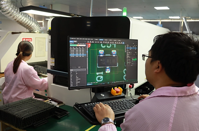

Checking with AOI Device
With the continuous increase in component packaging density and wiring complexity, dual-sided PCB assembly design has become a common solution for maximizing space utilization. This necessitates inspection equipment capable of comprehensively examining both the top and bottom surfaces of the circuit board, ensuring every stage of PCB assembly is monitored.
The core inspection principle of online dual-sided PCBA AOI equipment is typically based on integrating two independent high-precision optical imaging systems—one upper and one lower—within the device. As the printed circuit board moves through the equipment on an automated conveyor belt during the PCB assembly process, the upper and lower camera modules capture high-speed, high-resolution images of the board's top and bottom surfaces, respectively. This process can be synchronous or asynchronous to optimize inspection cycle times and avoid potential interference between the upper and lower light sources, thereby enhancing the efficiency of the PCB assembly line.
The acquired raw image data is then transmitted to a high-performance image processing unit. At this stage, deep learning algorithms such as Convolutional Neural Networks (CNNs) play a crucial role. By training on a massive number of labeled images of good PCB assembly units and various defect samples, CNNs can automatically extract and learn complex feature patterns that distinguish between good and defective products. During actual inspection, the system compares the real-time captured images with pre-trained models or benchmarks established from known-good boards to intelligently identify component-level defects (e.g., missing parts, incorrect parts, offsets, rotations, tombstones, reverse polarity, damage) and solder joint-level defects (e.g., excessive or insufficient solder, bridging, cold solders, solder balls, lifted leads, open circuits). These are all critical factors affecting PCB assembly quality.

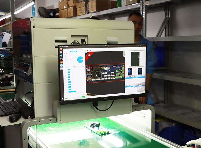

PCBA AOI Device Overview
