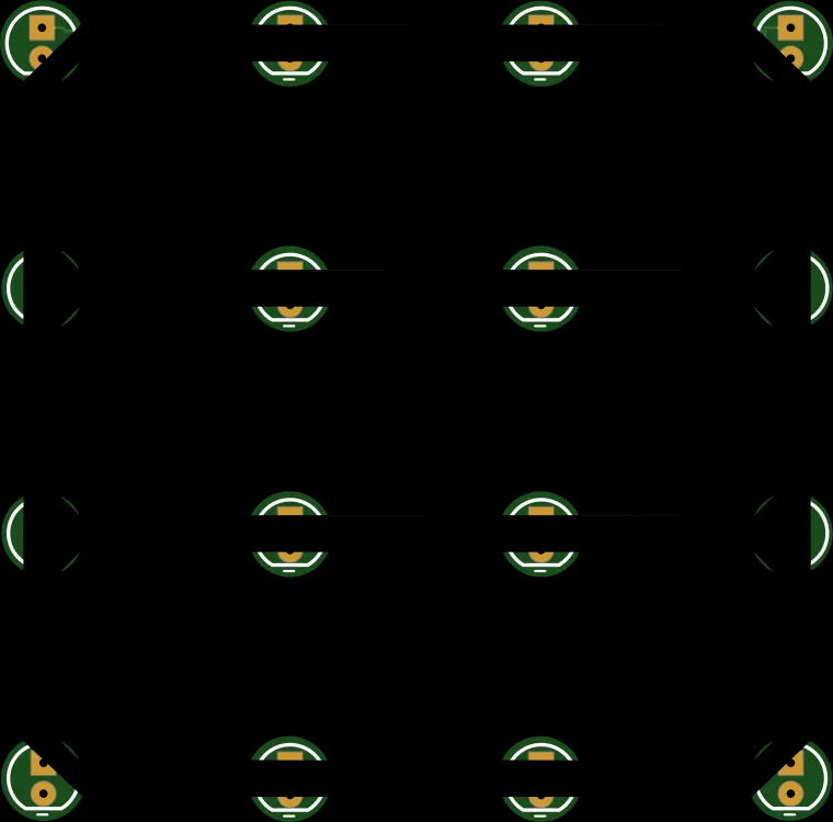

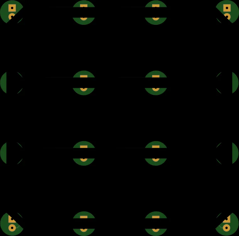

So, I designed two types of PCBs for this project.
One for the base and the other one that will be installed 4 times to create the top 4 layers of the cube. Both PCBs have "TOP" and "BOTTOM" written on them. The "Top" section faces up and the "Bottom" section faces down.
While assembling the cube, I will first solder the 16 copper wires to the "Top Section" of the base plate. Then I will solder the remaining 4 wires to the board. Each of these wires will connect to only one layer. Hence, all these wires are of different sizes. The 1st one from right connects to layer 1, next one to layer 2 and so on. Once all the wires are soldered to the "Top Section" of the base plate, I will one by one slide the LED meshes over these wires and solder them accordingly to form the top 4 layers.

So, this is what came in the mailbag. Thanks to PCBWay, the boards are very well fabricated and look absolutely amazing. The black color solder mask is adding to the beauty of the boards.
As discussed earlier we need 4 of the "LED Mesh Boards" and 1 board for the "Base".
One by one I added all the LEDs to the board. While soldering the LEDs, please make sure that they are all added to the "Top" side of the board. Once all the LEDs were in, I went ahead and soldered them to the board.

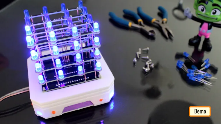

Final Demo
So, this is how my final setup looks like.
