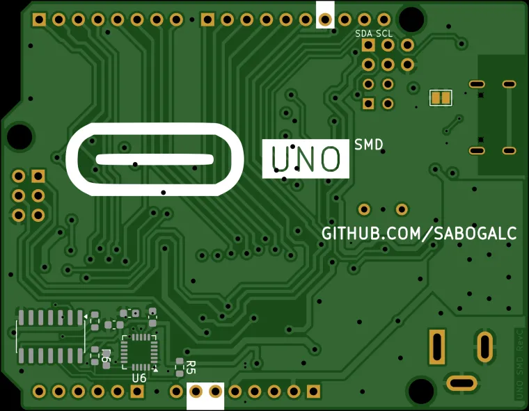

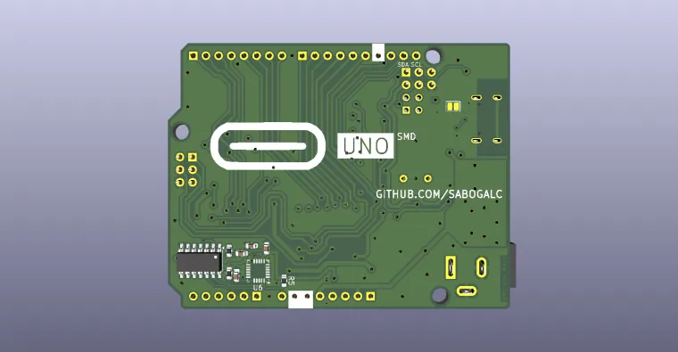

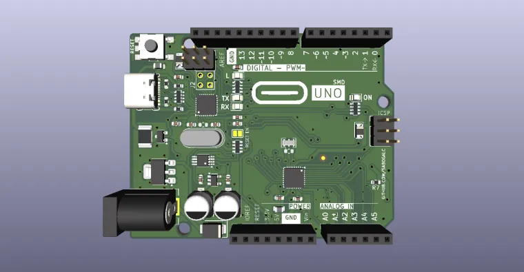

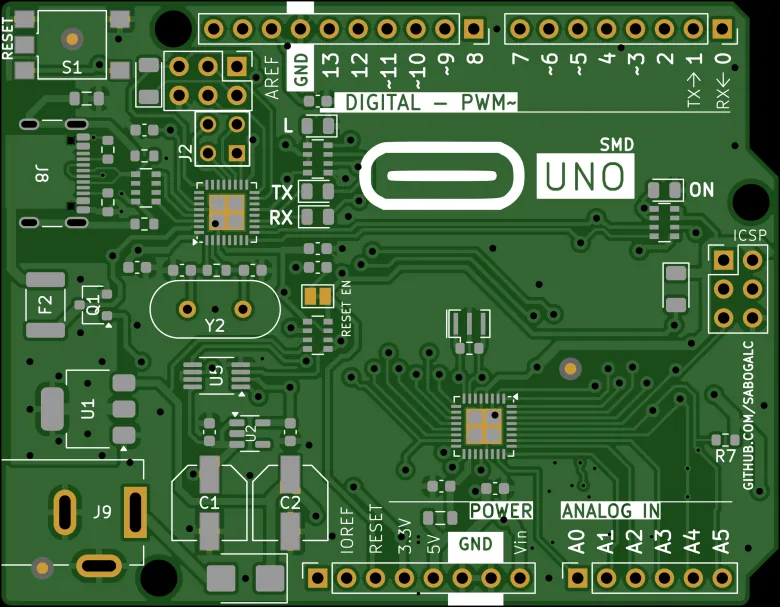

An Arduino Uno R3 SMD-Compatible Board With an Integrated MPU-6050
The Arduino Uno is fantastic for learning electronics and robotics, but motion sensing normally means connecting a separate IMU breakout board with jumper wires.
This project takes a different approach: an MPU-6050 is integrated directly onto an Arduino Uno-compatible PCB.
The result is an Arduino Uno platform with built-in 6-axis motion sensing.
What Is Added?
The board integrates:
  • MPU-6050 6-axis IMU
  • TXS0104ED bidirectional logic-level translator
  • 5 V I²C pull-ups
  • 3.3 V I²C pull-ups
  • IMU power decoupling
  • Supporting MPU-6050 circuitry
The MPU-6050 is located on the bottom side of the board.
