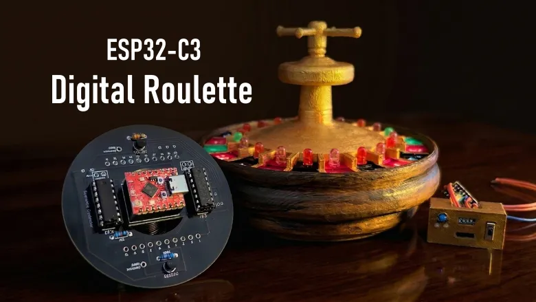

Hi everyone, today I am going to show you how I made a "Digital Roulette Wheel" by combining ESP32-C3 Super Mini Microcontroller with the classic CD4017 CMOS decade counters.
When the button is pressed, the ESP32 sends "clock pulses" to the CD4017 IC, causing the LEDs to cycle. Releasing the button triggers a realistic slowing down effect until it stops on a random result and reports the final position using the Serial Monitor or via Wi-Fi.

Circuit Diagram
The wiring of this project is really simple!
* Connect Pin-8 of the ESP32 to the Reset pin (Pin 15) of IC#1.
* Connect Pin-10 of the ESP32 to the Clock pin (Pin 14) of IC#1.
* Connect Pin-9 of the ESP32 to the push-button switch with a pull-up resistor.
* Connect Pin-0 of the ESP32 to the Wi-Fi Indicator LED with a current limiting resistor.
For the rest of the wiring, check out the circuit diagram on screen.
To make things even easier, I’ve designed a custom PCB for you.

Now, let’s begin assembling all the electronic components. First, take a moment to inspect the quality of the fabricated PCB. I’ve been using PCBWay for nearly six years now, and I absolutely love the final product they deliver.
Lets start by soldering all the resistances to the board followed by all the transistors.
Because I take extra care of my ICs and microcontrollers, I never solder them directly to the board. For ICs, I always use IC base and if a base is not available, I use female pin headers. This avoids direct soldering and makes replacement easy. One by one, I soldered all the components to the PCB.
To power the board, we need to integrate the charging module and some additional components. I began by installing the SPDT Switch followed by the blue Wi-Fi indicator LED. Then I super-glued the world smallest battery charging module to the block and secured it using this small white block. Finally I superglued the charging indicator as per the onscreen circuit diagram.
The remaining two holes accommodate the antenna and the push-button switch. Finally, once all components were in place, I glued the plastic block into the groove at the bottom of the base.
This is how the board looks like after I finished soldering all the wires that will connect to the LEDs. For LEDs 1 through 10, use Common GND2 and for LEDs 11 through 20, use Common GND1.
When soldering the LEDs to the board, be sure to solder them in the correct order to avoid mismatching the physical LED numbers with what the code sends to the server. Follow the onscreen instructions for the correct order. If you accidentally solder the LEDs incorrectly you can modify the array in the Arduino code to accommodate the change.
