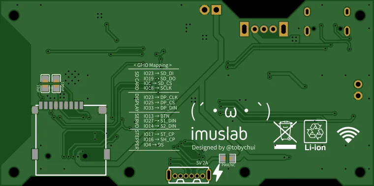

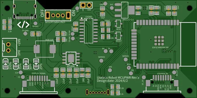

Firmware Flashing
To flash firmware into this robot, open the top cover and use the type C port with a </> label for programming. The type C port at the back is for powering (and charging, if you builds has battery installed).

Schematic and Layout
  • Schamtic
