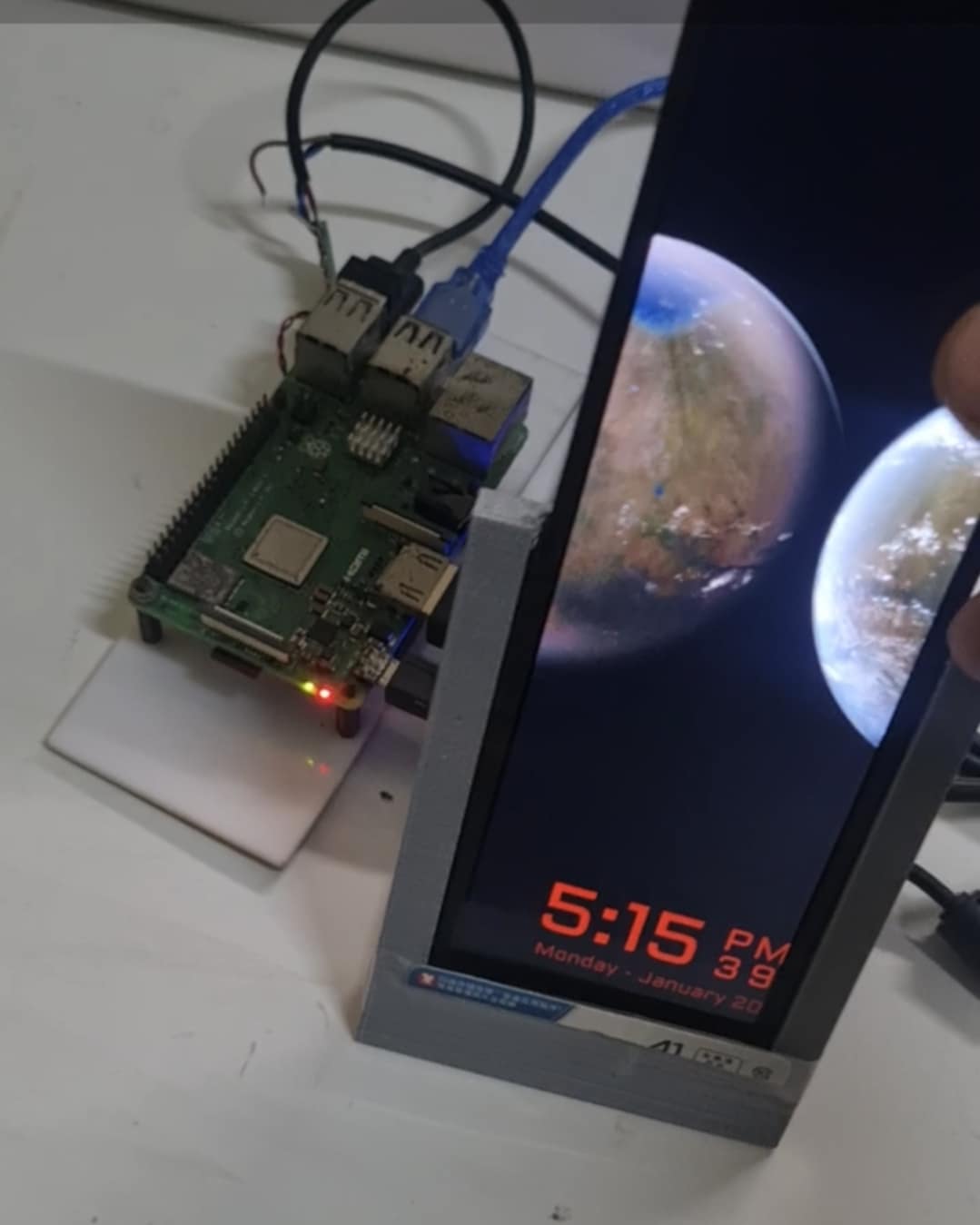

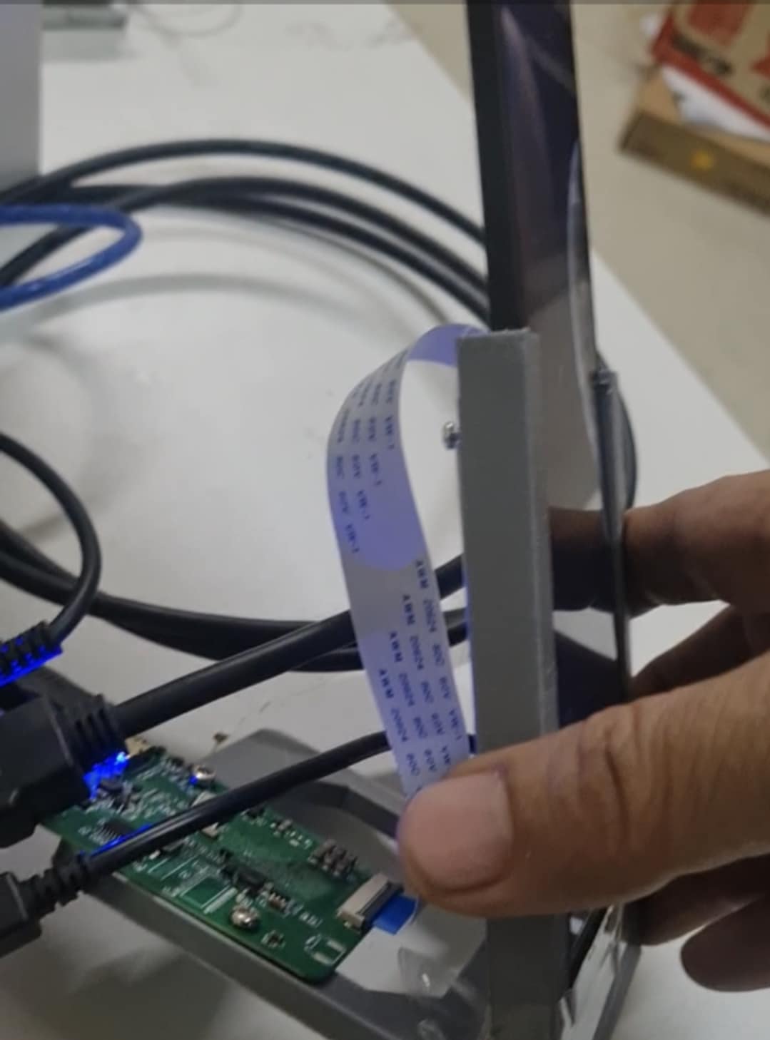

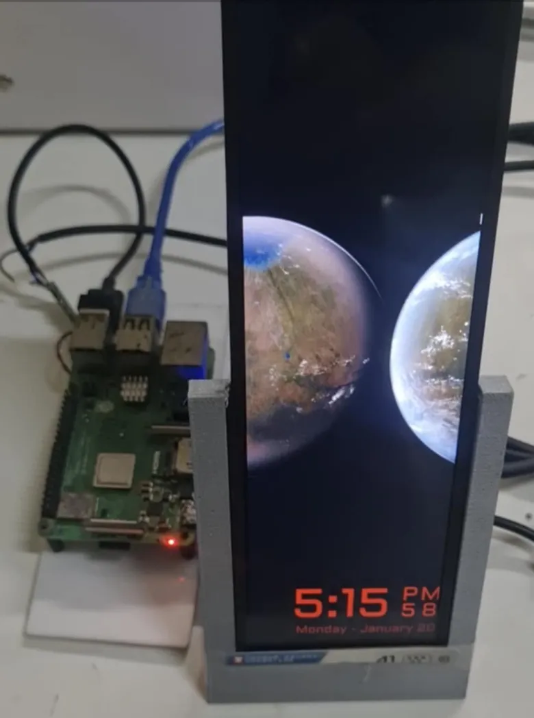

Pi Digital Clock 7.84" Display
The Pi Digital Clock 7.84" Display is a digital clock that uses a 7.84-inch display to show the time in a clear and easy-to-read digital format. By connecting to a Raspberry Pi, it can be easily used
        The Pi Digital Clock 7.84" Display is a sleek and modern digital clock featuring a 7.84-inch display for clear and easy-to-read time visualization. Designed for simplicity, it connects seamlessly with Raspberry Pi, providing reliable and efficient operation without the need for touch interaction. Perfect for desktops, wall mounting, or bedside use, it offers a straightforward and practical solution for timekeeping
ALL Command:
sudo apt update
sudo apt upgrade chromium-browser
chromium-browser --version
nano ~/.bashrc
if [ "$(tty)" == "/dev/tty1" ]; then
       DISPLAY=:0 chromium-browser --app=http://www.clocktab.com --start-fullscreen &
fi
