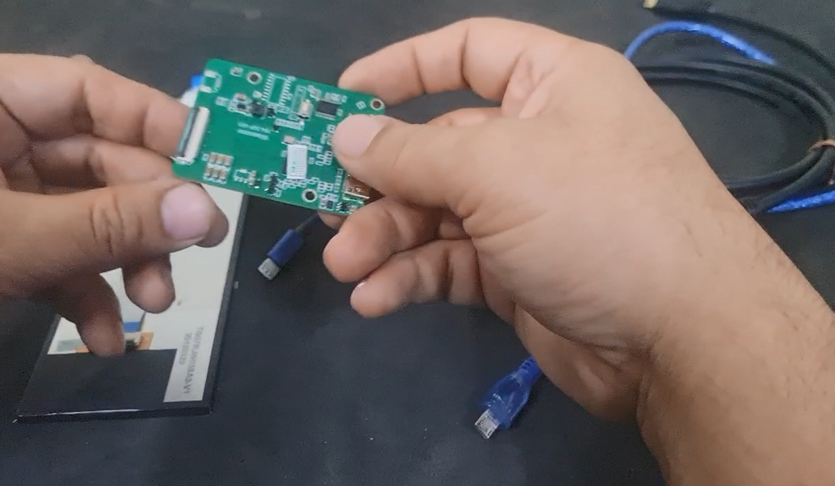

The inspiration for this project came from my habit of frequently
checking paper desk calendars. But every time I wanted to see the date or holidays, I had to manually flip through the pages. That got me thinking… why not combine a clock and a calendar into one screen?
A screen that can show the date and time automatically—no more flipping pages!
Then I thought, why not add some smart features too, like air quality info and a greeting system?
And that’s how Pi Digital Clock was born—a smarter, paper-free upgrade for your workspace!

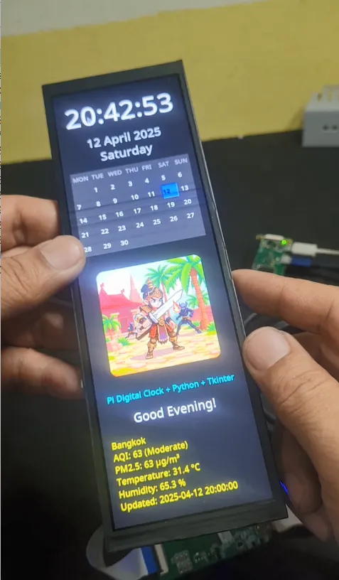

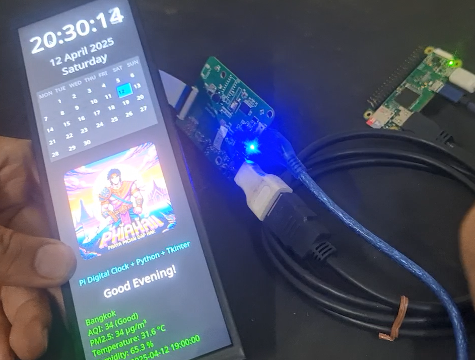

Key Features of This Project
- Displays a real-time digital clock
 -Includes a clear calendar showing day, month, year
-Greets with morning, noon, afternoon, evening messages based on time
 -Shows real-time PM2.5 / AQI values, fetched from Weather API
 -Photo Frame

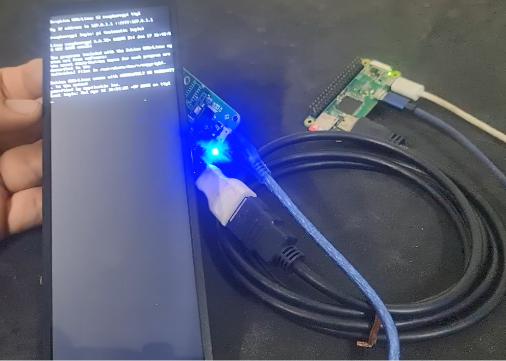

STEP 1:Setting up to run automatically on boot
      In this step, we will edit the ~/.bashrc file to add commands that automatically run Python scripts when the Raspberry Pi boots and enters the specified terminal (/dev/tty1). Using ~/.bashrc is suitable for executing commands in the user’s environment and can be configured to run only under specific conditions, such as when logging in through the first terminal.
 nano ~/.bashrc
if [ "$(tty)" == "/dev/tty1" ]; then
    DISPLAY=:0 python3 /home/pi/pidigi2.py &
fi
Press Ctrl+X to save and exit, then sudo reboot.
