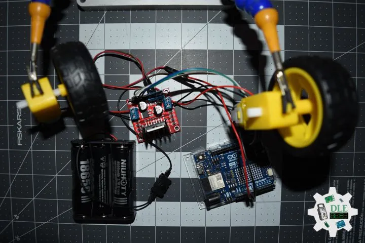

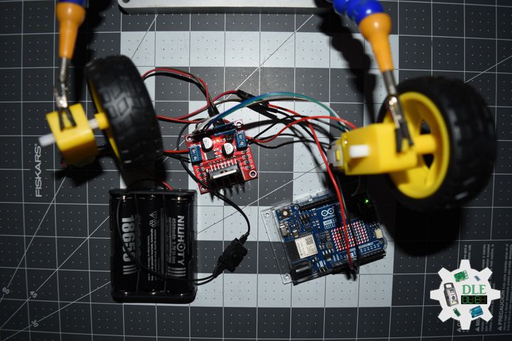

Project #12: Robotics - Arduino BLE - Mk37
Hardware Components
  • Arduino UNO R4 WiFi
    Arduino
    X 1
  • L298N DC Motor Driver Module
    X 1
  • Motor DC
    X 2
  • Power Switch
    X 1
  • 18650 Battery Holder (11 Volts)
    X 1
    X 3
  • USB 3.0 to Type-C Cable
    DFRobot
    X 1

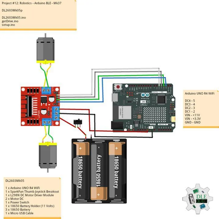

DL2603Mk05
1 x Arduino UNO R4 WiFi
1 x L298N DC Motor Driver Module
2 x Motor DC
1 x Power Switch
1 x 18650 Battery Holder (11 Volts)
3 x 18650 Battery
1 x USB 3.0 to Type-C Cable
DL2603Mk05p
DL2603Mk05p.ino
getDrive.ino
setup.ino
