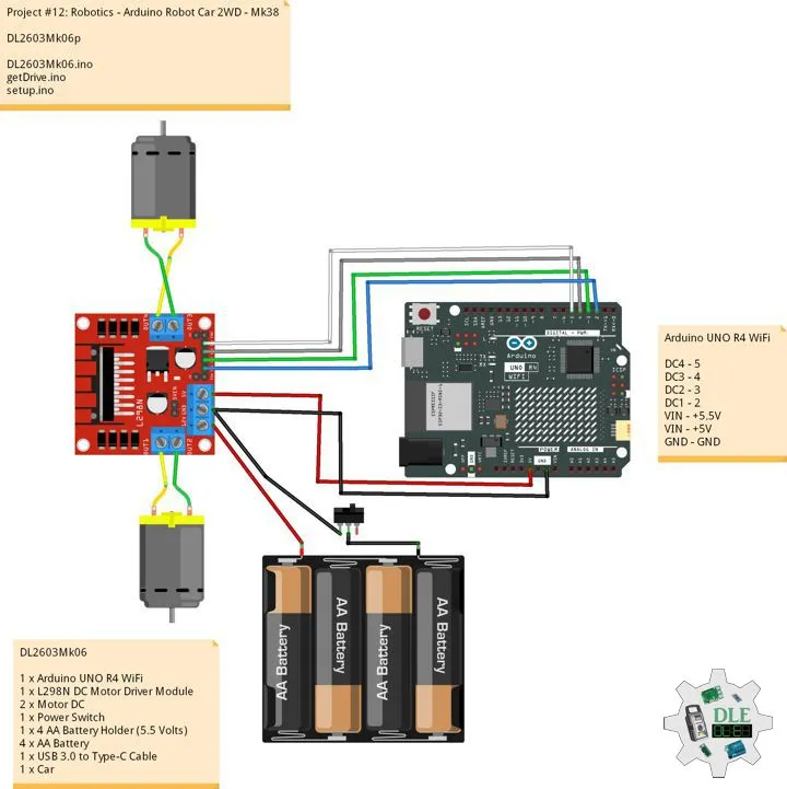

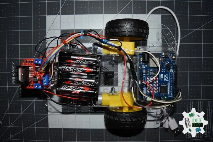

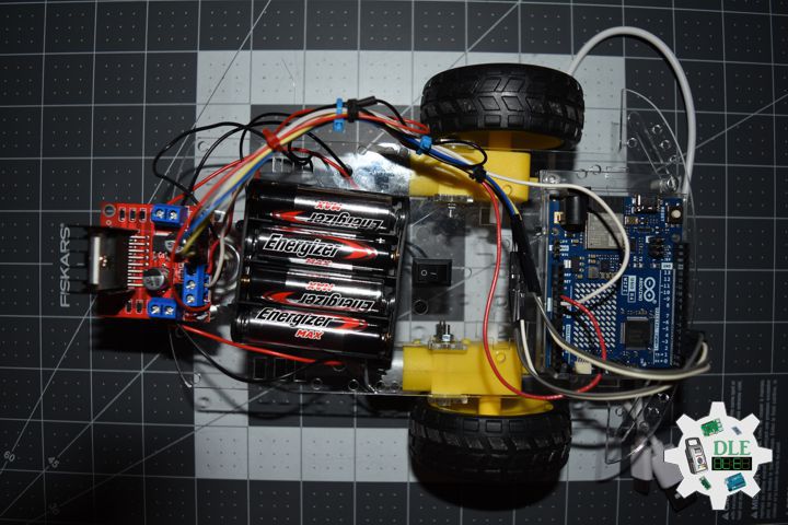

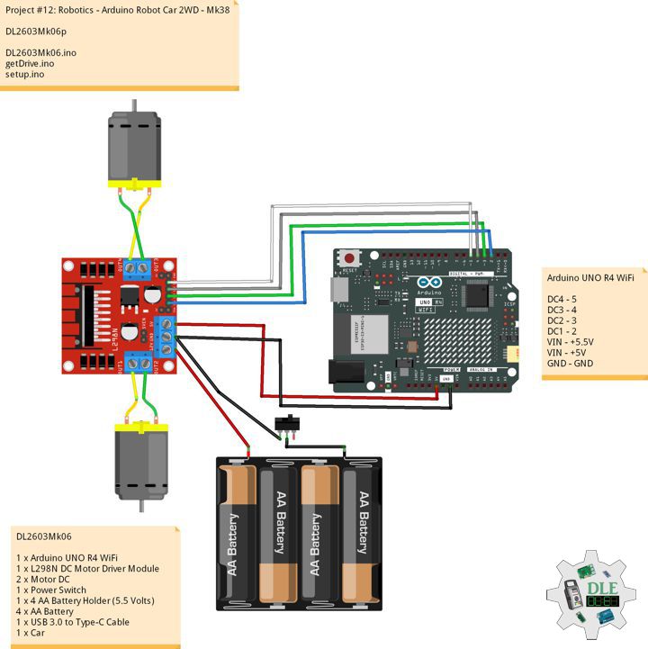

Arduino Robot Car 2WD
An Arduino Robot Car is a mobile robotic platform controlled by an Arduino microcontroller. The basic architecture consists of a chassis, DC motors for propulsion, a motor driver for controlling those motors, power supply, sensors for environment awareness, and the Arduino brain coordinating everything.
Two-wheel drive robots use two powered wheels at the rear with a ball caster or swivel wheel at the front for balance. This differential drive system allows precise turn in each wheel can rotate independently at different speeds or even in opposite directions, enabling the robot to spin in place. The simplicity means fewer motors to control, less current draw, and easier programming.
DL2603Mk06
1 x Arduino UNO R4 WiFi
1 x L298N DC Motor Driver Module
2 x Motor DC
1 x Power Switch
1 x 4 AA Battery Holder (5.5 Volts)
4 x AA Battery
1 x USB 3.0 to Type-C Cable
1 x Car
DL2603Mk06p
DL2603Mk06p.ino
getDrive.ino
setup.ino
