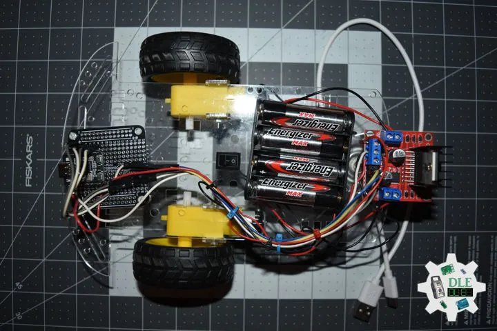

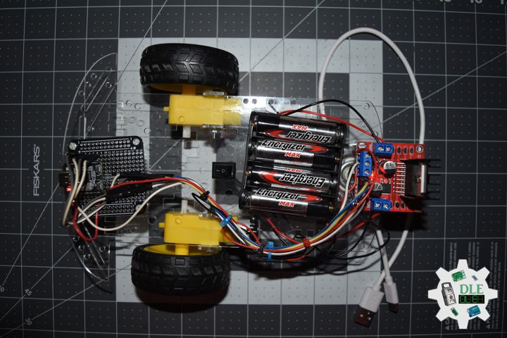

Project #12: Robotics - ESP32-C3 Mini - Mk39
Hardware Components
  • ESP32-C3 Mini
    Elecrow
    X 1 fenxiang
  • L298N DC Motor Driver Module
    X 1
  • Motor DC
    X 2
  • Power Switch
    X 1
  • 4 AA Battery Holder (5.5 Volts)
    X 1
  • AA Battery
    X 4
  • USB 3.0 to Type-C Cable
    DFRobot
    X 1

ESP32-C3 Mini
The ESP32 C3 Mini Development Board is a compact development board designed for the booming Internet of Things (IoT) application space. It is built on the ESP32 C3FN4/FH4 chip, an ultra-low-power system-on-chip (SoC) with a RISC-V 32-bit single-core processor. This powerful chip has a main frequency of up to 160MHz, coupled with 4M FLASH memory, ensuring strong performance in a variety of tasks.

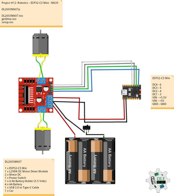

DL2603Mk07
1 x ESP32-C3 Mini
1 x L298N DC Motor Driver Module
2 x Motor DC
1 x Power Switch
1 x 4 AA Battery Holder (5.5 Volts)
4 x AA Battery
1 x USB 3.0 to Type-C Cable
1 x Car
DL2603Mk07p
DL2603Mk07p.ino
getDrive.ino
setup.ino

Schematic and Layout
