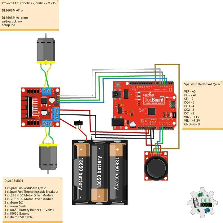

Thumb Joystick
The classic 'PS2-style' analog joystick. Features smooth dual-axis control (two 10k pots) and a satisfying integrated push-button click.
SparkFun Thumb Joystick Breakout
Stop struggling with weird pin spacing. This breakout board routes the Thumb Joystick connections to a standard 0.1" header for easy breadboarding.

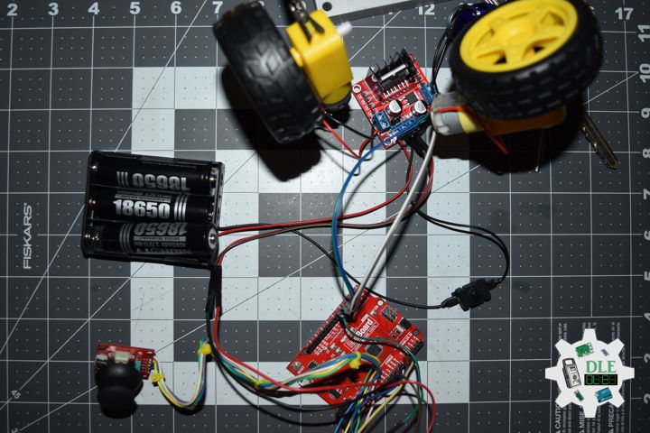

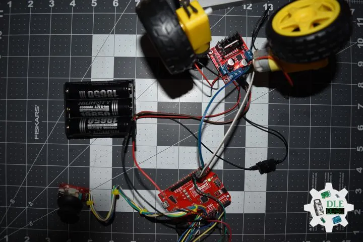

DL2603Mk01
1 x SparkFun RedBoard Qwiic
1 x Thumb Joystick
1 x SparkFun Thumb Joystick Breakout
1 x L298N DC Motor Driver Module
2 x Motor DC
1 x Power Switch
1 x 18650 Battery Holder (11 Volts)
3 x 18650 Battery
1 x Micro USB Cable
DL2603Mk01p
DL2603Mk01p.ino
getJoystick.ino
setup.ino
