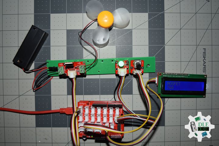

Crowtail - MOSFET
Crowtail - MOSFET enables you to control higher voltage project, say 50 Volt DC, with low voltage, say 5 Volt, on microcontroller. MOSFET is also a kind of switch. There are two screw terminals on the board. One for input power source and the other for device you want to control. Crowtail - MOSFET will pass the power from one end to another when closed. But if outer power source is absent, your device can still draw power from microcontroller via the Crowtail interface.
Crowtail - Mini Fan 2.0
This is a Crowtail mini fan with the mini motor driver which use the whole analog circuit.
DL2504Mk04
1 x Crowduino Uno - SD
1 x Crowtail - Base Shield
1 x Crowtail - I2C LCD
1 x Crowtail - MOSFET 2.0
1 x Crowtail - Mini Fan 2.0
1 x 2 AAA Battery Holder with On/Off Switch
1 x Crowtail - Rotary Angle Sensor 2.0
1 x Crowtail - LED(Green)
1 x USB Battery Pack
1 x USB Mini-B Cable

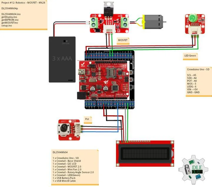

Crowduino Uno - SD
SCL - A5
SDA - A4
POT - A0
MOS - 5
LEDG - 6
VIN - +5V
GND - GND
DL2504Mk04p
DL2504Mk04.ino
getDisplay.ino
getEEPROM.ino
getMOSFET.ino
setup.ino
