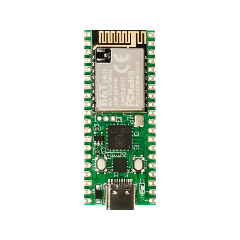

Let’s review and play with the Elecrow Pico W5.
The Elecrow Pico W5 is a microcontroller development board based on the RP2040 chip (the same chip used in Raspberry Pi Pico) with enhanced wireless capabilities. Key features include:
  • RP2040 microcontroller with dual-core Arm Cortex M0+ processor
  • Support for both 2.4GHz and 5GHz WiFi using the BW16 module from AiThinker
  • Bluetooth 5 connectivity
  • USB-C connector for power and programming
  • Compatible with MicroPython, C/C++, and other programming languages
Pros
  • The dual-band WiFi (2.4GHz and 5GHz) is a significant upgrade over the standard Raspberry Pi Pico W, which only supports 2.4GHz
  • RP2040 is a proven microcontroller with good community support
  • USB-C connection is more modern than micro-USB found on some other boards
Cons
  • As a third-party board, it may have less community support than official Raspberry Pi products
