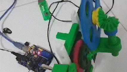

This project aims to facilitate the learning process of students studying mechanisms involving angular velocity relationships.
For this purpose, a test bench was designed capable of coupling different gears, which are controlled by an Arduino board. This allows students to establish different gear ratios and thus facilitates the calculation of both input and output speeds.

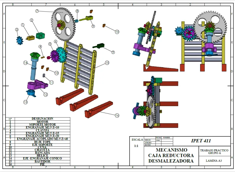

Technical drawing is of fundamental importance because it allows the design of the mechanism to be established.
