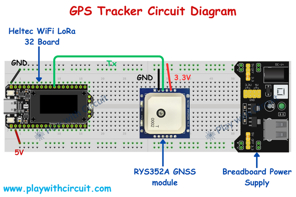

Circuit Diagram
Circuit Diagram
The hardware requires only a few connections, making it easy to assemble. The RYS352A GNSS module is powered from the 3.3 V supply, while its TX pin is connected to GPIO38, which acts as the UART receive pin on the Heltec board. The module continuously transmits standard NMEA sentences containing positioning information, which are decoded by the firmware.
A breadboard power supply module is used to regulate the 12 V battery voltage and provide a stable operating voltage for the circuit. The complete circuit diagram is shown below.

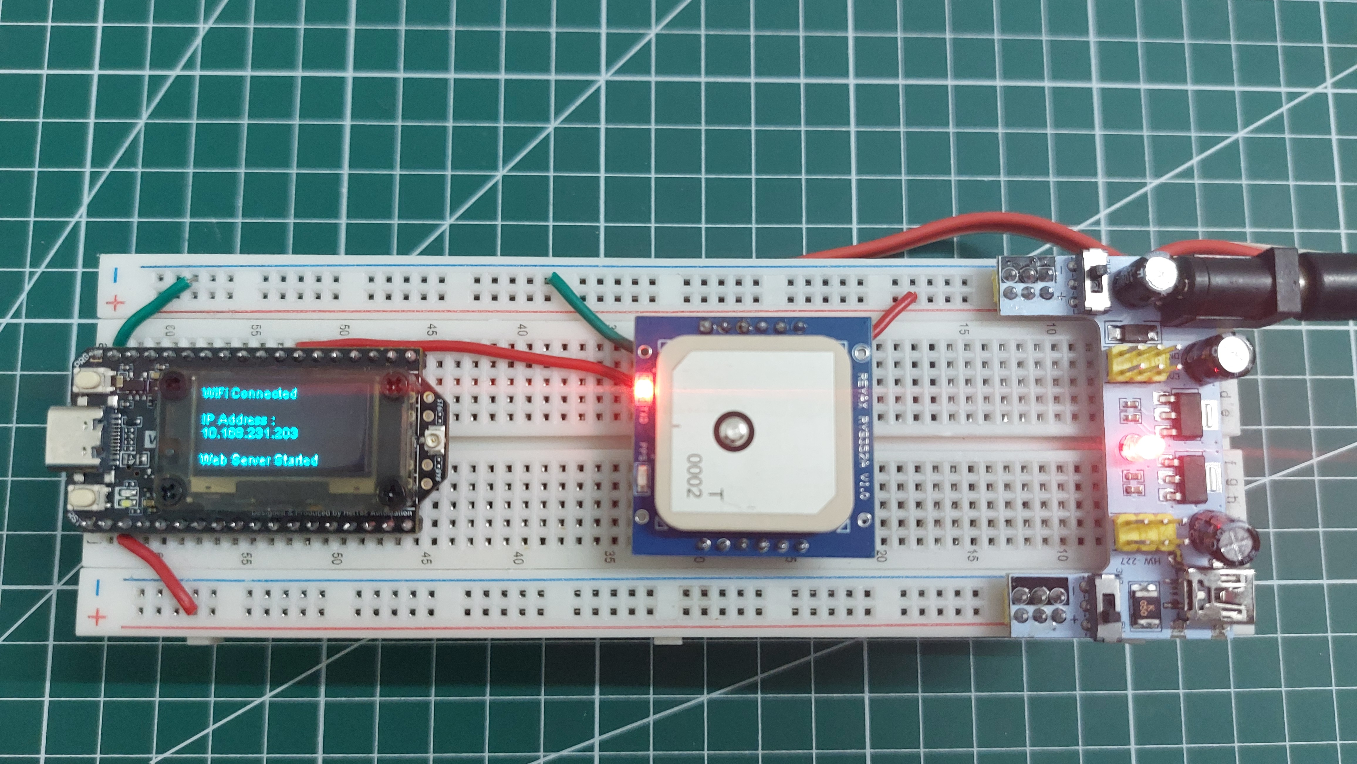

After uploading the firmware, I enabled the configured Wi-Fi hotspot and power on the hardware. Once the Heltec board connects to the network, the assigned IP address is displayed on the OLED display.

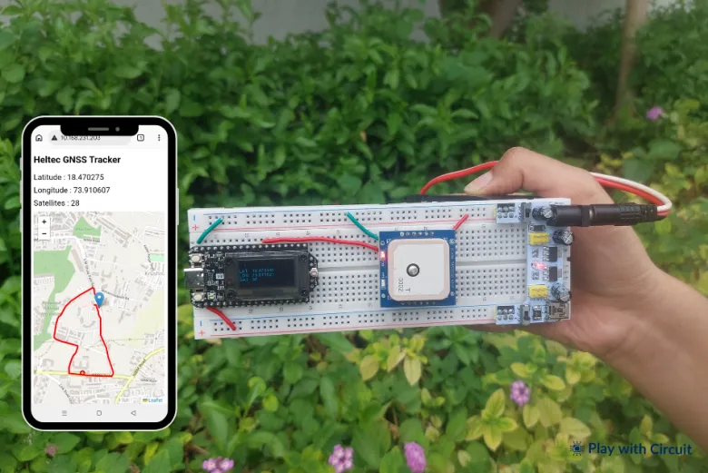

Then I took the GPS tracker outdoors, where the GNSS receiver has a clear view of the sky. After acquiring sufficient satellites, the OLED displays the current latitude, longitude, and satellite count. Then I entered the displayed IP address into a web browser connected to the same Wi-Fi network to access the tracking webpage.
To verify the system, I placed the tracker inside a moving vehicle and drive through different locations. During testing, the browser continuously updates the current position while drawing the travelled path on the OpenStreetMap interface, demonstrating real-time location tracking and browser-based visualization.
