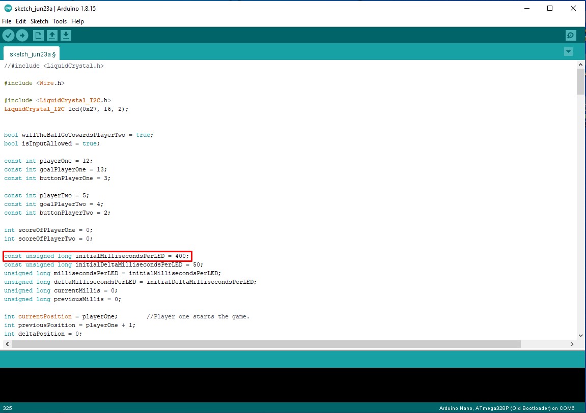

 - The starting speed of movement of the LEDs is set in the row:
const unsigned long initialMillisecondsPerLED = 400;
  The lower this number, the faster the movement speed
 - The degree of acceleration after each hit is adjusted in the rows:
 if (deltaMillisecondsPerLED > 50)
 deltaMillisecondsPerLED -= 50;
and the higher this number is, the higher the acceleration.

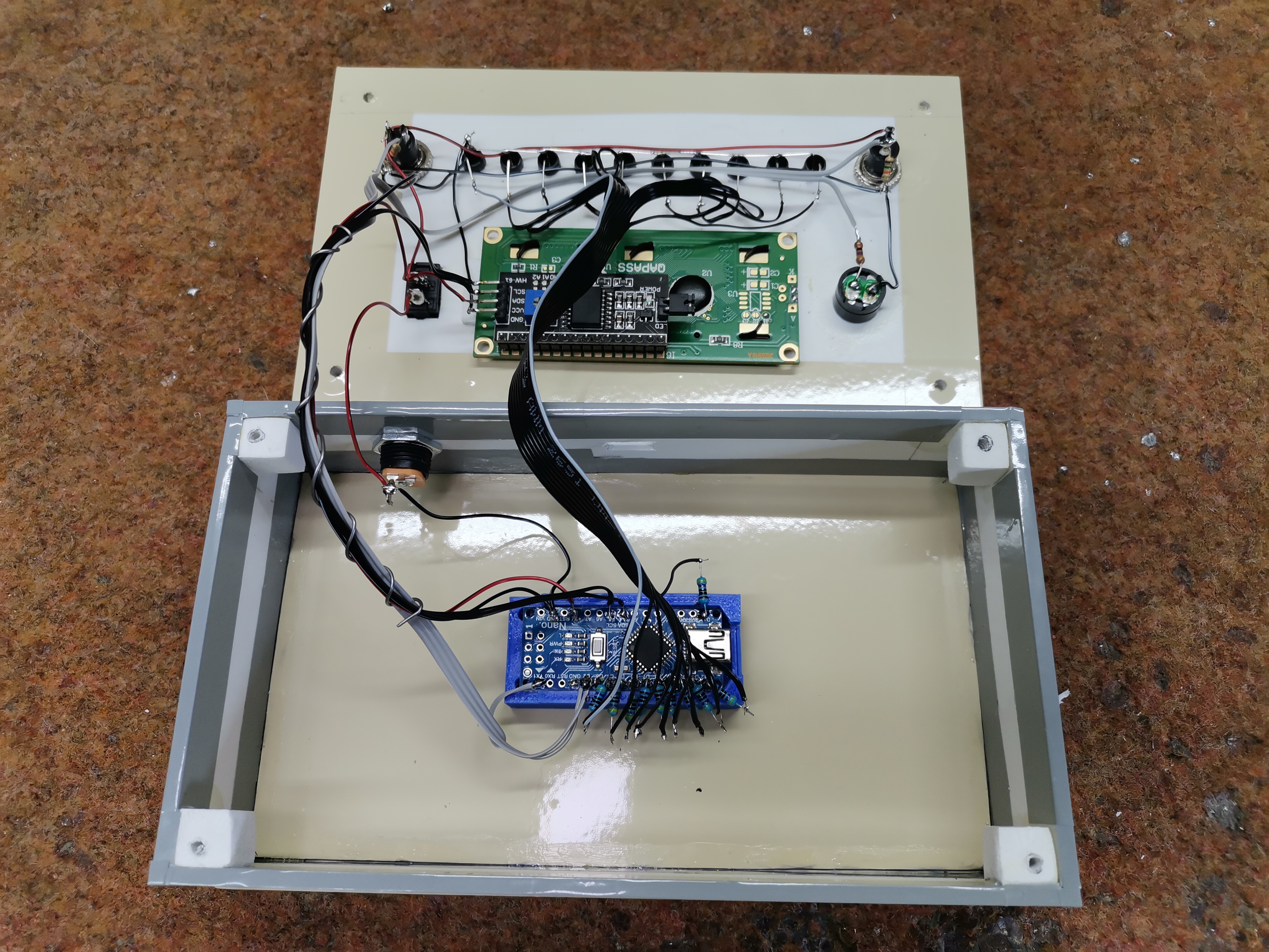

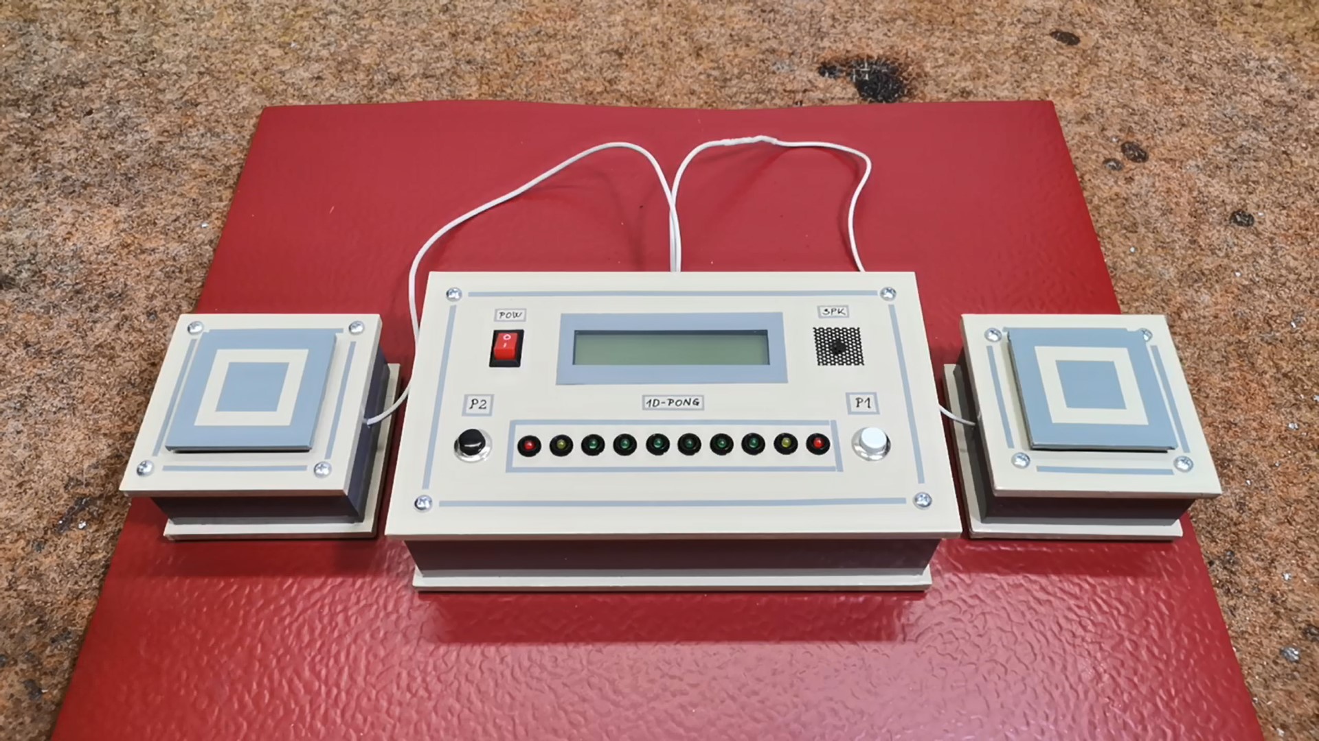

 The game can be played by one or two players. In the case of two players, which is a natural option, it is preferable to use robust external arcade buttons.
For this purpose I used these buttons that I made for the needs of one of my previous projects. They are large, and have a precise, and audible click.
   Finally a short conclusion. This is an interesting one-dimensional compact version of the classic "Pong" game made with a minimal number of components, yet extremely addictive, and can be played for hours before you get bored. The device is mounted in a suitable box made of PVC board and lined with self-adhesive wallpaper. For power, it is preferable to use a lithium battery for the sake of mobility
