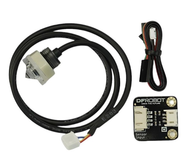

 Recently I had an unpleasant experience in my home, specifically my ground floor was flooded as a result of a burst water pipe, and at that moment I was absent. So I decided to develop a warning system for such phenomena that would also take some action in order to prevent greater damage from occurring. For this purpose, I purchased the Gravity: Photoelectric High Accuracy Liquid Level Sensor for Arduino from DFRobot which has good sensitivity and no need for mechanical parts and is also corrosion resistant and can handle high temperature and high pressure.
The way this photoelectric sensor works is as follows:
 - When the detected level is in air, due to reflect of the prism, most of light will enter receiver LED, optical level sensor will output high voltage.
- When the detected level is in water, due to refraction of the liquid, just less of light enter receiver LED, optical level sensor will output low voltage.
 The level of the output voltage from this sensor is the same as the power supply, and since it can be powered by 3V3, I can connect it directly to the ESP32 Input. It can be mechanically installed in any direction, and specifically for this demonstration I made a small stand on which the sensor is mounted. The tip of the sensor should be just above the floor to detect even the slightest accumulation of water. As I mentioned earlier, I plan to use an ESP32 microcontroller for several reasons. It is cheap, has low power consumption, supports Wi-Fi and Bluetooth, and has other advantages over most Arduino boards.

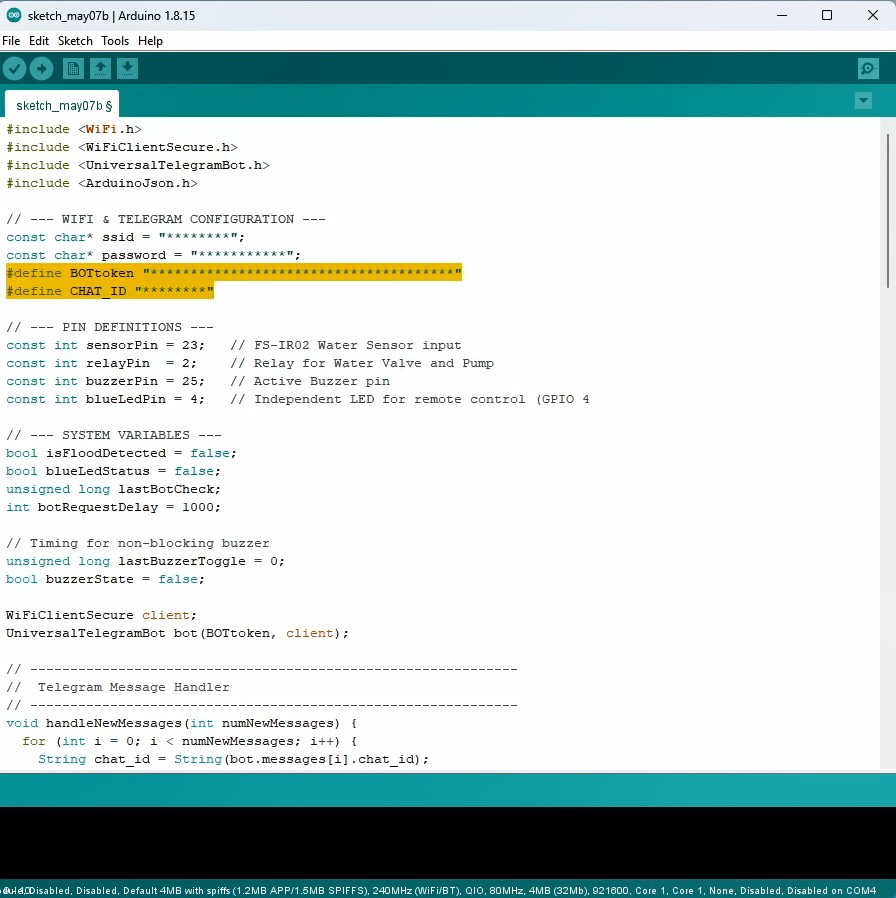

    It is important that when creating a telegram bot we get two distinct unique strings of characters, one is the HTTP API Token, and the other is the ID. We need this information later when creating the ESP32 code. Having already mentioned the code, I should say that it is designed in a way that can be easily changed several parameters, including the warning text that we receive on the smartphone.

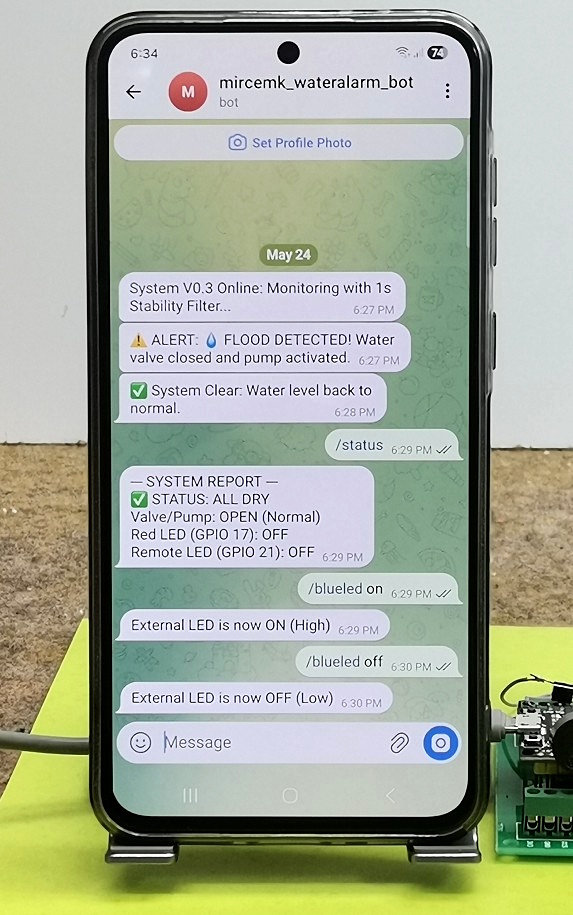

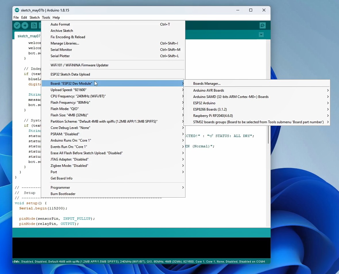

At first, the credentials from the local Wi-Fi network should be entered, and then the received Telegram Token and ID. Next is the definition of the pins that we use on the ESP32, and then the corresponding messages that we receive on the smartphone depending on the state. As I mentioned earlier, these messages can be changed according to our own wishes without any other changes to the code. It is also very important to mention that with this telegram bot we have the possibility of two-way communication, which means that in addition to receiving messages, we can also give commands via the smartphone to perform some tasks remotely. To install the code without errors, we need to select "ESP32 DEV Board" in the board manager and install the provided libraries UniversalTelegramBot-1.3.0 and ArduinoJson 6.21.6

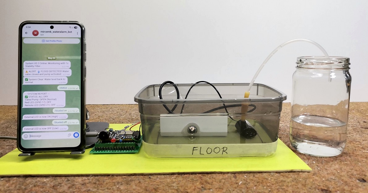

 The following is a demonstration of the functionality of the system in real conditions. For this purpose, I will use a container in which I will simulate a flood and a miniature water pump to drain the water. First, I will bring power to the ESP32 via the USB port. After a few seconds, we receive a message on the smartphone that the system is active. Now let's check the status in the room where the system is installed. For this purpose, we write the command: /status. Soon we receive a system report that describes the state in detail, in this case a dry room, the valve is open, and the blue and red LEDs are OFF. These messages arrive at the smartphone via the mobile network, which means we will receive them anywhere in the world .
 In a real situation, sensor and pump would be located below floor level in a specially designed space for that purpose.
