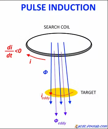

 Pulse Induction (PI) metal detector operates on a principle based on sending short pulses of electrical current through a coil to create a magnetic field. This pulse lasts for a very short period, usually microseconds. When the pulse is transmitted, the magnetic field spreads outward from the coil. If there is a metal object near the coil, it disrupts this magnetic field. The coil then detects the change in the magnetic field caused by the metal object, and that results in a reflected pulse which is different from the normal pulse.
This difference is processed and emitted in the form of a sound or short beeps, with a frequency that changes depending on the distance and dimensions of the detected metal object. In several of my previous videos, I presented ways to make such a metal detector, including one very similar, with an Arduino Nano microcontroller. This time the device uses a more powerful ESP32 microcontroller board that also contains built-in Bluetooth, so now the construction is even simpler.

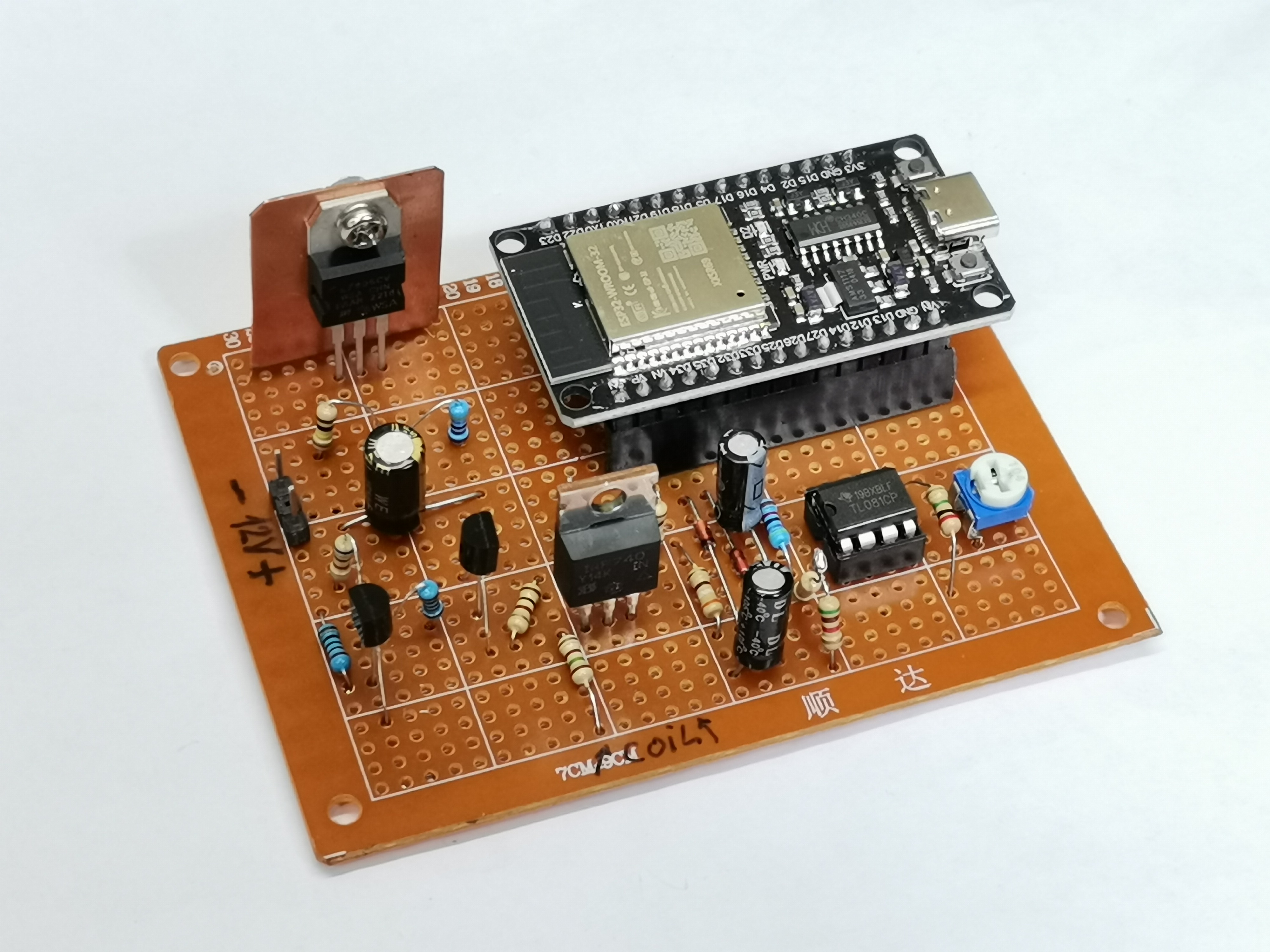

  The input circuit is almost identical in all PI metal detectors and consists of the following components:
- A search coil consisting of 20 turns of insulated copper wire with a cross section of 0.4mm^2 , in the form of a circle with a diameter of 20cm.
- An operational amplifier IC, I specifically use the TL081, but the circuit worked almost identically with OP07, LM741, and CA3130 IC's.
- A power MOSFET with one or two driver transistors. In this case IRF740 , BC547 and BC557 but approximate replacements can be used
- A 7805 voltage stabilizer to power the microcontroller
- And several resistors, capacitors, and diodes.
To power the metal detector I use three lithium batteries connected in series, which is approximately 12V. The maximum total consumption is about 150mA.

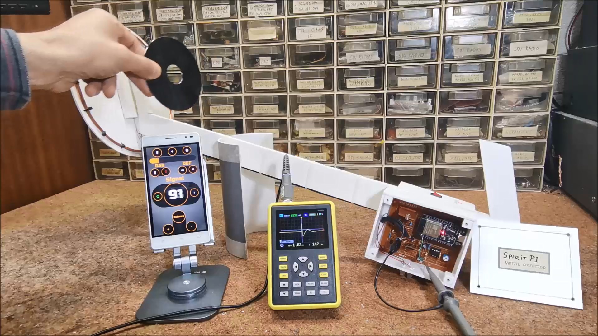

 After this, the Android application will work normally and we can start testing. First, let me explain how the application works. After the first start, we go to setup and select the metal detector version Spirit PI. Then we go to Bluetooth settings and select ESP32-Spirit PI-2 and go back.
Now I press the refresh button and from this moment the device is ready to work. The interesting fact is that we can very easily change the values ​​for the generated frequency and duty cycle, obtaining different performances depending on whether we want to detect massive or small metal objects.
  Next, let's use an oscilloscope to trace the shape and changes of the signal that we bring to the input of the microcontroller for further analysis.
Here's how it should look at the beginning, and now by bringing a metal object closer to the search coil, the amplitude and duty cycle of the signal change.
This change is detected by the microcontroller and transmitted via Bluetooth to the smartphone, which then gives an audio and visual notification.
  Now let's see how the detector reacts in approximately realistic conditions in the air, keeping in mind that the detection distance is significantly reduced on the ground.
  As for the performance of this metal detector, you can notice that they are almost identical to those of the previously presented metal detector with Arduino Nano, taking into account that they largely depend on the Android application, which in both cases is practically the same.
