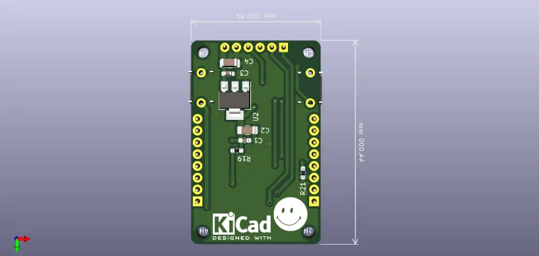

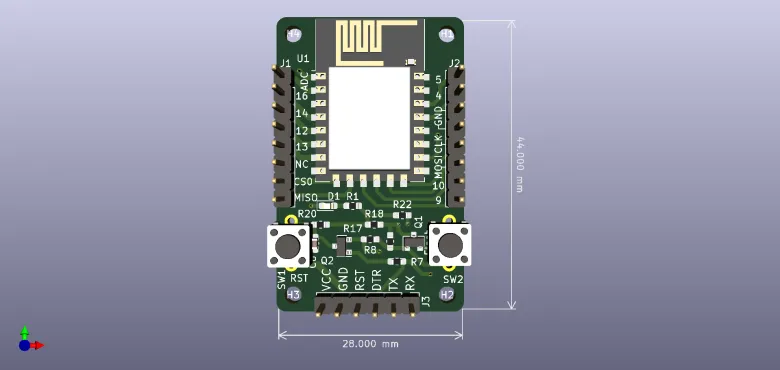

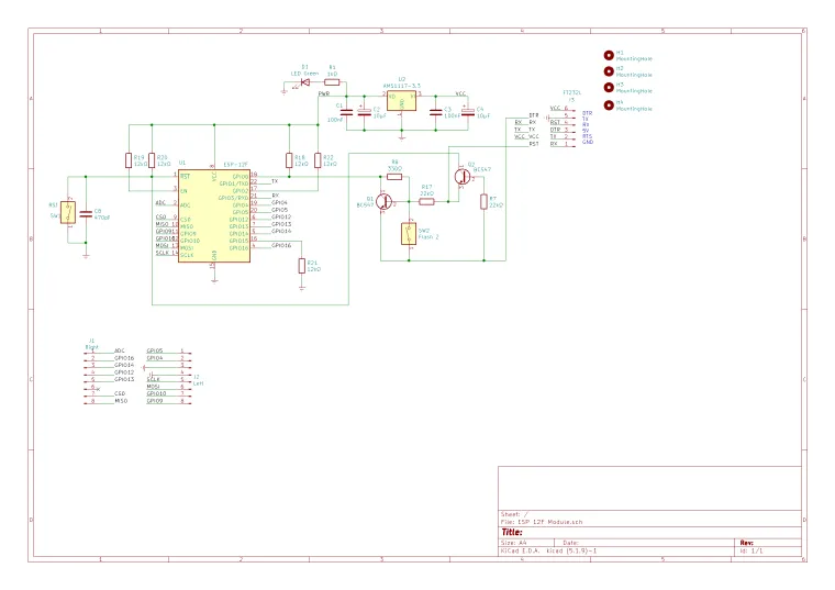

Hello makers!
Some time ago I had a shopping coupon and I thought about making some simple PCBs with ESP12F, simple means without too many features, and that once programmed they will stay that way, that I will introduce them into various hobby projects. The result was a PCB in 2 layers, 28mm*44mm. As a programming method would be to use a FTDI232 adapter, very well known. In the end I did not buy those parts, I chose something else. You have the circuit and the list of components available.
Download or buy if you need it.
Have fun with it! ????????

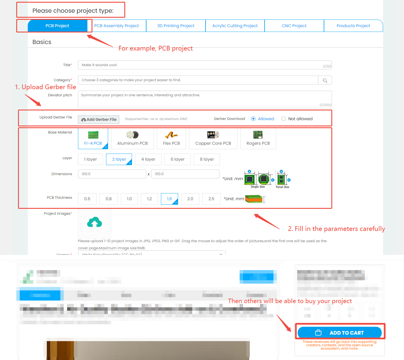

  • Hi cris,You have a lot of cool projects! Would you like to try to allow other members to buy your projects and get commissions? :)
    Jun 24,2025 0 comments
    Reply
  • How? : When you create a project, fill in your project parameters carefully. Then your project will be able to be 'Add to cart' by others.
    Jun 24,2025 1 comments
    • cris 2025-06-28 19:44:47
      Reply@Doreen Tn
      Here's something to improve, I saw this reply of yours completely by chance, at least I don't notice this in the notification system (which is also a bit weak, I would like to access all notifications in a new page, instead of scrolling through them all). When it comes to a comment, the most appropriate method is for it to arrive in my email, I can notice it faster. Then, it's a website problem, I uploaded the project for the PCB Design contest, I don't have the option to upload gerber, I've encountered this situation before. Almost all of my projects are for manual assembly, plus I use a lot of components recovered from scrap boards, I very rarely buy parts. I've tried a couple of times to place assembly orders with other manufacturers, but there were always bugs related to technology/machinery. But, after you solve the problem with adding gerber files, I'll check what settings are necessary for Elecrow (I use KiCAD and I see that you have a detailed
