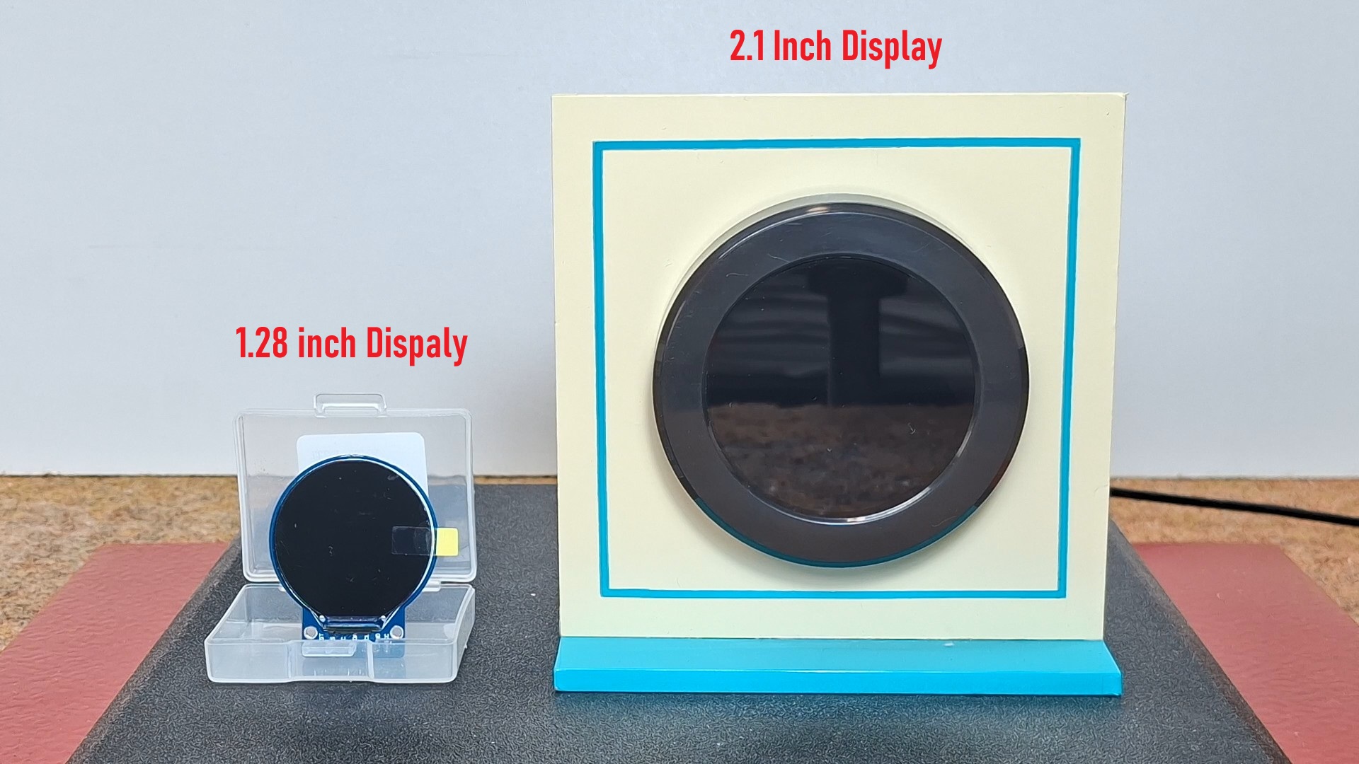

  Recently on the Hackaday portal I came across a very interesting project called Moon Display by author Julian Scheffers. Namely, on a small 1.28 inch (GC9A01) TFT Display very precisely displays moon phase, libration, axial tilt calculation and parallax correction based on the observer's geographic position. This requires very complex calculations that are performed locally on the device, i.e. a microcontroller.
   As you can see in several of my previous projects, I own a CrowPanel 2.1inch-HMI ESP32 Rotary Display which seemed ideal for this purpose considering that it offers almost twice the display resolution, a powerful ESP32-S3 microcontroller, built-in WiFi connectivity, as well as a push button and rotary encoder that could be utilized for additional functionality.
 The original project uses the Adafruit_GFX graphics library. One of the main challenges of this port was adapting the software to the significantly different hardware architecture of the CrowPanel display. For this reason, the graphics subsystem was completely reworked and migrated to the Arduino_GFX library, which provides native support for the RGB display interface used by the CrowPanel.
Detailed video description at: https://youtu.be/yv4hqoOiPhg
 When turned on, the display shows a message about connecting to the local Wi-Fi network, and then a beautiful image of the current state of the moon for the given coordinates appears.
So, the major improvement was the visual representation of the Moon itself. The original project uses a relatively low-resolution texture suitable for a 240×240 display. Taking advantage of the larger 480×480 display, I implemented a much more detailed lunar surface texture, resulting in a significantly sharper and more realistic appearance. The higher resolution allows fine surface details and craters to be displayed with much greater clarity, making the device look more like a decorative astronomical instrument than a simple electronic project.
