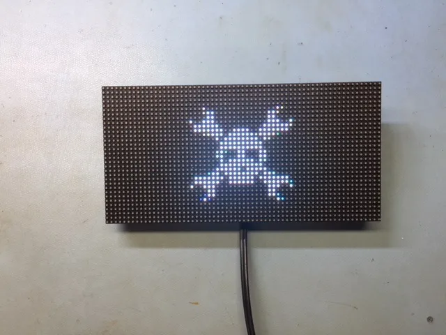

Version of the ESP8266 RGB Matrix that is one single board for the 64x32 display.
Hackaday
2
This version of the ESP8266 RGB Matrix that consists one single board that plugs into the back of a 64x32 display. My first version used a NodeMCU along with way too many jumper wires. This version is just one board not using using any wires or cables at all.
Check out http://www.instructables.com/id/RGB-LED-Matrix-With-an-ESP8266/ for all the details like wire diagram and Arduino library.
Check out the Files under the PCB directory for a parts list, schematic and gerber files to make your own. More Code on GitHub: https://github.com/mike-rankin/ESP8266_RGB_Matrix_Cable_Free_Version. This is GitHub account: https://github.com/mike-rankin where you will explore more excellent projects. He is a good DIY maker who designs custom ESP32 IoT projects using Altium Designer, Arduino IDE and Fusion360. Welcome everyone to follow.
