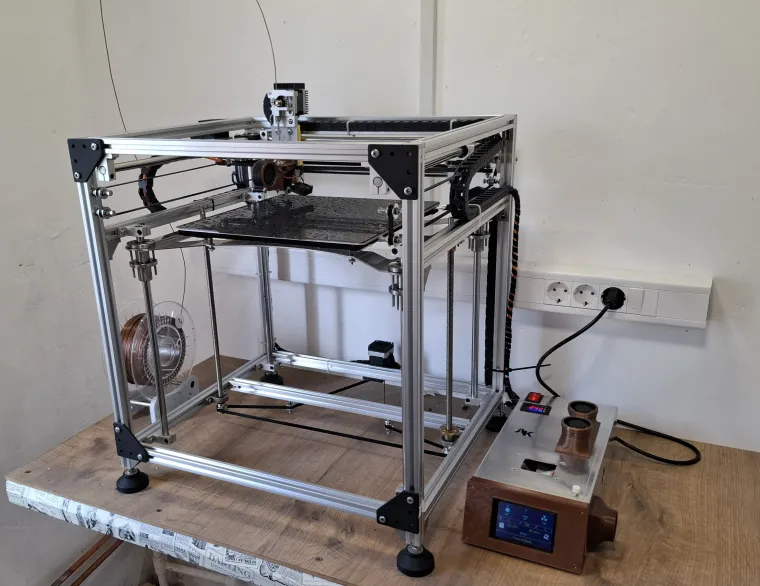

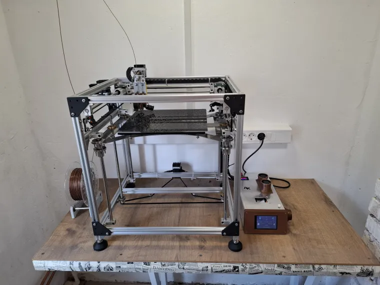

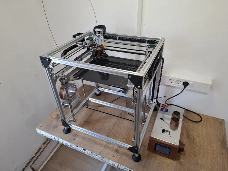

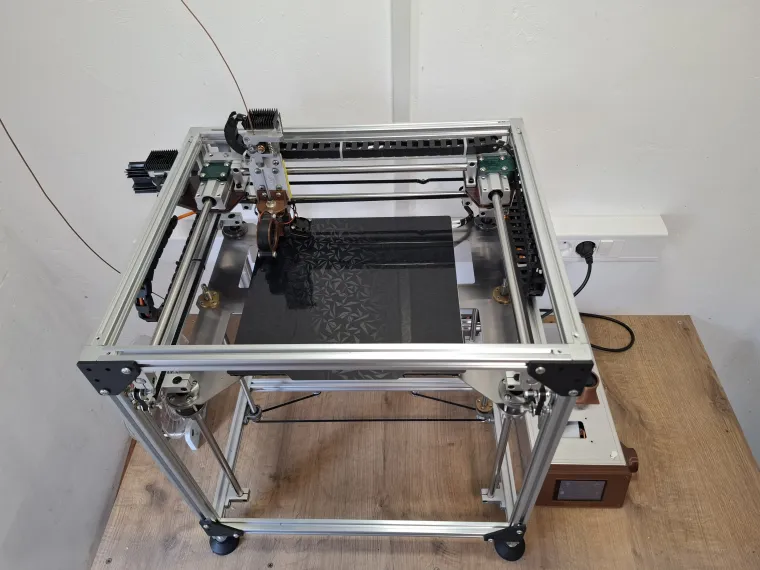

Flutur i5
Open-source 3D printer project with CAD models and build documentation.
Flutur i5

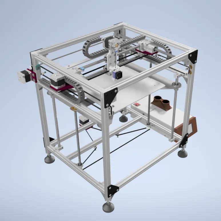

Flutur i5 is an open-source 3D printer project, created by an enthusiast for the wider maker community. It is designed to inspire and support fellow makers and DIY lovers. The idea behind Flutur is to build a stable, reliable and flexibile 3D printer that is affordable, easy to assemble, operate and modify.
This is a 3D printer featuring a Cartesian-style positioning system, driven by three two-phase stepper motors: belt-driven on the X and Y axes, and lead screw-driven on the Z axis; all guided by linear bearings on Ø12 stainless steel rods. The entire system is assembled into a rigid rectangular (box-type) aluminum frame, made of 20 x 20 mm slot profile members. The printable volume is 285 × 300 × 300 mm (X × Y × Z).
For more detail, please follow the official GitHub repository.
