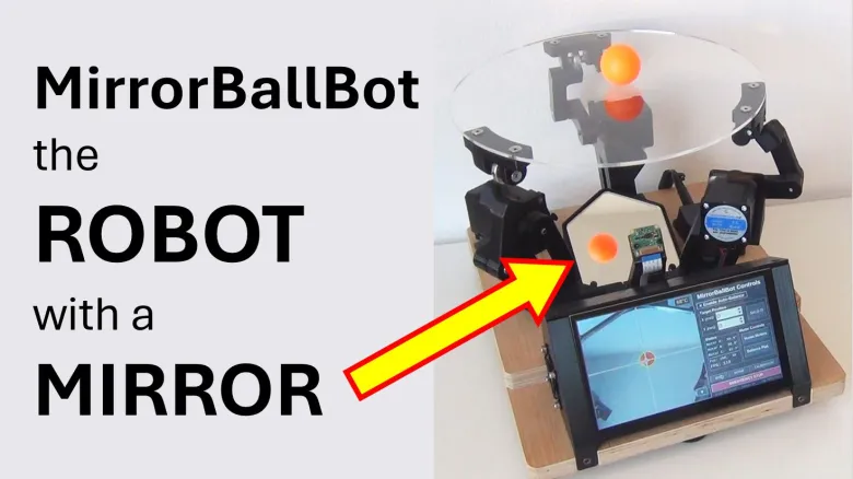

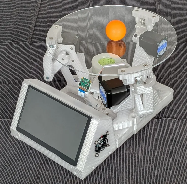

The robot balances a ball on a translucent platform and can also move the ball along predefined trajectories.
It detects the ball’s position using computer vision and a mirror that increases the Field of View (FoV). This trick makes it possible to use a larger platform while keeping the robot compact.
The robot uses an ELECROW 7-inch touchscreen, which is essentially a key enabler for the Finger Follower feature: the ball follows the movement of a finger on the touchscreen in real time. As a result, the platform moves the ball so that it appears on the screen to follow the finger—another innovative feature of this project.
The system is based on Raspberry Pi components: a Raspberry Pi 4B+ as the main controller, a Pi Camera V3 Wide, and three RP2040-Zero boards controlling three TMC2209 silent stepper drivers.
The Raspberry Pi 4B+ communicates with the three RP2040-Zero boards via a custom I²C protocol.
The system processes more than 110 FPS and controls the platform at 17–25 Hz.
The GUI also provides access to several calibration parameters, including the PID gains, which can be adjusted in real time. This makes the tuning process much more user-friendly and educational.
To minimize wiring and reduce the possibility of connection errors, the robot uses a custom PCB designed to fit directly onto the Raspberry Pi as a HAT. The board essentially acts as a hub, connecting all the other boards together.
The robot is available in two versions: one with a wooden base and one that is fully 3D-printable.
