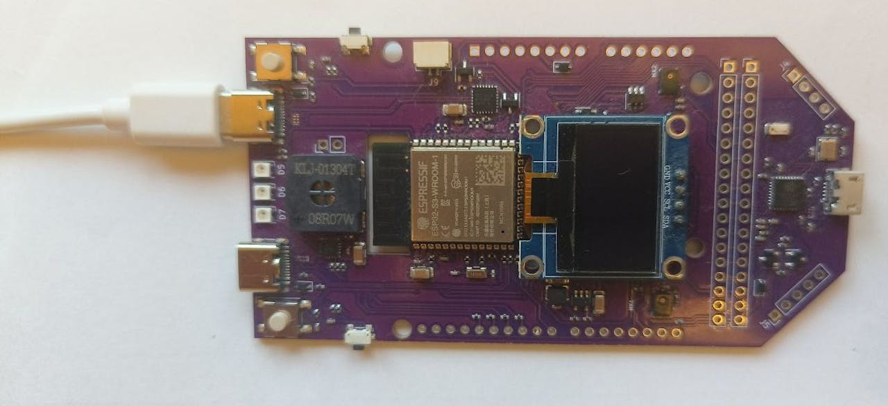

This is true custom voice AI running on an ESP32-S3:
  • Works 100% offline, no Wi-Fi or cloud required.
  • Supports English and Chinese with instant language switching.
  • Lets you, not the manufacturer, decide what the robot understands.
Whether you’re a student learning robotics, a teacher running classroom challenges, or a hobbyist building your own voice-controlled machine, RoboControl gives you the freedom to make robots respond to your imagination.

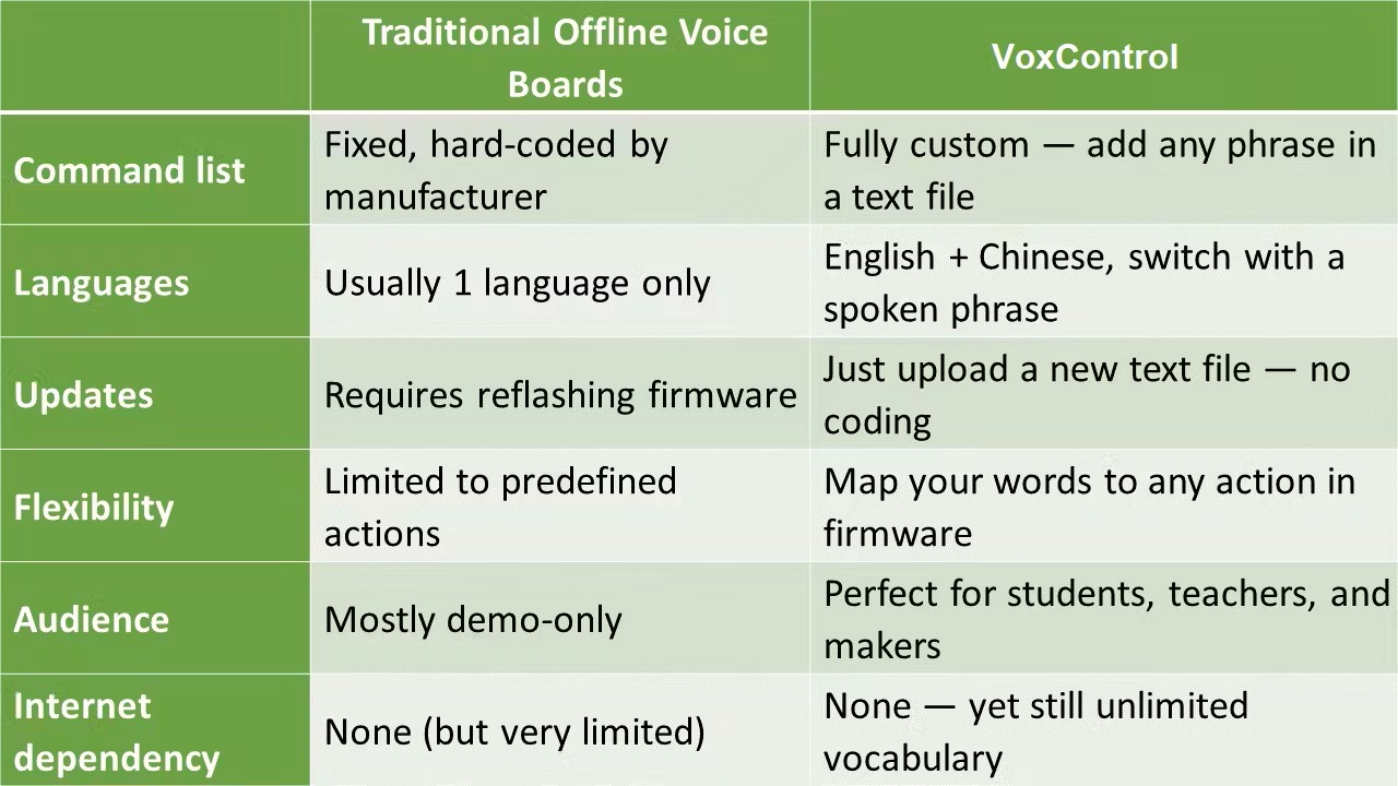

Before / After: Why VoxControl is Different
