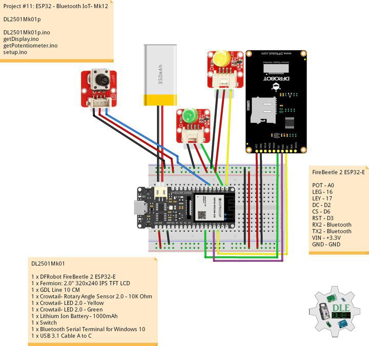

DL2501Mk01
1 x DFRobot FireBeetle 2 ESP32-E
1 x Fermion: 2.0" 320x240 IPS TFT LCD
1 x GDL Line 10 CM
1 x Crowtail- Rotary Angle Sensor 2.0 - 10K Ohm
1 x Crowtail- LED 2.0 - Yellow
1 x Crowtail- LED 2.0 - Green
1 x Switch
1 x Bluetooth Serial Terminal for Windows 10
1 x USB 3.1 Cable A to C
POT - A0
LEG - 16
LEY - 17
DC - D2
CS - D6
RST - D3
RX2 - Bluetooth
TX2 - Bluetooth
VIN - +3.3V
GND - GND
DL2501Mk01p
DL2501Mk01p.ino
getDisplay.ino
getPotentiometer.ino
setup.ino
