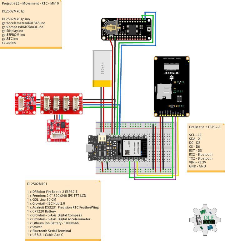

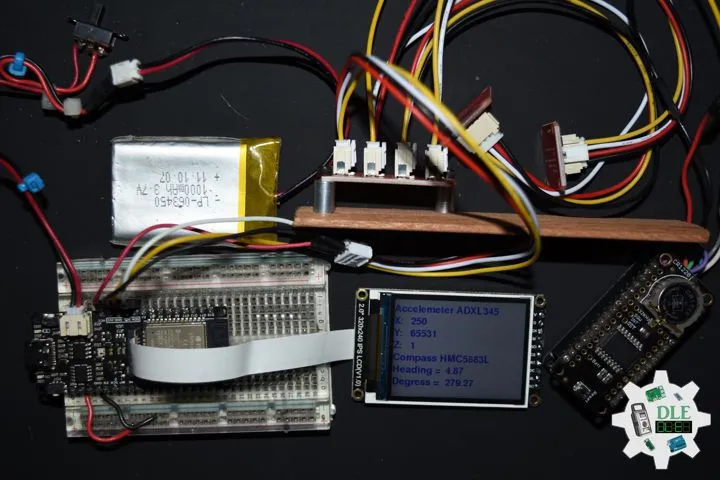

DL2502Mk01
1 x DFRobot FireBeetle 2 ESP32-E
1 x Fermion: 2.0" 320x240 IPS TFT LCD
1 x GDL Line 10 CM
1 x Crowtail - I2C Hub 2.0
1 x Adafruit DS3231 Precision RTC FeatherWing
1 x CR1220 Battery
1 x Crowtail - 3-Axis Digital Compass
1 x Crowtail - 3-Axis Digital Accelerometer
1 x Switch
1 x Bluetooth Serial Terminal
1 x USB 3.1 Cable A to C
SCL - 22
SDA - 21
DC - D2
CS - D6
RST - D3
RX2 - Bluetooth
TX2 - Bluetooth
VIN - +3.3V
GND - GND
DL2502Mk01p
DL2502Mk01p.ino
getAccelemeterADXL345.ino
getCompassHMC5883L.ino
getDisplay.ino
getEEPROM.ino
getRTC.ino
setup.ino
