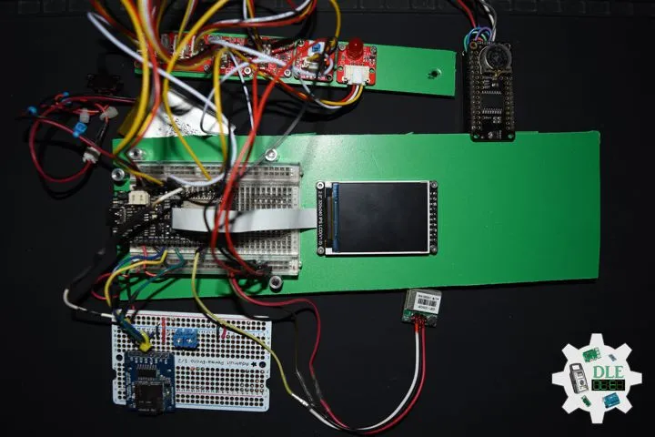

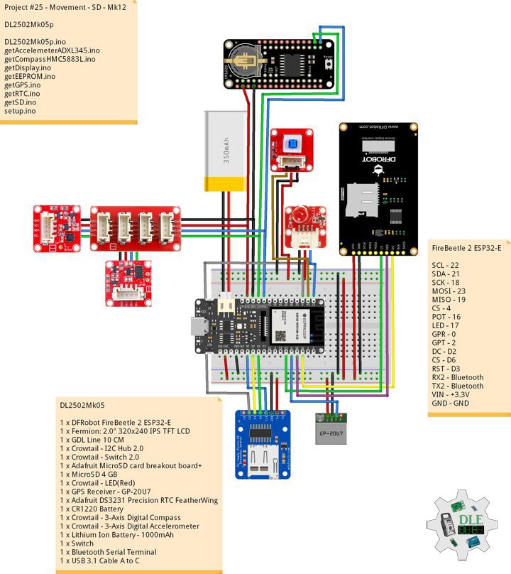

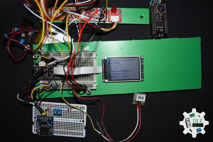

MicroSD Card Module
There are different microSD card modules compatible with the ESP32. We’re using the microSD card module it communicates using SPI communication protocol. You can use any other microSD card module with an SPI interface. This microSD card module is also compatible with other microcontrollers like the Arduino boards. To learn how to use the microSD card module with the Arduino. You can connect it to the ESP32 using the default SPI pins.
DL2502Mk05
1 x DFRobot FireBeetle 2 ESP32-E
1 x Fermion: 2.0" 320x240 IPS TFT LCD
1 x GDL Line 10 CM
1 x Crowtail - I2C Hub 2.0
1 x Crowtail - Switch 2.0
1 x Adafruit MicroSD card breakout board+
1 x MicroSD 4 GB
1 x Crowtail - LED(Red)
1 x GPS Receiver - GP-20U7
1 x Adafruit DS3231 Precision RTC FeatherWing
1 x CR1220 Battery
1 x Crowtail - 3-Axis Digital Compass
1 x Crowtail - 3-Axis Digital Accelerometer
1 x Switch
1 x Bluetooth Serial Terminal
1 x USB 3.1 Cable A to C
SCL - 22
SDA - 21
SCK - 18
MOSI - 23
MISO - 19
CS - 4
POT - 16
LED - 17
GPR - 0
GPT - 2
DC - D2
CS - D6
RST - D3
RX2 - Bluetooth
TX2 - Bluetooth
VIN - +3.3V
GND - GND
DL2502Mk05p
DL2502Mk05p.ino
getAccelemeterADXL345.ino
getCompassHMC5883L.ino
getDisplay.ino
getEEPROM.ino
getGPS.ino
getRTC.ino
getSD.ino
setup.ino
