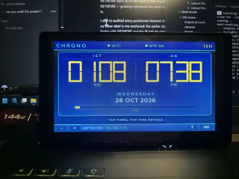

CHRONO: Dual Timezone WiFi Clock on CrowPanel 7-inch HMI
A glowing CHRONO dashboard for the CrowPanel 7-inch ESP32-S3 HMI: dual IST/UK time on real seven-segment digits, BST-exact UK time, a day-progress bar, Wi-Fi/NTP status LEDs, an AP setup portal, and touch controls. Built with LVGL 8 + PlatformIO and fully open source on GitHub.
About this project
CHRONO is a Wi-Fi connected dual-timezone dashboard for the Elecrow CrowPanel 7-inch ESP32-S3 HMI (800x480 RGB touch display). It shows Indian Standard Time and UK local time side by side on bright seven-segment digits, with the date, a day-progress bar and live Wi-Fi/NTP status LEDs - all rendered with LVGL 8 and drawn in a clean instrument-panel style.
The firmware is a complete, self-contained PlatformIO project: display and GT911 touch drivers, a robust network state machine with Wi-Fi backoff and three fallback NTP servers, an AP configuration portal, and a seven-segment UI that needs no custom fonts. No SquareLine export, no missing assets - clone it, open it, build it.

How it works
The ESP32-S3 drives the 800x480 RGB panel through LovyanGFX's RGB bus at 15 MHz PCLK, with LVGL 8.3 rendering into a partial framebuffer. The GT911 touch controller is reset through the PCA9557 IO expander (V3.0 board timing); a locally patched TAMC_GT911 library skips its own GPIO reset so the boot log stays clean. UK time uses the system timezone GMT0BST,M3.5.0/1,M10.5.0/2, so daylight saving is always exact; IST is computed as UTC+5:30.
The network layer is a small state machine (port from the 2.8-inch CHRONO): it reconnects with exponential backoff forever, requests time from three NTP servers, re-syncs every 6 hours, and keeps the last good time if Wi-Fi drops.
