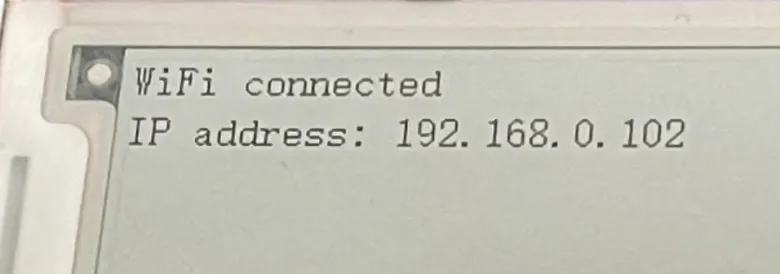

Hello World in MicroPython for the CrowPanel Epaper Display
# E-Paper display
import CrowPanel as eink
# Instantiate a Screen
screen = eink.Screen_579()
# prepare framebuffer
screen.fill(eink.COLOR_WHITE)
# Output message
screen.text("Hello World!", 30, 80, eink.COLOR_BLACK
#Load buffer to screen and display
screen.show()
Check out the further MicroPython examples on my site.
