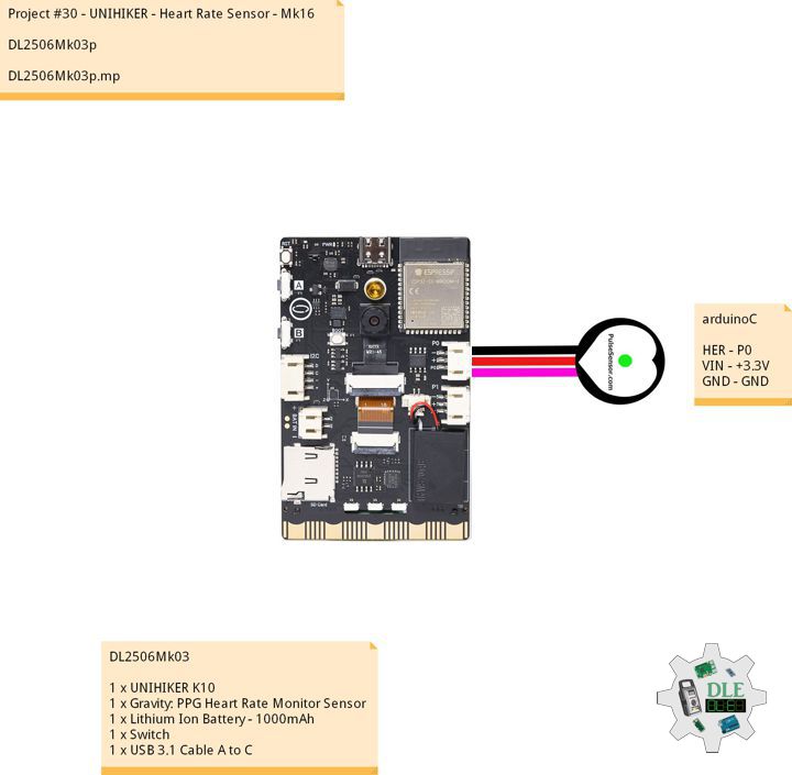

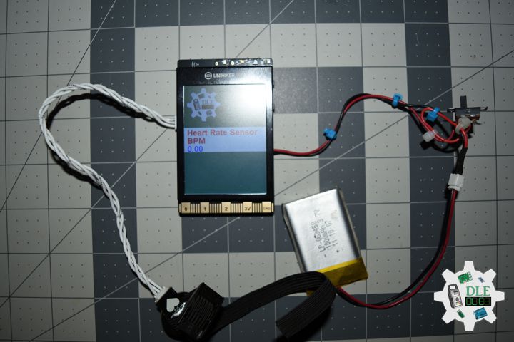

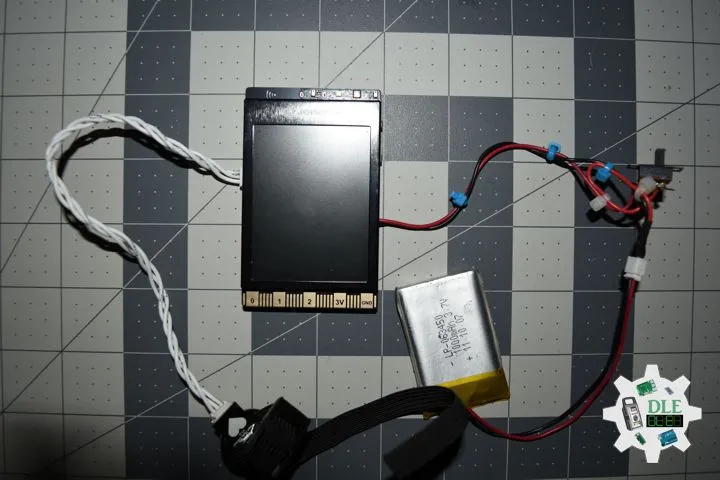

Heart Rate Sensor
The DFRobot heart rate sensor is a thumb-sized heart rate monitor designed for microcontrollers. It includes a Gravity interface, for easy plug-and-play connectivity. This sensor is a pulse sensor which is developed based on PPG (PhotoPlethysmoGraphy) techniques. This is a simple and low-cost optical technique that can be used to detect blood volume changes in the microvascular bed of tissues. It is relatively easy to detect the pulsatile component of the cardiac cycle according to this theory. The sensor has two holes that you can use to attach to your belt. You can wrap on your finger, wrist, earlobe or other areas where it has contact with skin. The heart sensor has two kinds of signal output mode: analog pulse mode and digital square wave mode. You can change its output mode using the dial switch. There are many user scenarios, including education, sports or maker/interactive projects.
DL2506Mk03
1 x UNIHIKER K10
1 x Gravity: PPG Heart Rate Monitor Sensor
1 x Switch
1 x USB 3.1 Cable A to C
DL2506Mk03p
DL2506Mk03p.mp
