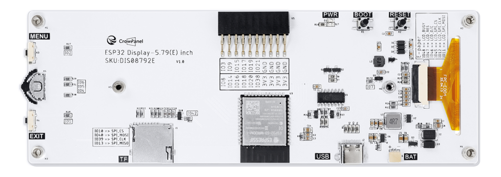

2 - Pins and other IO

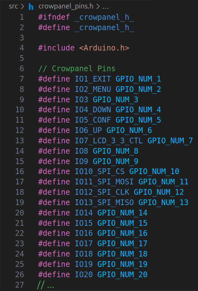

The first time you try to code with the CrowPanel, you might be confused as to which component is attached to which pin. In the following image, that is available on Elecrow's store page, you can see a label of all of the connections:Back side of the kit
But because the images on the store's page can be a little hard to read, I made a header file with all the usable pins of this kit, if you wish to use these definitions, all you have to do is create a file named 'crowpanelpins.h' in your source directory and paste the code below into it (click image to view and copy code):

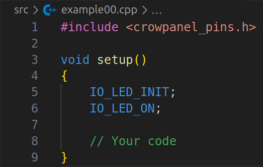

One thing I like to do is to add the code below at the start of the setup function, with it, the power LED turns on almost as soon as the Esp gets power:

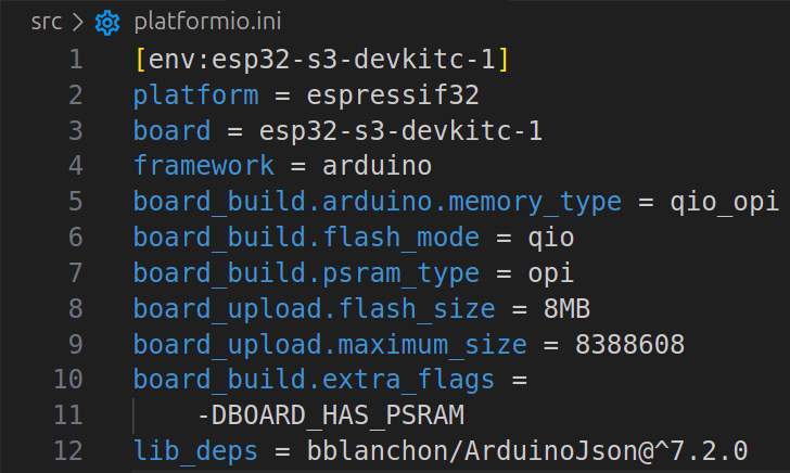

If you, like me, use VSCode and PlatformIO for Esp coding, you will need this custom 'platformio.ini' file:

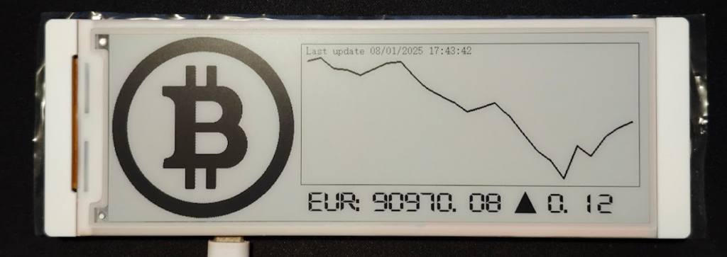

As an example I coded a cryptocurrency ticker that gets the latest price of Bitcoin from CoinGecko and displays it on the screen along with a graph and the difference in percentage:
Bitcoin ticker using the kit
