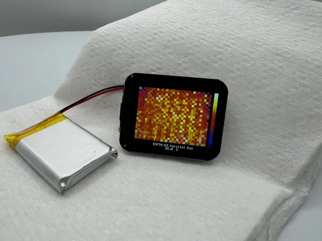

This project has gone through several revisions over several months. This latest uses a pcb track antenna instead of the chip type. Tuning has gone well and it seems to perform well. This version uses an ESP32-S3 processor allowing everything to fit on the backside of a 1.69" screen. An 8-bit bus improves the refresh dramatically over traditional spi displays. It is powered by a USB-C connector or small LiPO battery
Two right angle pushbuttons are on one side if needed and two small vertical ones needed only when first powering up the board to bring up the com port. The thermal code provided is rough but shows basic functionality. Hopefully it can be of some help allowing you to make improvements. The design files are all available if you would like to assemble your own and change the design yourself.
