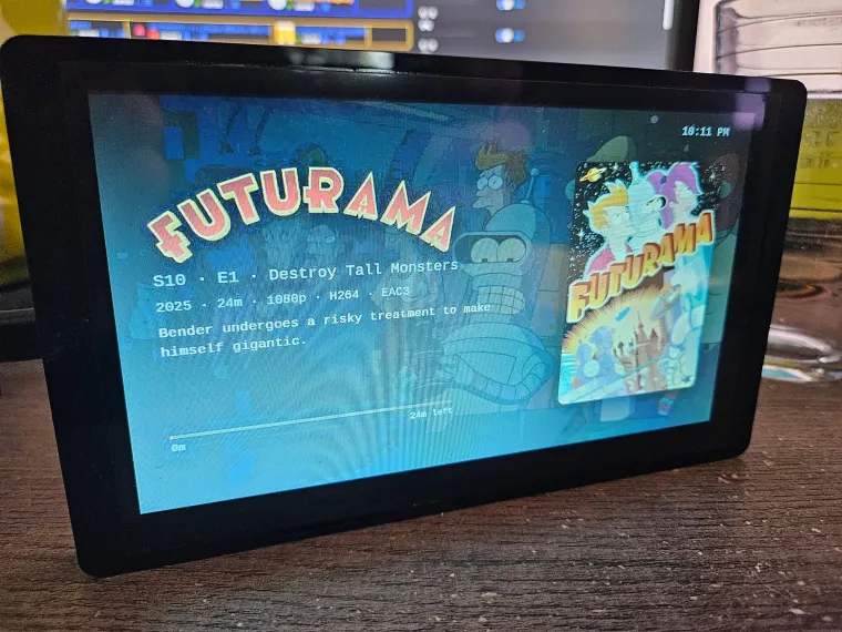

Hi all — sharing a finished, working project for the **CrowPanel "Basic" HMI 7.0"**
(ESP32-S3-WROOM-1-N4R8, 800×480, GT911 touch) in case anyone wants something fun to
run on theirs.
It shows a **media "now playing" card** — poster, title, plot, ratings, progress
bar, clock — for **Plex, Emby, or Jellyfin**, full-screen on the panel. It's built
on a project called [Marquee](https://github.com/Jamisonfitz/marquee) (which
normally casts to a Google Nest Hub); I added an **ESPHome** path so the CrowPanel
can show the identical card instead.

## The idea in one picture
Plex / Emby / Jellyfin
   Marquee  ───►  renders a beautiful now-playing web card
  marquee-shot   ───►  screenshots that card to a plain image
 (tiny sidecar)
        │  http://your-server:8088/card.jpg
   ESP32 panel   ───►  downloads the image, shows it full-screen
   (ESPHome)
The ESP32 is deliberately **dumb**: it just downloads a JPEG and paints it on the screen. All the pretty layout work happens on your server, where it's easy. That's the trick that keeps the ESP side simple and reliable.
## Two ways to do it (pick one)
### 1. Screenshot sidecar — recommended, pixel-perfect
A tiny extra container called **`marquee-shot`** opens Marquee's real card page in headless Chromium, screenshots it, and serves it as `/card.jpg`. The panel just shows that image. Because it's a photo of the *actual* card, it looks **identical** to what a Nest Hub would show — and you automatically get any future design changes for free.
The sidecar is a **decoupled add-on**: it only reads Marquee over HTTP and never changes it. That means it works against **any** Marquee — including the plain upstream image — so you don't have to run a forked app.
### 2. On-device render — no sidecar
The ESP32 rebuilds a simpler version of the card itself from Marquee's JSON + artwork. Lighter (no Chromium container), but it's a re-creation, not a pixel copy. There are two ready-made examples in the repo (`crowpanel-lambda.yaml` = simple poster+title; `crowpanel-lvgl.yaml` = cinematic dimmed backdrop).
Most people will want option 1.
