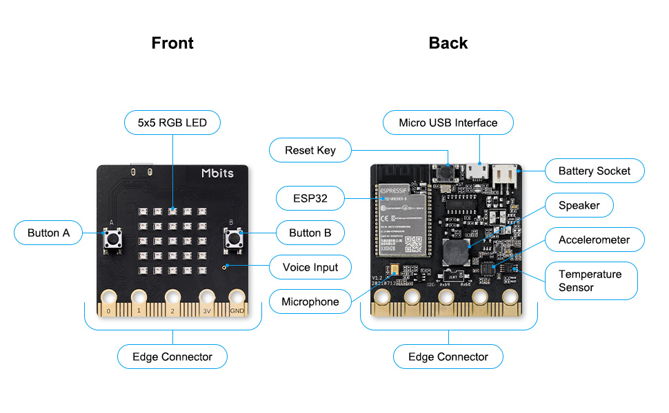

Mbits is a pocket-sized microcontroller has lots of features the same as Microbit V2. Mbits is an ESP32-WROVER-B based educational hardware suitable for kids to learn how to program and experience hot topics such as IoT and AI.
Model: MIB26580B
Features¶
- Pocket-sized microcontroller designed
- Wireless connectivity with built-in 2.4GHz micro:bit radio and BLE Bluetooth 4.2
- Onboard MEMS microphone, speaker, 25 RGB LEDs
- Onboard accelerometer for motion sensing applications
- Notched edge connector for easier connections
- Dedicated I2C bus for peripherals
- Two programmable buttons
- Supports graphical programming (Lestscode, based on Scratch3.0), Arduino IDE and Micro Python
