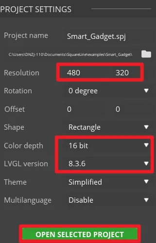

  1. Open the SquareLine Studio and create a project. Select "Arduino"->"Arduino with TFT_eSPI".
    SLS-UI-1
    Note:
    When select the Arduino framwork, there's only one option "Arduino with TFT_eSPI". By choosing this, the squareline studio will generate a template code suitable for the TFT_eSPI library. However, squareline studio not only supports the TFT_eSPI library, it supports a variety of libraries to suit different hardware and application needs. For example, Adafruit_GFX library, LovyanGFX etc.

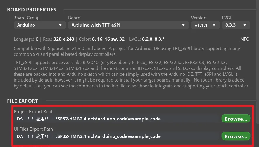

  9. Export UI files.
    SLS-UI-25
    SLS-UI-26
    Then click "APPLY CHANGES".
    SLS-UI-27
    SLS-UI-28
    SLS-UI-29

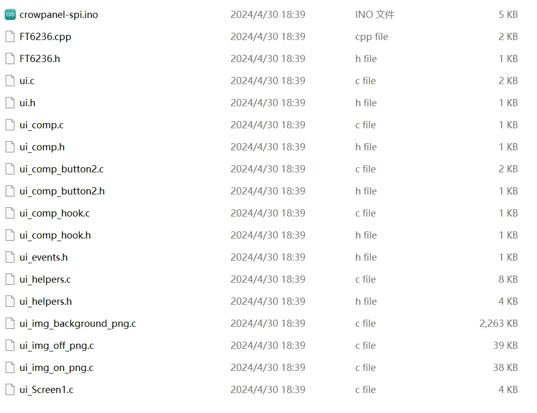

    Please click download to download the main program(and the expert UI is included).
    SLS-UI-30

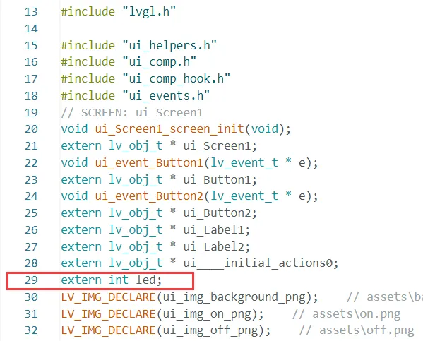

    First, define an extern variable in the ui.h file to store the status of the LED. In the main program, the LED light is controlled to turn on and off by judging the status of this variable.
    extern int led;
    SLS-UI-41
    SLS-UI-33
    • When button 1 (ON button) is pressed, set the LED value to 1.
    SLS-UI-34
    • When button 2 (OFF button) is pressed, set the LED value to 0.
    SLS-UI-35

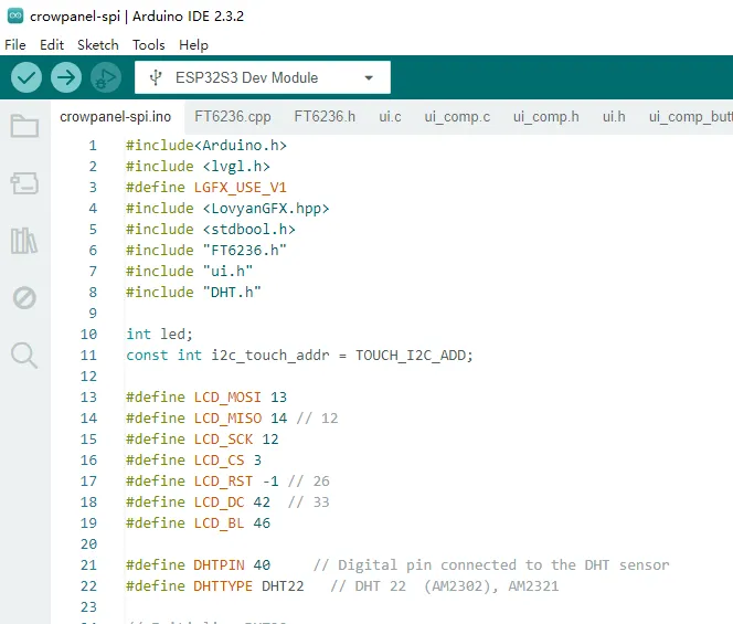

#include<Arduino.h>
#include <lvgl.h>
#include <LovyanGFX.hpp>
#include <stdbool.h>
#include "FT6236.h"
#include "ui.h"
#include "DHT.h"

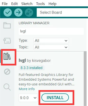

Tips:
  • If you install the lvgl libraries by Library Manager, you need to copy the demos folder and examples folder and paste them to src folder. And modify the lv_conf_template.h file and rename it to lv_conf.h, and place it in libraries folder.(Please refer to the library provided)
SLS-UI-38
SLS-UI-39
SLS-UI-40

const int i2c_touch_addr = TOUCH_I2C_ADD;
#define LCD_MOSI 13
#define LCD_MISO 14 // 12
#define LCD_SCK 12
#define LCD_CS 3
#define LCD_RST -1 // 26
#define LCD_DC 42  // 33
#define LCD_BL 46
#define DHTPIN 40     // Digital pin connected to the DHT sensor
#define DHTTYPE DHT22   // DHT 22  (AM2302), AM2321
// Initialize DHT20 sensor
DHT dht(DHTPIN, DHTTYPE);
#define SDA_FT6236 2
#define SCL_FT6236 1

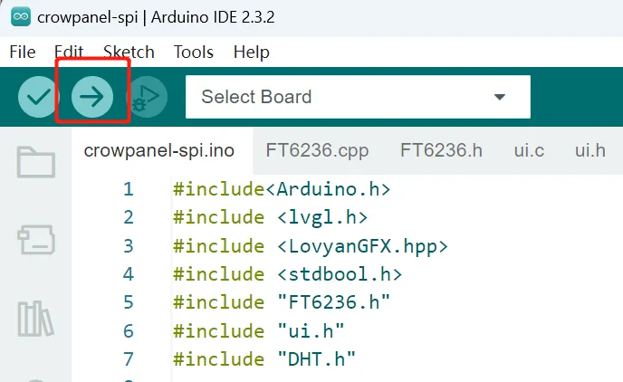

Upload the Code

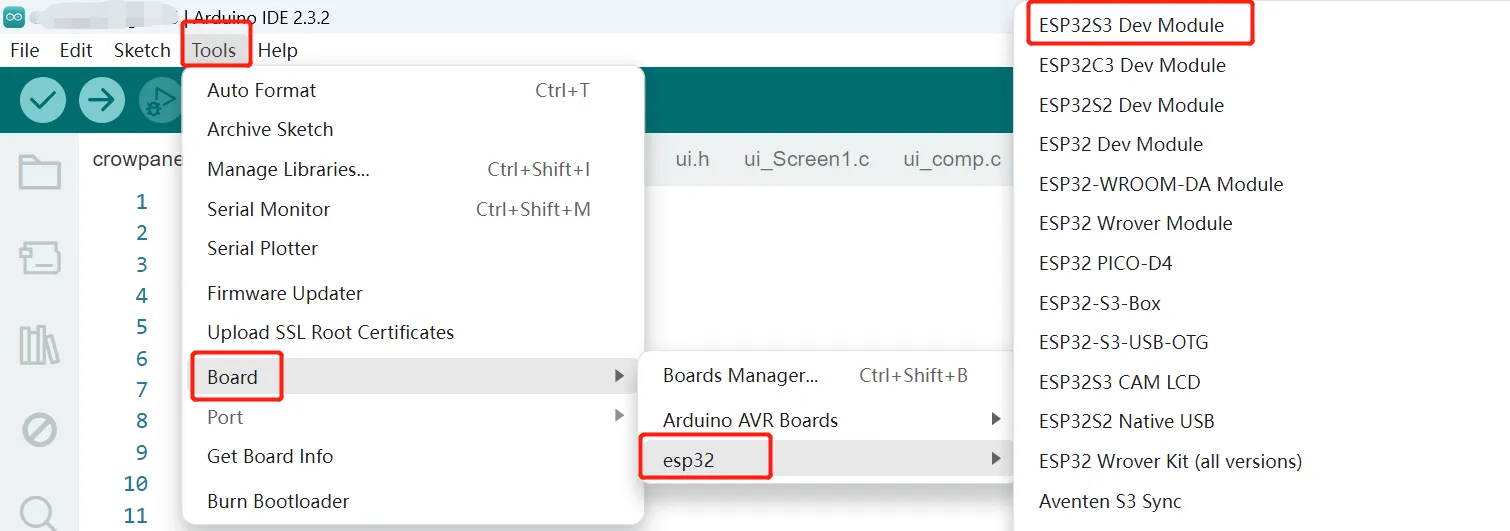

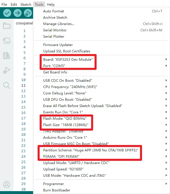

  1. After completing the installation of the ESP32 board according to "Get Started with Arduino IDE" and the installation of the library according to "Install Libraries", open the program and connect the ESP32 Terminal to the computer via a USB-C cable.
  2. Select Board: click "Tools" -> "Board" -> "esp32" and select "ESP32S3 Dev Module"
    select-board
  3. Setting: Click "Tool", select "16MB" as the flash size, select "Huge APP..." as the partition scheme, and select the "OPI PSRAM" as the PSRAM.
    setting
  4. Select Port
    Select the serial port corresponding to the ESP32 terminal board.
  5. Upload the code
    upload-the-code

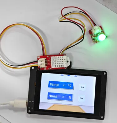

  6. After the program is successfully uploaded, connect the sensor to the D2 Port(IO40) port and the LED to D1 Port(IO11), the temperature and humidity values will be displayed on the screen. Click the ON button on the screen and the LED will turn on. Click the OFF button and the LED will turn off.

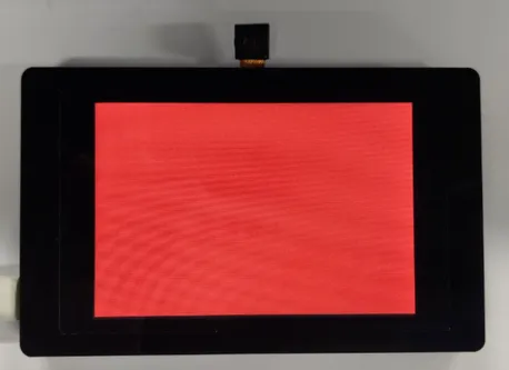

Example 1: Switch color screen
  • Open and upload the A-LCD.ino
  • The screen will display different colors
color-screen

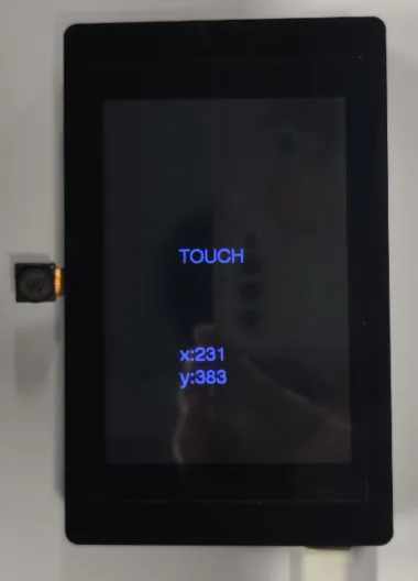

Example 3: Touch initialization
  • Open and upload the A-TOUCH.ino
  • The XY coordinates of the touch will be displayed when touching different positions
TOUCH

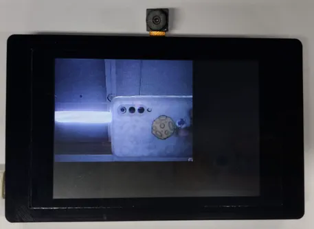

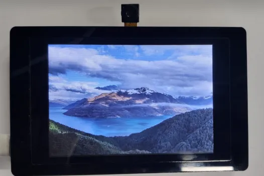

Example 4: Camera initialization
  • Open and upload the A-Camera.ino
  • The camera will open
camera

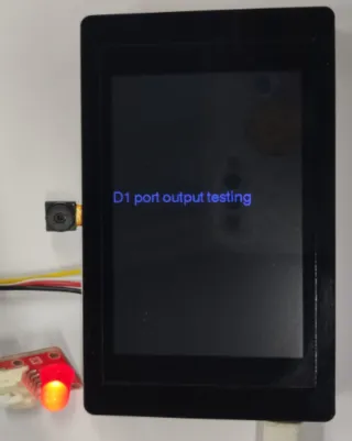

Example 5: LED Blinking and read analog sensor value
  • Plug the LED into the D port, and plug a sensor to the A port
  • Open and upload the A-A_D_PORT.ino
  • The LED will blink, and the value of the sensor will show on the serial monitor
led-blink

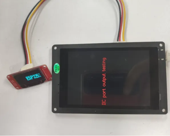

Example 6: I2C communication
  • Plug an OLED screen to the I2C port
  • Open and upload the A-IIC.ino
  • The OLED screen will display the content sent from the ESP terminal

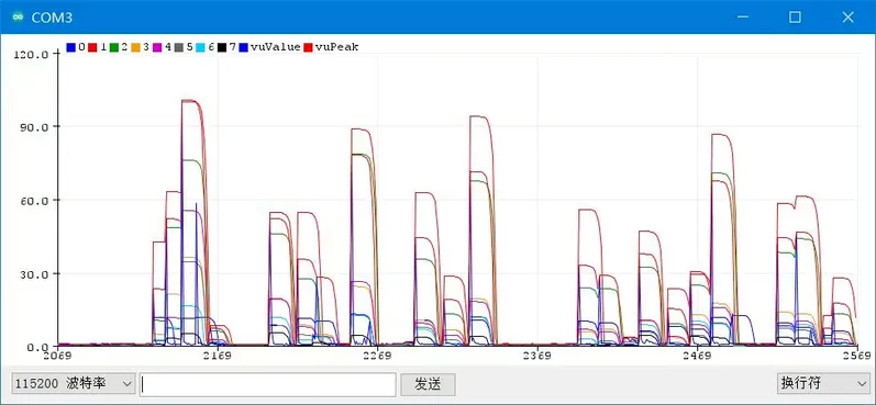

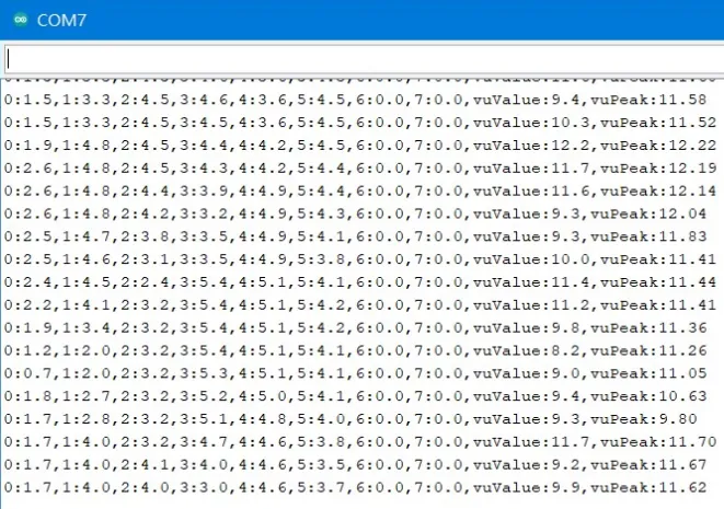

Example 8: Microphone initialization
  • Upload the A_AUDIO.ino
  • The serial monitor will display the sound waveform
sound-wave
