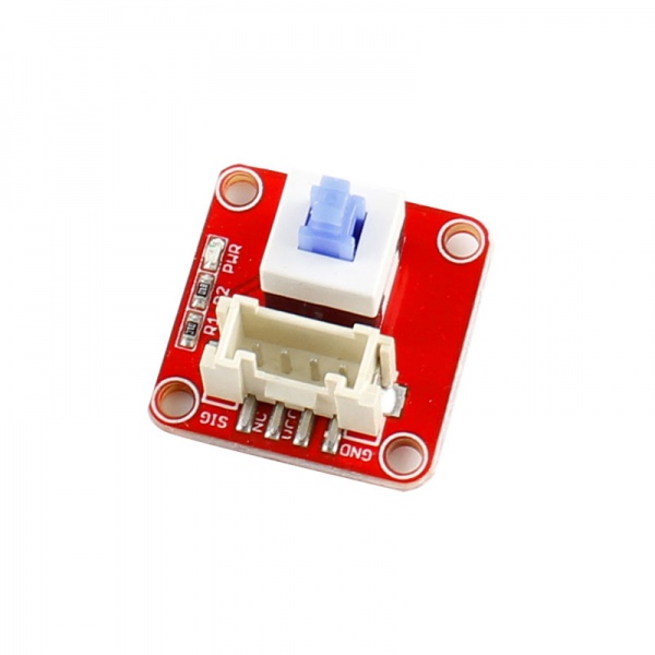

The Crowtail- Switch is a Latching switch. When the first press the switch, the switch and keep the current adjustment and the button outputs a HIGH signal,namely the self-locking. When the second press the switch, the switch off and switch button to pop up at the same time, outputs a LOW signal.
Model: CT008833S

  • Easy to use momentary ON/OFF Switch
  • Uses Standard 4-pin Crowtail Cables to connect to the Crowtail - Base Shield
  • Dimensions(mm):20.0(L)x20.0(W)x15.2(H)

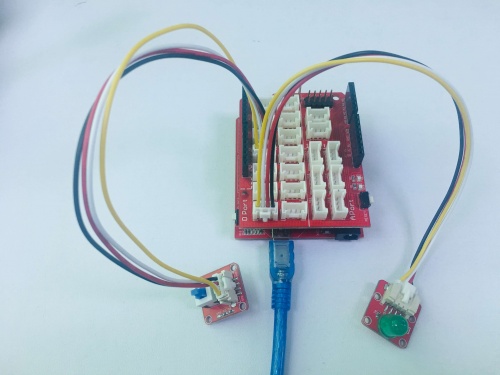

1.Hardware connection
2.Upload the following sample sketch to make the LED turn ON and OFF based on input from Crowtail- Switch:

3.Press the Switch first time, you will see the LED lights up, press the Switch again,you will see the LED lights off.
