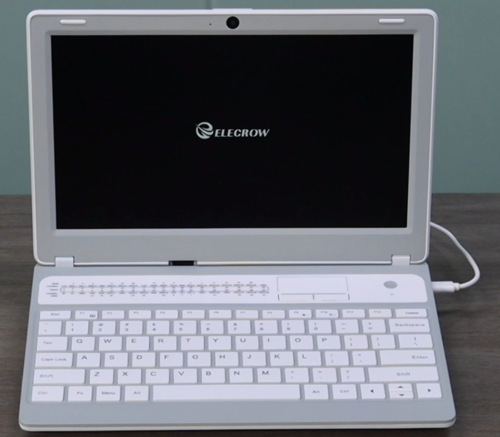

CrowPi-L is a lite version born out of CrowPi2, "L" stands for Lite, Light, and Laptop. This is a real Raspberry Pi computer. We collected a lot of opinions from CrowPi users and Raspberry Pi enthusiasts, focusing on solving many inconveniences of using Raspberry Pi DIV laptops, such as installing Raspberry Pi , switching system, heat dissipation, expanding screens, etc. Better yet, we still retain the highlights of the CrowPi series, built-in course system. Users will have a new experience bringing by Crowpi-L.
Model: SER35001L
Alt text

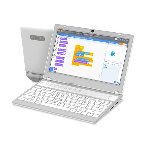

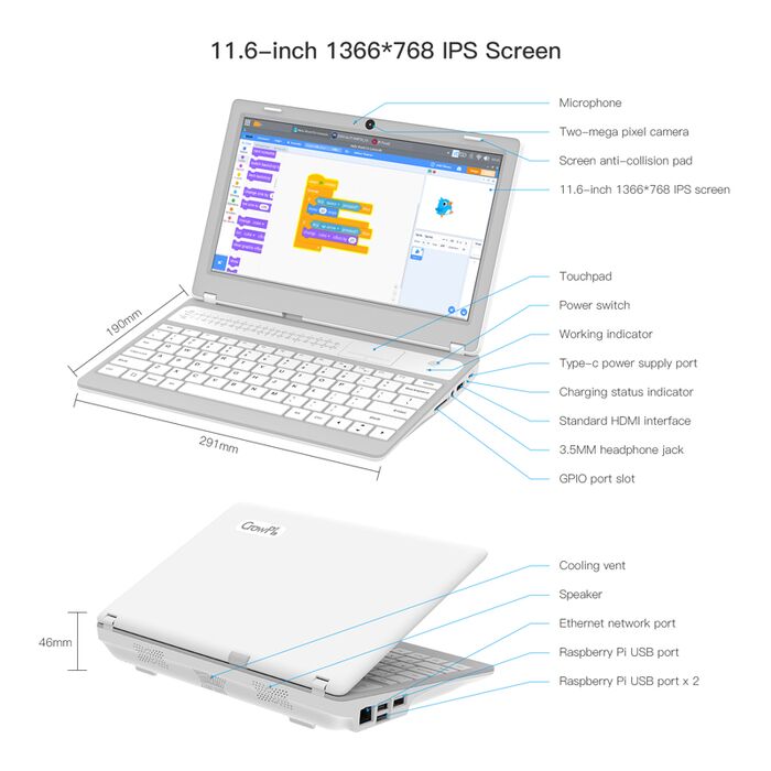

  • 11.6-inch 1366*768 IPS screen, sleek body made out of environmentally-friendly material, portable and delicate.
  • Come with keyboard and touchpad, which are the assistant for using Raspberry Pi.
  • Built-in fan and air circulation cooling system designed to protect the smooth operation of the Raspberry Pi system.
  • 40 pin expansion Raspberry Pi pin, allow users to connect the onboard sensor or output independently, which can help build Raspberry Pi projects faster and enables more creative usage.
  • 2 megapixels camera which is integrated with microphone, and also equipped with stereo output speakers.
  • The Type-C interface supports 9-20V wide voltage input, and a built-in 5000 mAh battery, which supports the device to work independently for more than three hours, and the software synchronously displays the battery power status.
  • The HDMI expansion port can be used to connect an external monitor, and the audio expansion port allow headphone or speaker to be connected.
  • Equipped with self-developed learning software, customized UI that is more suitable for traditional computer users, making software and hardware programming learning easier and more convenient.
  • Unique dual system switching function and extended storage function.

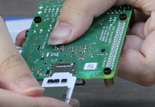

Install the screws.png Step 2. Insert the 2-in-1 TF card adapter board into the TF card slot on the back of the Raspberry Pi

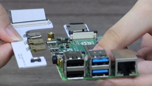

Step 3. Install HDMI expansion board

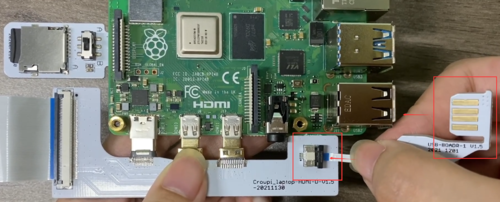

Step 4. Install USB adapter board and connect the flat cable to HDMI expansion board
Notice: The blue part is upward and the metal part is downward. Othervise there'll show nothing on the screen.

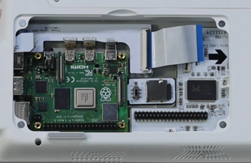

Step 5. Put the assembled Raspberry Pi into the Raspberry Pi storage compartment, there is a magnetic base at the bottom of the compartment to fix the Raspberry Pi.

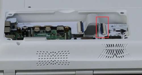

Step 6. Connect the other end of the flat cable to the motherboard.
Warning: Don't install with power on!
Warning: Do not install it askew!
Otherwise, a short circuit may occur and the flat cable may be burnt, and fingers may be burned!

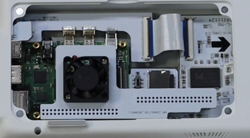

Step 7. Press the GPIO adapter board with fan from top to bottom to connect the 40 pins on both sides.

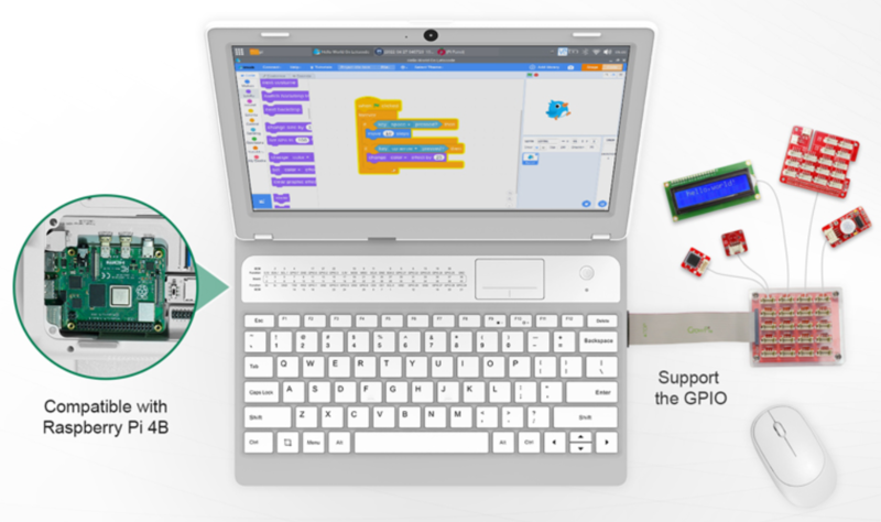

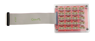

We specially designed the GPIO port adapter board for CrowPi-L. After the user plugs in the adapter board, the Crowtail series sensor can be connected externally, and users can learn software and hardware knowledge through our tutorials.
Connection steps:
Step 1. Connect the cable to the shield board
Step 2. Insert the other end of the cable into the GPIO slot on the side of the laptop

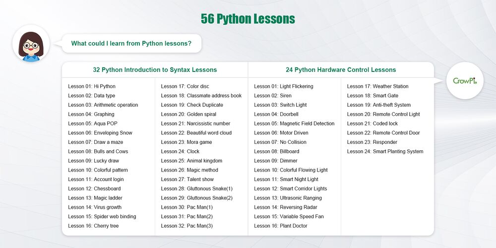

Python lessons
32 Python Introduction to syntax lessons: Suitable for students with basic graphical programming, systematic code programming introduction, staged project design, allowing users to learn the underlying logic of programming and improve logical thinking.
24 Python hardware control lessons : An advanced course for the introduction of Python syntax, complete hardware projects through code programming, consolidate and improve programming ability, and cultivate systematic design thinking.
