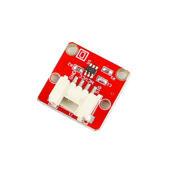

The Crowtail- Touch Sensor can help us use our body current to control the electronic device. It is connected to digital I/O port, it can generate a high voltage when we touch the touch pad.
Model: CT0012TS
  • Operating Voltage: 2.0 - 5.5V
  • Output Response Time: 60 - 220mS
  • Used Chipset:TTB223-BA6
  • Dimensions(mm):20.0(L)x20.0(W)x6.8(H)

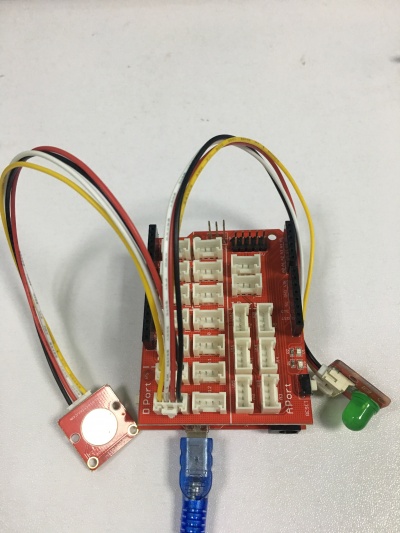

1.Hardware connection
2.Copy the demo code to your sketch, then upload to Arduino or Crowduino board.
const int TouchPin=4;
const int ledPin=5;
pinMode(TouchPin, INPUT);
pinMode(ledPin,OUTPUT);
int sensorValue = digitalRead(TouchPin);
if(sensorValue==1)
    digitalWrite(ledPin,HIGH);
else
  digitalWrite(ledPin,LOW);

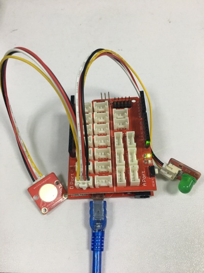

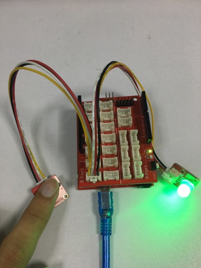

3.Touch the touch sensor,you will see the LED lights up. Touch Sensor result11.jpg Touch Sensor result22.jpg
