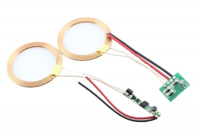

Wireless Charger& Receiver
Description¶
The Wireless Charger& Receiver adopts two copper wire coil superposition to active the wireless charging, it can be used in electronic equipments in common use for close wireless charging or power supply. This product consisted of a transmitter and receiver, could serve as a replacement for the Wireless Power Supply with stable 5V output voltage and maximum 600mA output current. Its small size and insulation coil is more suitable for using in wireless project.
Model:PCW2138WC
Specification¶
- Input Voltage: 5~12Vdc
- Output Voltage: 5Vdc
- Output Current(maximum): 600mA
- Transmitter Coil Inductance: 30uH
- Transmit-receive distance: 1-20mm
- Transmitter : 12*7*1mm
- Receiver: 15*10*1mm
- Coil Diameter: 38mm
- Coil Height: 2mm

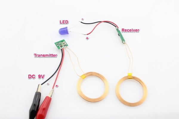

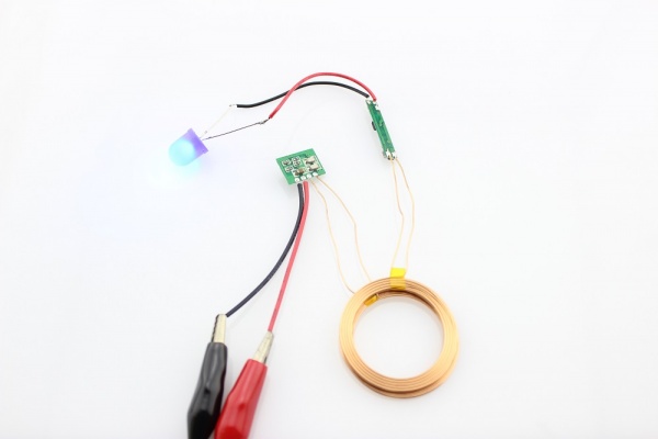

Usage¶
Light up the LED¶
1.Hardware Connection.
