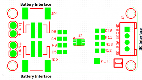

Corwtail I2C Interface
Dimensions(mm):40.0(L)x20.0(W)x7.2(H)
Interface
The Crowtail- LiPo Fuel Gauge is connecting to IIC port of Crowtail - Base Shield.
