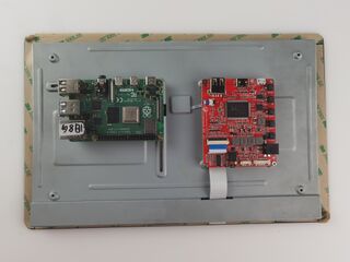

  • Unique rear fixing structure with sliding fixing pillars, compatible with most single-board computer models, easy to assemble

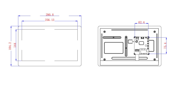

  • Active Area: 144*256.13mm(W*H)
  • Dimension Size: 184.2*290.8MM(W*H)

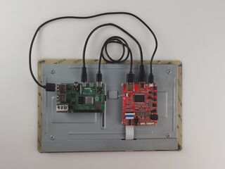

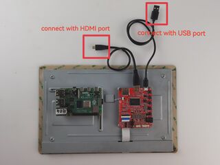

  • 1.Connect the Single Board Computer and Touch Screen Display as shown in the figure;
Or connect the Host Device and Touch Screen Display as shown in the figure;

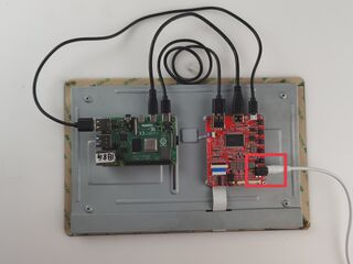

  • 2.Connect the Power Adapter and Touch Screen Display as shown in the figure;
  • 3.If you use Crowvision 11.6" with Raspberry Pi or Macbook, please download CrowVision_Driver.zip at the bottom of the Wiki page to your PC and unzip it. Then connect Crowvision 11.6" to your PC and double-click the click_me_to_update.bat file in the CrowVision_Driver file. Wait for a while, and the system will prompt you to complete the installation.
    After that, please connect the Raspberry Pi or Macbook, and you can use the touch function normally.

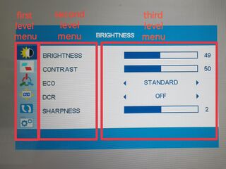

  • 4.Push "menu" botton to enter first level menu and make settings.
  • Push it again, you can enter second level menu and third level menu.
  • Push "up" and "down" botton, you can choose the option you want to change and do some change in it.
  • If you want to go back to the first level menu, push "enter" botton.
