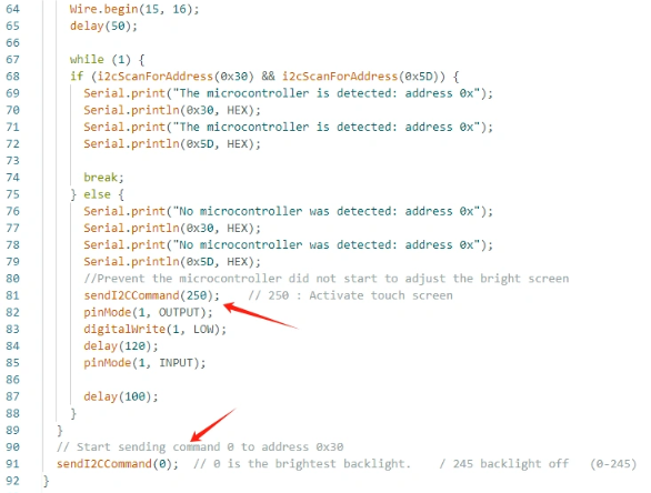

In terms of hardware, we use a microcontroller (STC8H1K28) to control the screen backlight, speaker on/off, and buzzer.
(However, there are other function interfaces that need to be written in the specific code, and you can refer to the complete code provided later.)
Explanation:
  • 0x30 is the I2C address of the microcontroller (STC8H1K28).
  • 0x5D is the I2C address of the touch IC (GT911).
  • sendI2CCommand(0) means sending command 0 to the microcontroller (address 0x30) to instruct it to set the screen brightness to maximum.
For 0 mentioned above, you can replace it with the following values:
  • 0 is the brightest backlight.
  • 0 to 245: The screen brightness will gradually increase to the minimum value
  • 245 represents turning off the screen light
Additional notes:
You can also control the following functions by sending other instructions to the microcontroller:
  • It means sending the 248 command to the microcontroller (0x30) to instruct the speaker to turn on.
  • It means sending the 249 command to the microcontroller (0x30) to instruct the speaker to turn off.
  • You can also send command 246 to control the buzzer to turn on, and send command 247 to control the buzzer to turn off.
Version 1.2 Key Points.
Version 1.2 updated the control of backlight on the basis of the original, the backlight of version 1.2 is controlled by STC8H1K28 microcontroller, and the backlight is lit in the program by sending the value to this microcontroller address (0x30). The values are 0x05, 0x06, 0x07, 0x08, 0x09 and 0x10, where 0x05 switches off the backlight and 0x10 is the maximum brightness.
When the main program is running, you need to query the i2c address all the time to prevent the microcontroller from not starting to adjust the bright screen.
The function code for data transfer is as follows, as well as the code in the main program for how to send the value to light the backlight.
