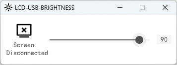

Windows System - USB Dimming Software Guide
Step1. Download and Extract USB Dimming Software (Windows)
LCD-USB-BRIGHTNESS-Windows-V1.0
Step2. Run LCD-USB-BRIGHTNESS-Windows-V1.0.exe
  • Displays "Screen Disconnected" when not connected
    Lubg-2

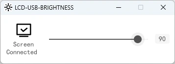

Step3. Connect Display USB to PC
  • Shows "Screen Connected" with real-time brightness adjustment • Saves last brightness setting.
    Lubg-1
