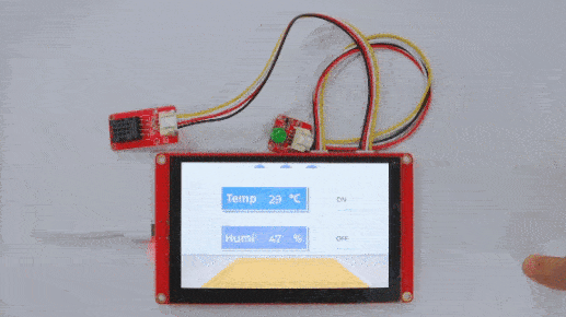

Overview¶
The example is an environmental monitoring project, using a DHT20 sensor to obtain the environment temperature and humidity and display it on the screen; and control the LED on and off by the buttons on the screen.
In this tutorial, we will show you how to design the UI with SquareLine Studio, and show you how to build a project on PlatformIO.
