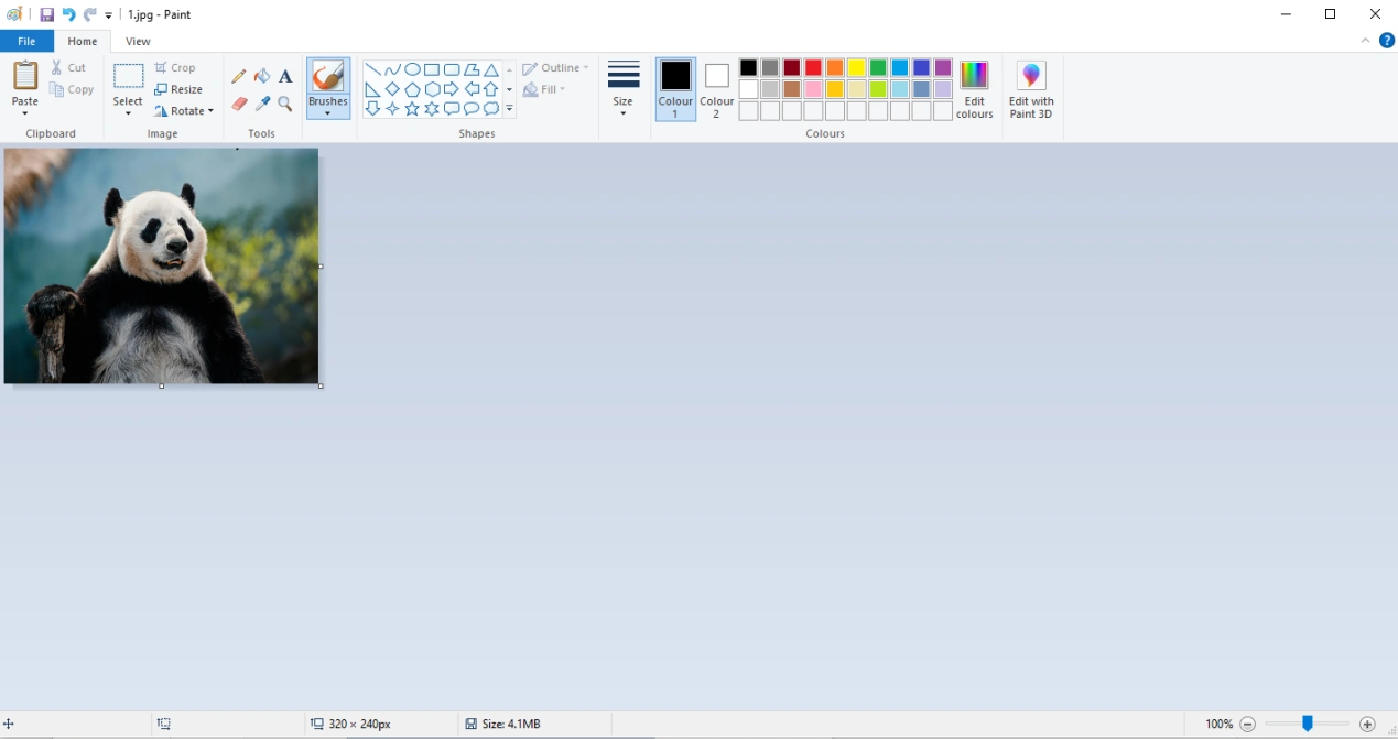

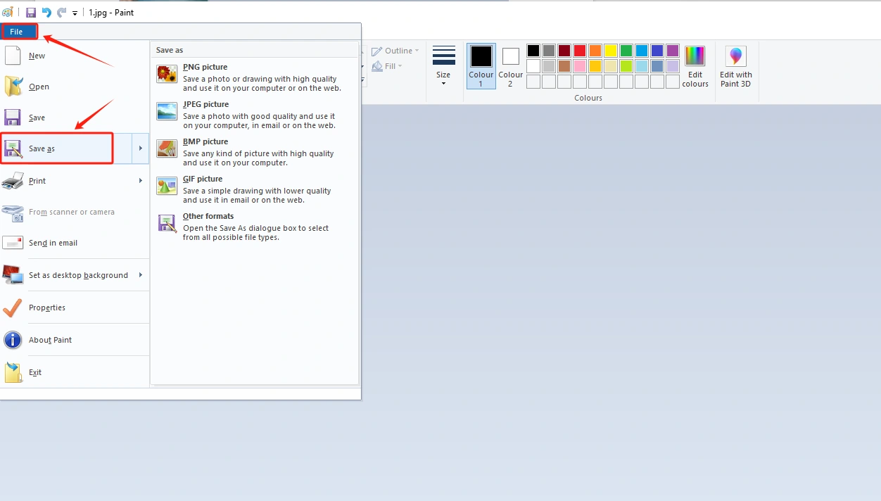

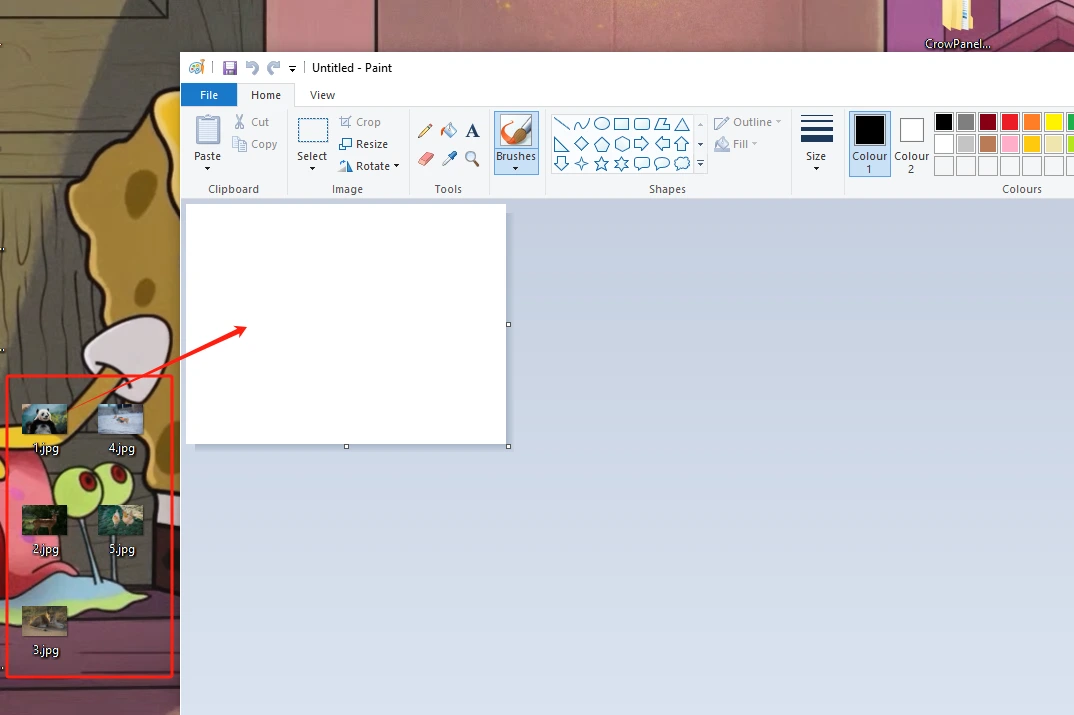

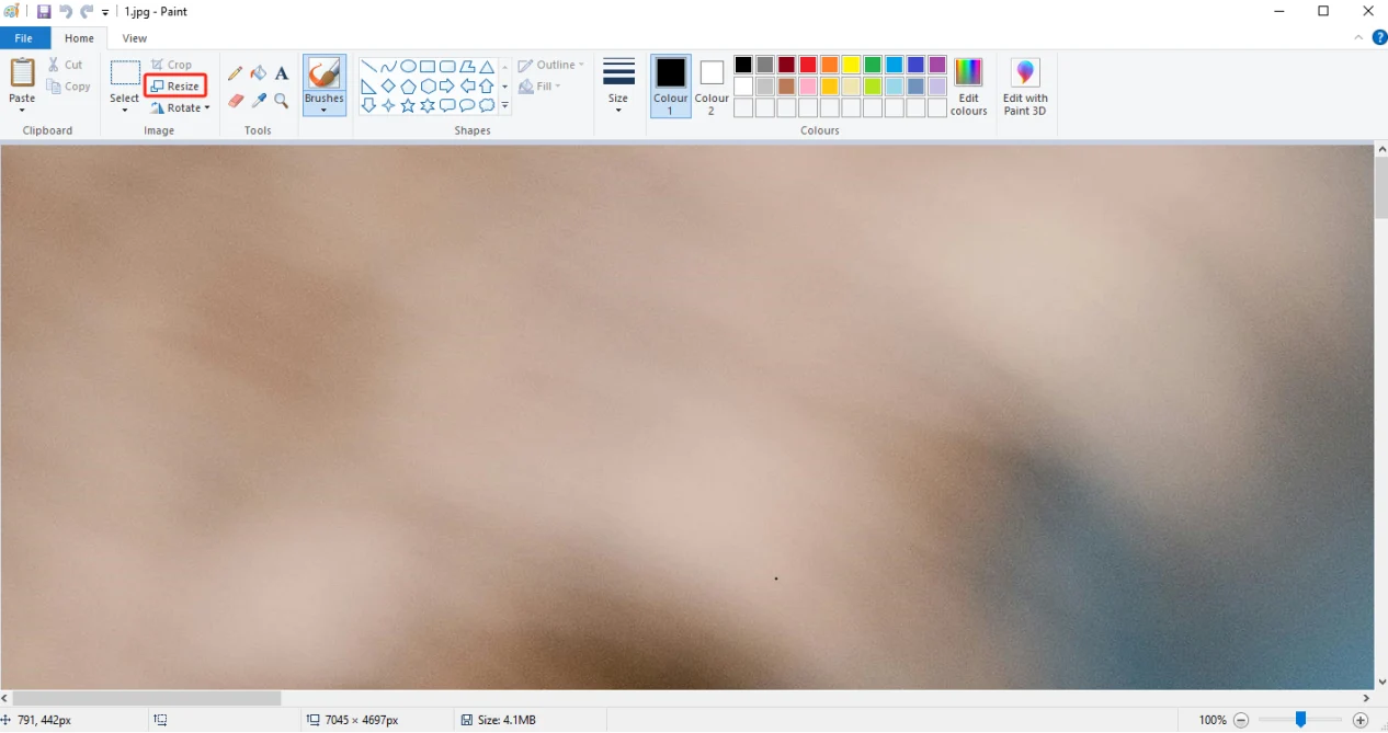

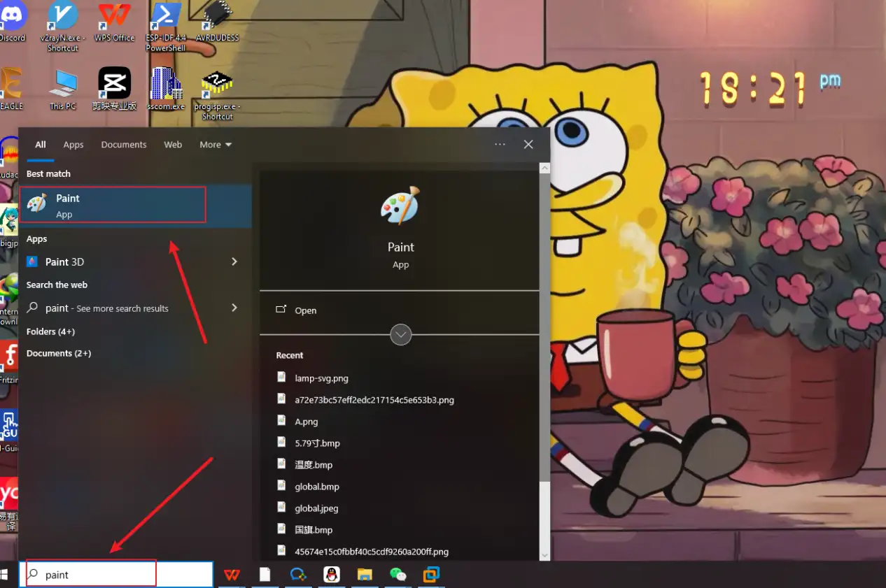

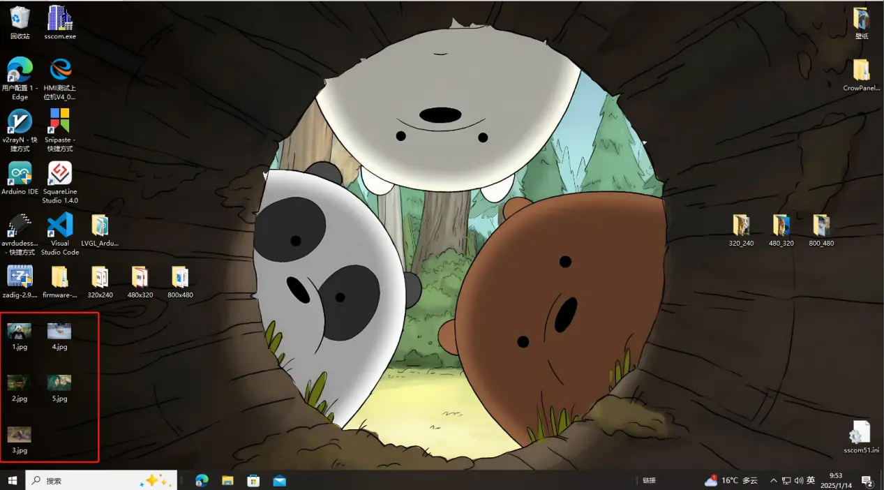

1 Select the photos you want to display on the browser and save them on the desktop (the save path can be customized)

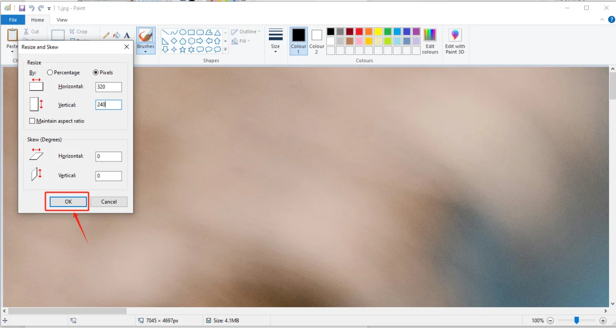

2 Modify the resolution of the image based on the size of the product you are using.
2
Here, for large-sized products, I will take the 7.0-inch product as an example to introduce how to modify the resolution of images.
The resolution of the 7.0-inch product is 320x240.
(Note: The image resolution of 7.0-inch, 7.0-inch, and 7.0-inch products is consistent, and the code and image can be used interchangeably.)
3
4
5

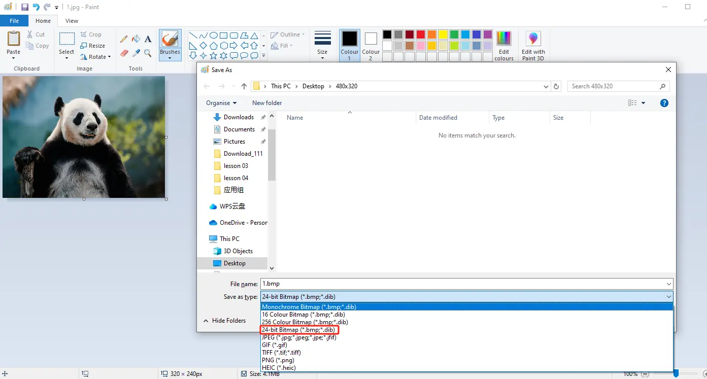

Adjust the pixel to 7.0-inch screen resolution: 320x240
(If you are using a different size, please set the correct resolution)
6
Click confirm
7
8
9
10
11
12

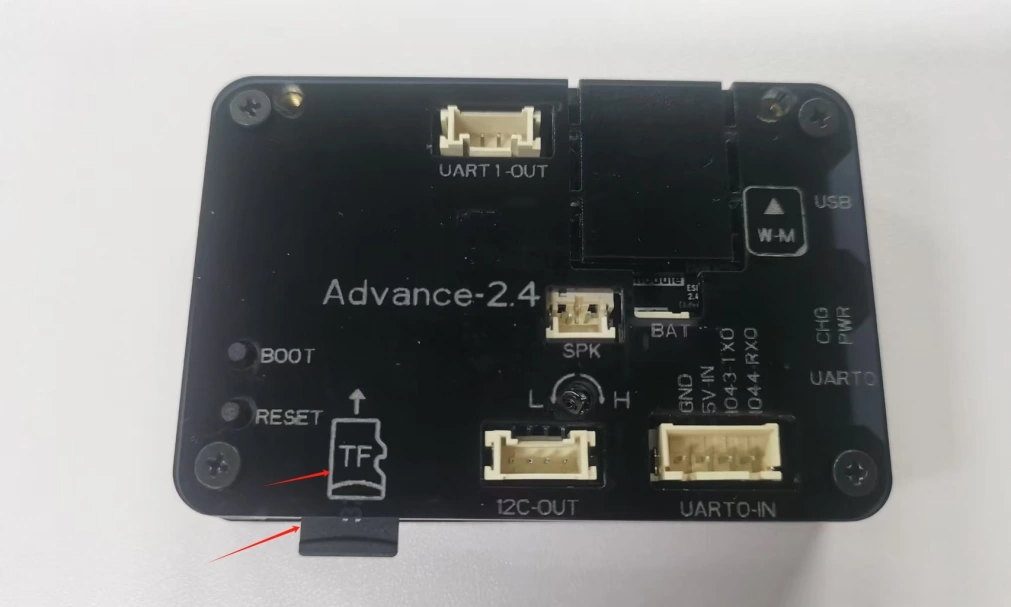

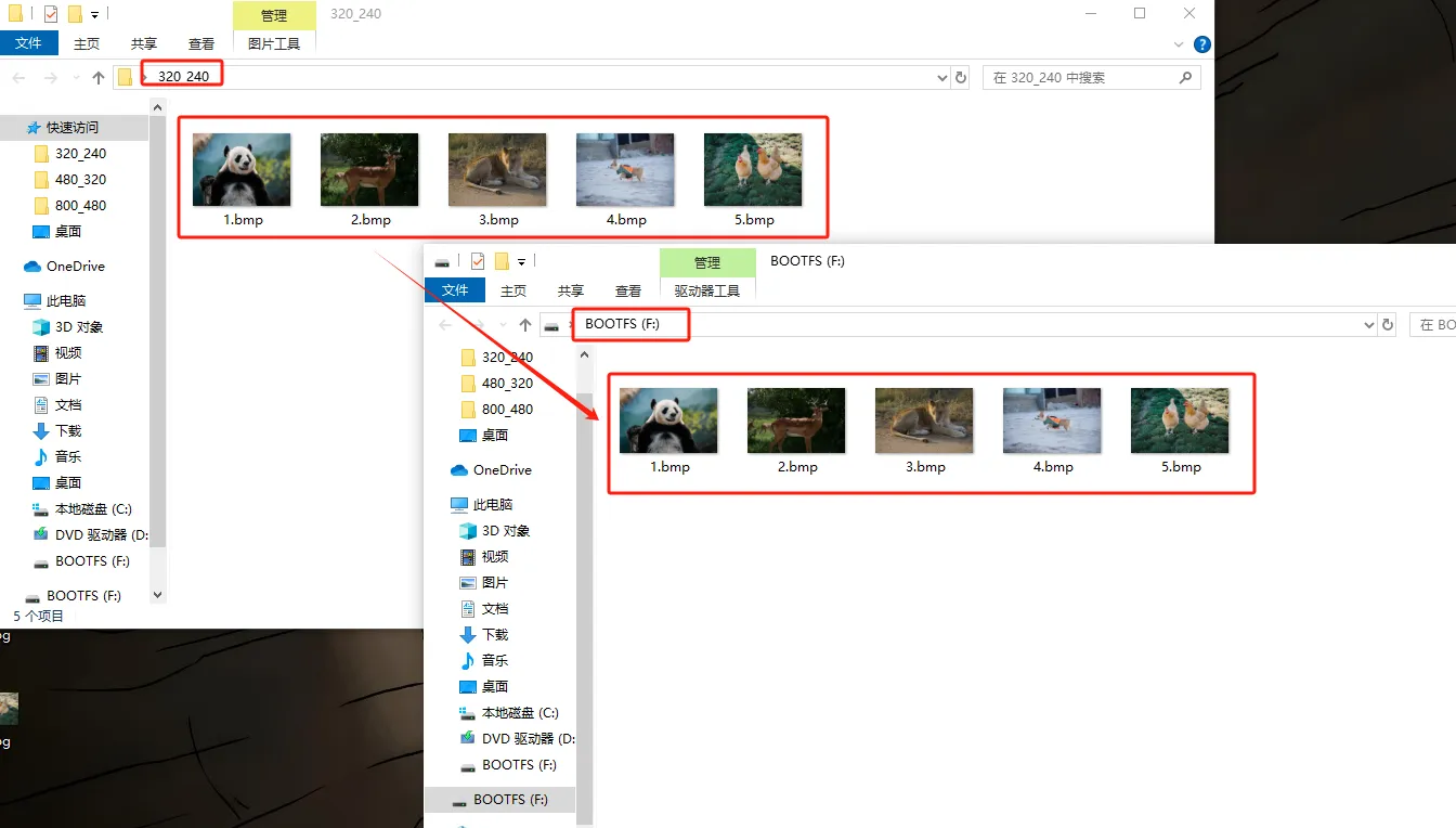

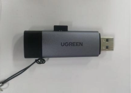

3 Insert the SD card containing this saved image into your CrowPanel ESP32 Advance HMI
13
(7.0 inch, 2.8 inch, 7.0 inch products can be directly inserted for use)

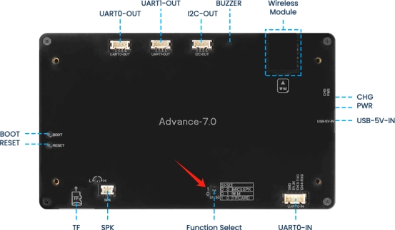

(After inserting the SD card, turn the function switch to 1 0 mode (TF Card mode) for 7.0-inch, 7.0-inch and 7.0-inch.)

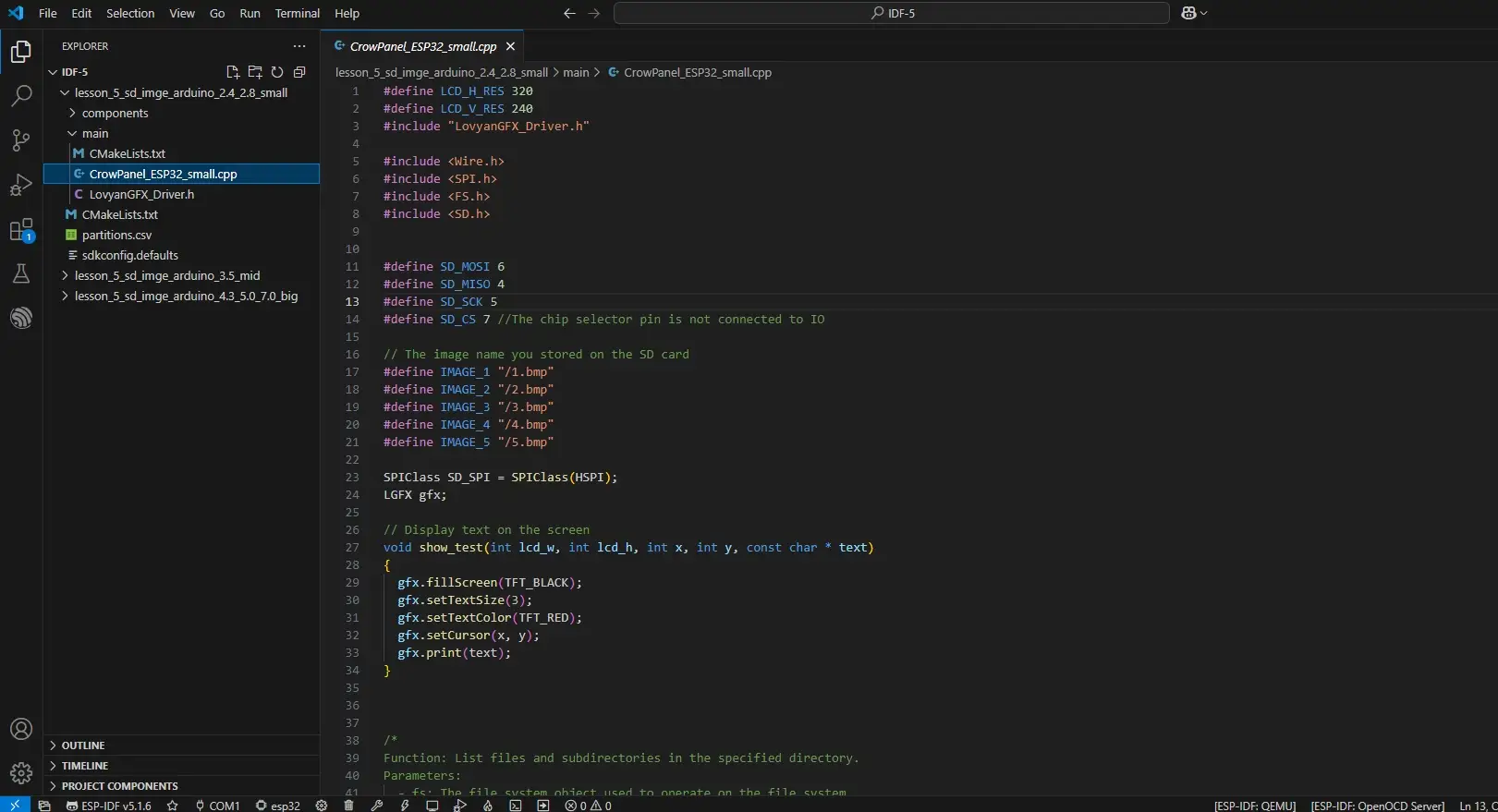

4 Open the code we provide
Code download link:https://github.com/Elecrow-RD/CrowPanel-Advance-7-HMI-ESP32-S3-AI-Powered-IPS-Touch-Screen-800x480/tree/master/example/ESP_IDF
Download it to the Desktop and Open it with VS Code

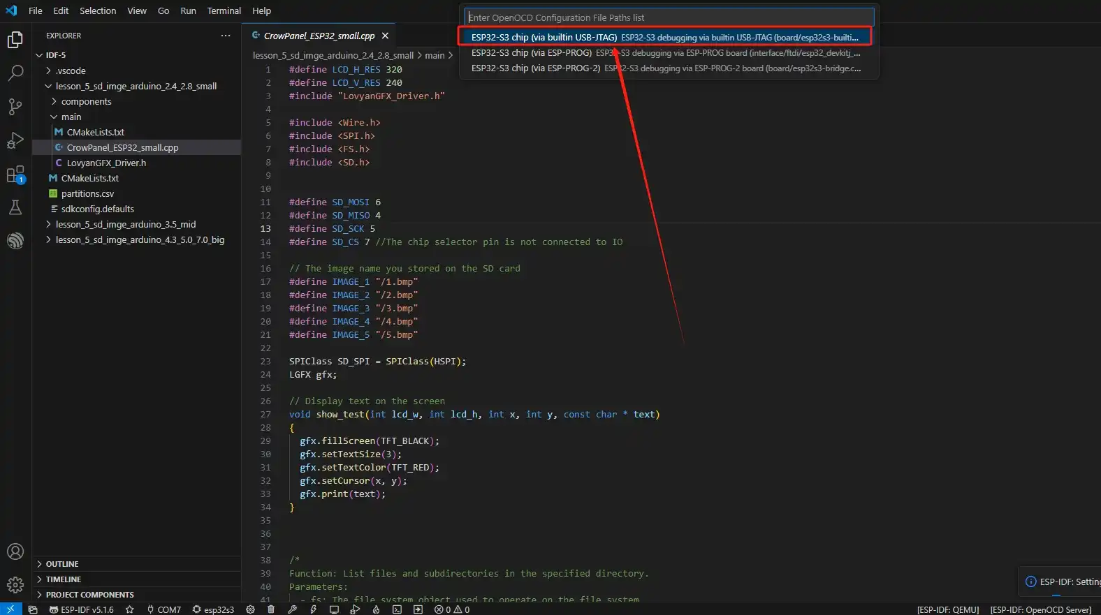

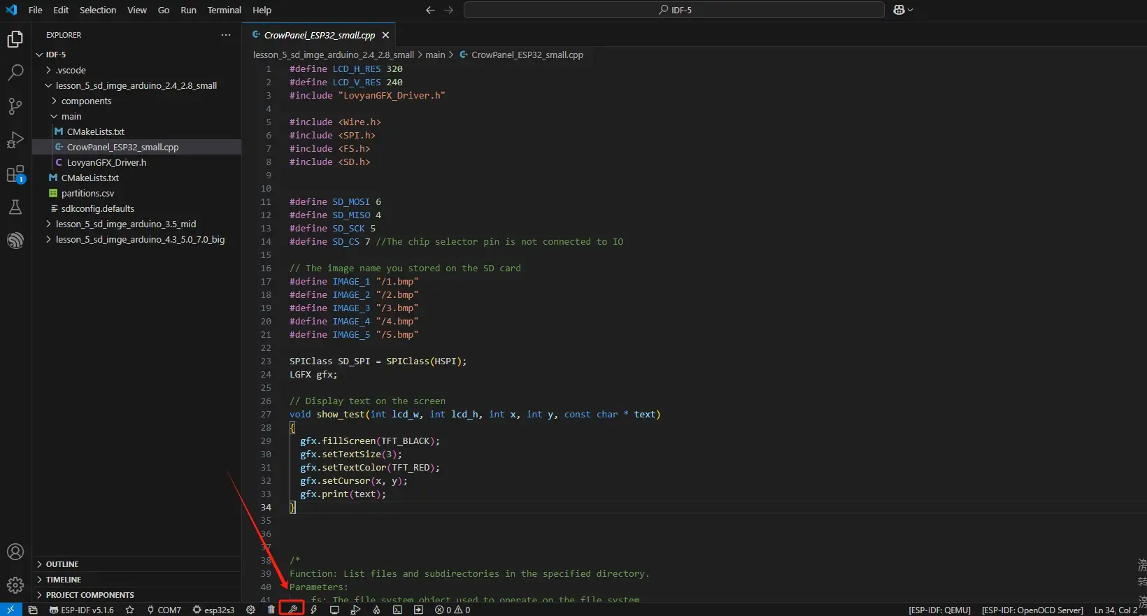

5 Configure the runtime environment and burn code

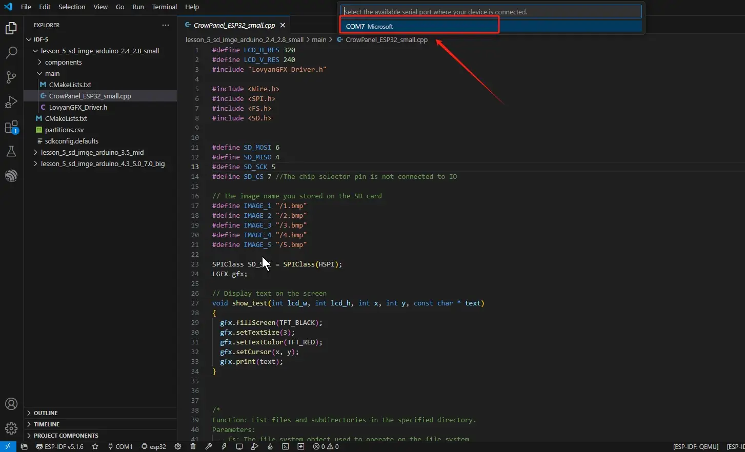

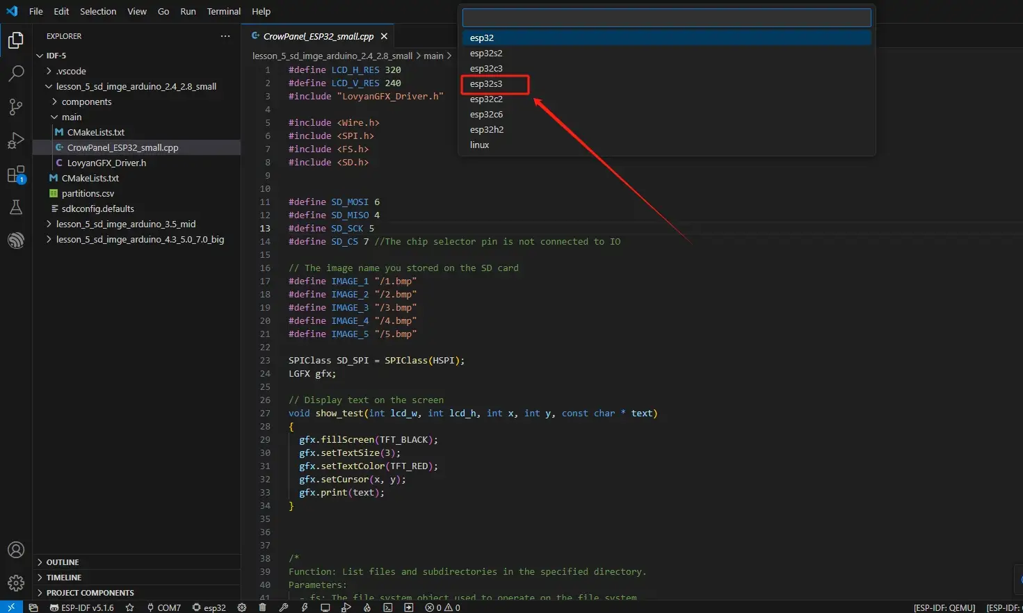

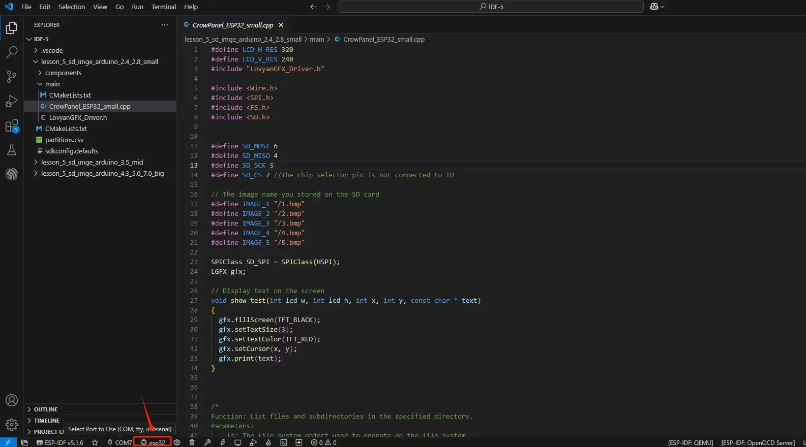

After Connecting the Device, Select the Serial Port
Set the Main Control Chip to: ESP32-S3
18
18
18

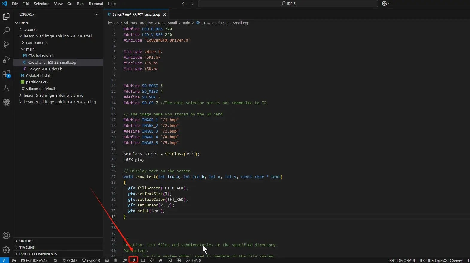

Click "Build Project". Once the compilation is complete, click "Flash Device".
18
18

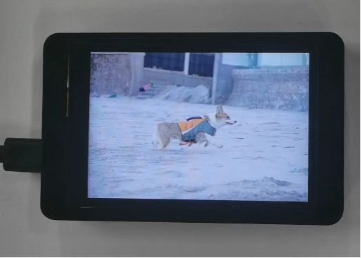

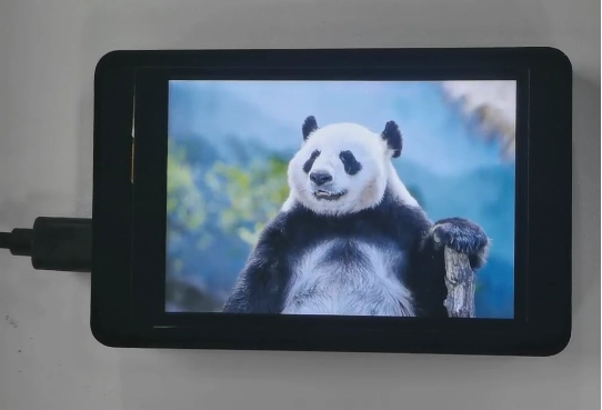

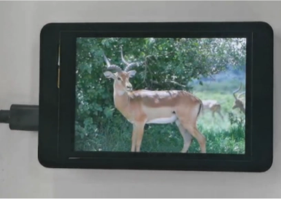

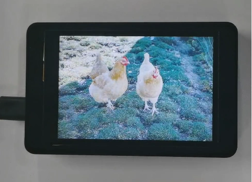

6 Phenomenon display
22
23
24
25
26
