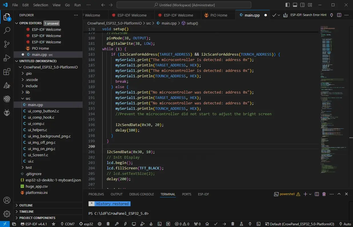

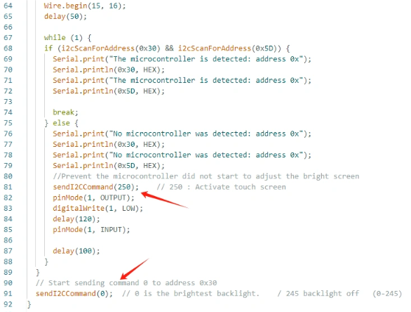

In terms of hardware, we use a microcontroller (STC8H1K28) to control the screen backlight, speaker on/off, and buzzer.
(However, there are other function interfaces that need to be written in the specific code, and you can refer to the complete code provided later.)
Explanation:
  • 0x30 is the I2C address of the microcontroller (STC8H1K28).
  • 0x5D is the I2C address of the touch IC (GT911).
  • sendI2CCommand(0) means sending command 0 to the microcontroller (address 0x30) to instruct it to set the screen brightness to maximum.
For 0 mentioned above, you can replace it with the following values:
  • 0 is the brightest backlight.
  • 0 to 245: The screen brightness will gradually increase to the minimum value
  • 245 represents turning off the screen light
Additional notes:

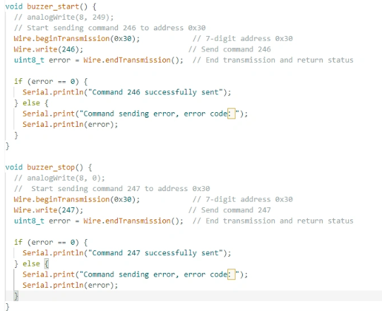

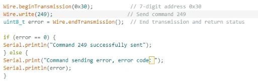

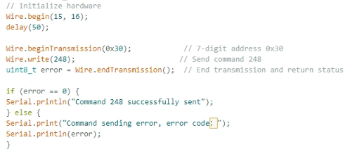

You can also control the following functions by sending other instructions to the microcontroller:
  • It means sending the 248 command to the microcontroller (0x30) to instruct the speaker to turn on.
  • It means sending the 249 command to the microcontroller (0x30) to instruct the speaker to turn off.
  • You can also send command 246 to control the buzzer to turn on, and send command 247 to control the buzzer to turn off.

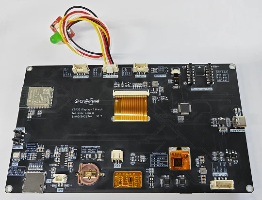

Connect the light bulb at the UART1-OUT interface
UART1-OUT-interface

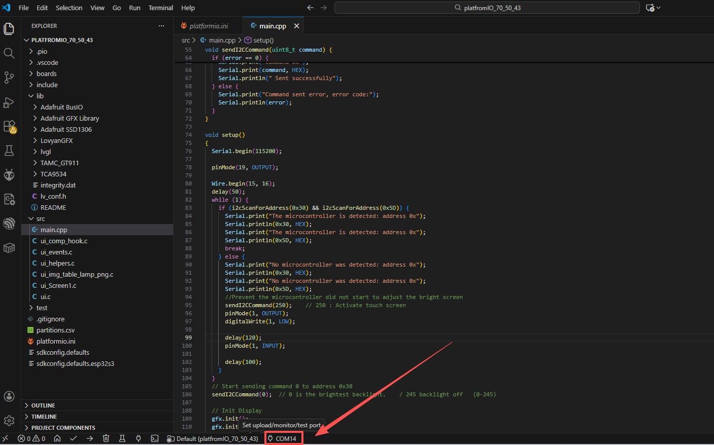

Select the corresponding serial port.

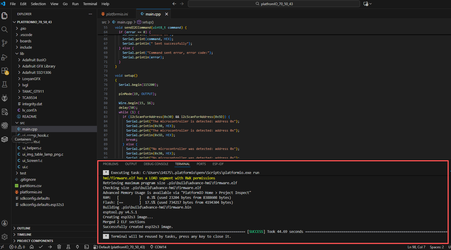

Click this button to build.
Wait for the compilation to be completed.

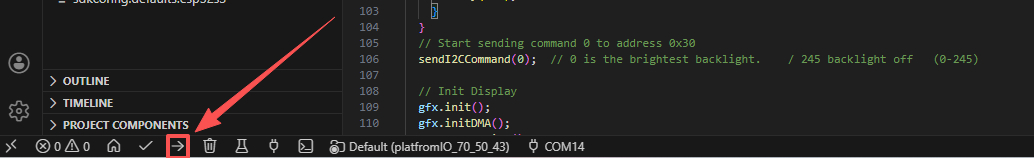

Click to burn.
Wait for the burning process to be completed.

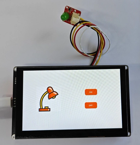

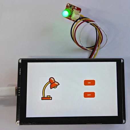

So you can see the UI interface you just designed.
UI interface
You can click the On and Off buttons to control the on/off of the lights
buttons
