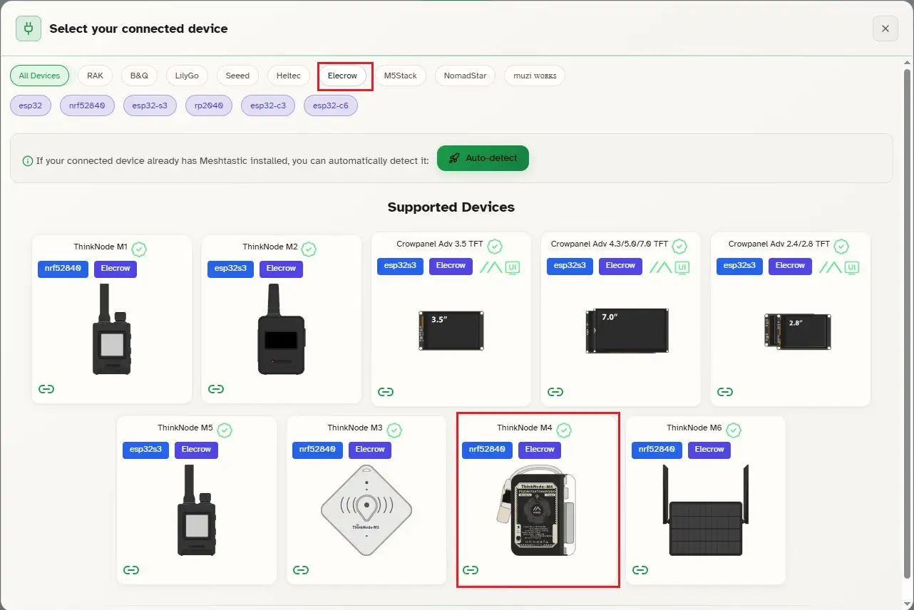

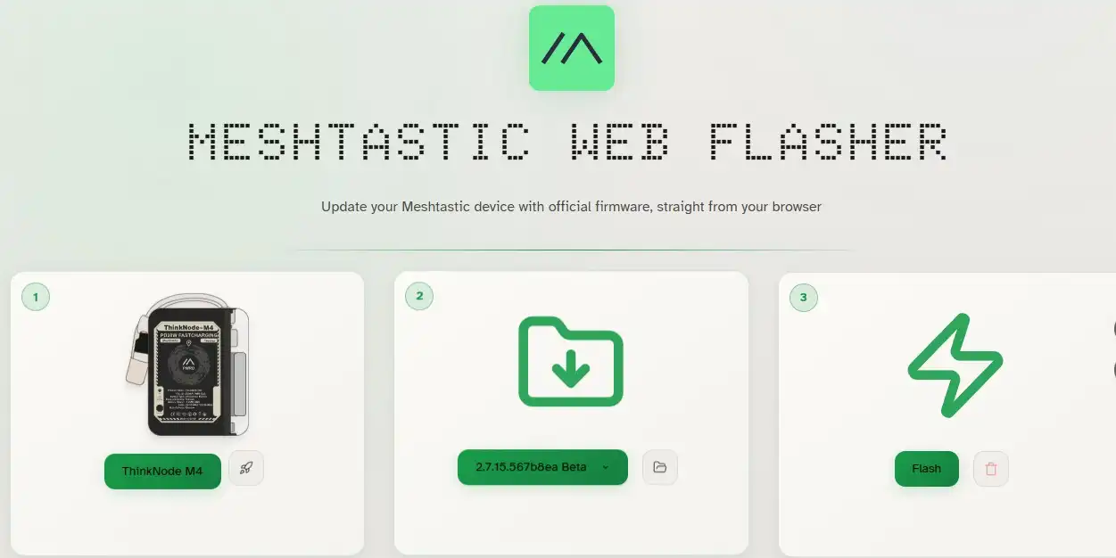

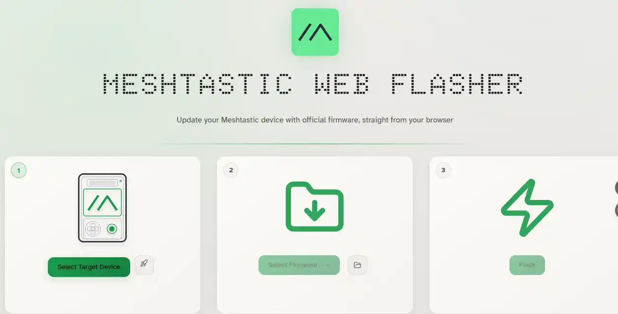

Burning Firmware¶
ClickMeshtastic firmware
1,Select the corresponding firmware.
2, follow the steps to download the firmware.
(M4 firmware will be available shortly)¶

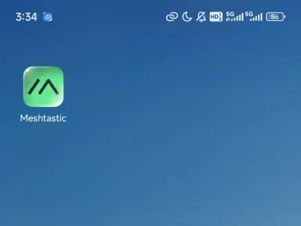

How to obtain the app:
1: Visit the Google Play Store (https://play.google.com/), search for ‘meshtastic’, locate the app, and download it for installation.
2: Visit the official Meshtastic website (https://meshtastic.org/downloads/) and download the software.
Prepare two mobile phones with Meshtastic APP installed and two thinknode M5\M1\M2 devices.
Android App(Version 2.6.30)¶
Open the Meshtastic APP

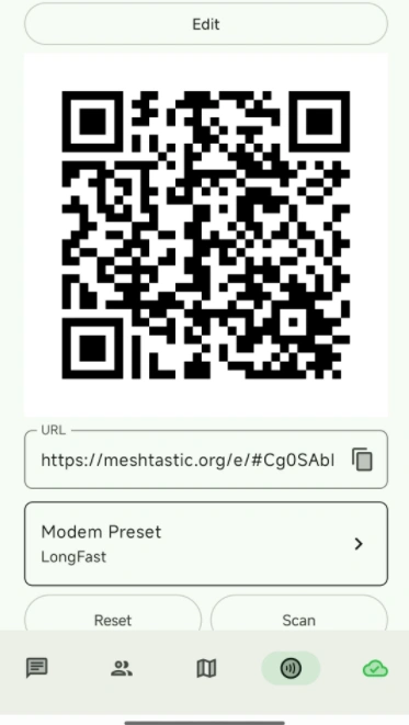

If two devices want to communicate, they need to join to the same channel, this time you need to select the fourth of the five options above, the other end of the phone needs to join to the same channel by scanning the code or entering the link, the channel can be customized name and so on.¶
After joining, the two devices can now chat in the first screen by selecting Group Chat.

5)Go to the information page, select a channel and a QR code will appear, use another device to scan this QR code to enter.
6)Join and start sending or receiving messages.
Burning Firmware¶
1,Select the corresponding firmware. 2, follow the steps to download the firmware.
