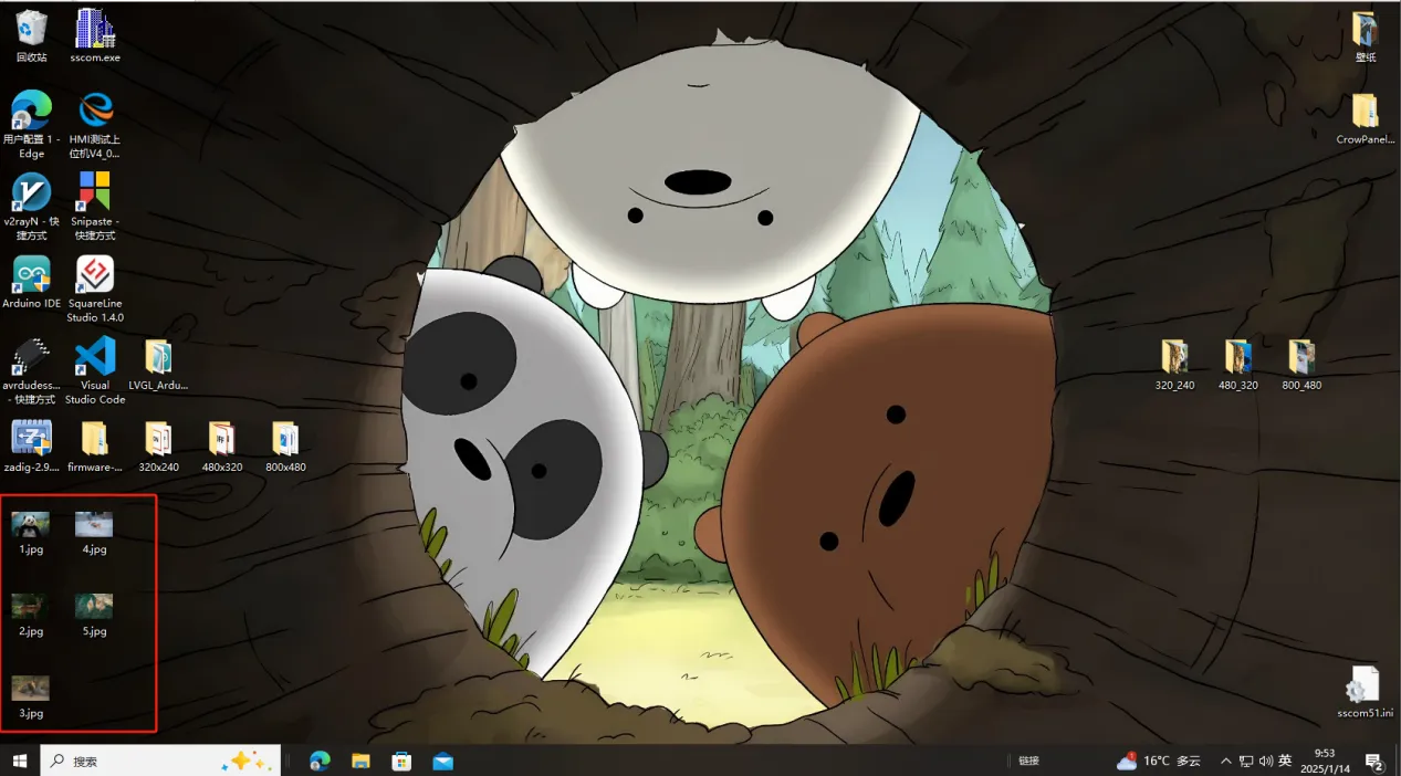

1 Select the photos you want to display on the browser and save them on the desktop (the save path can be customized)

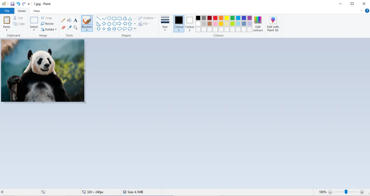

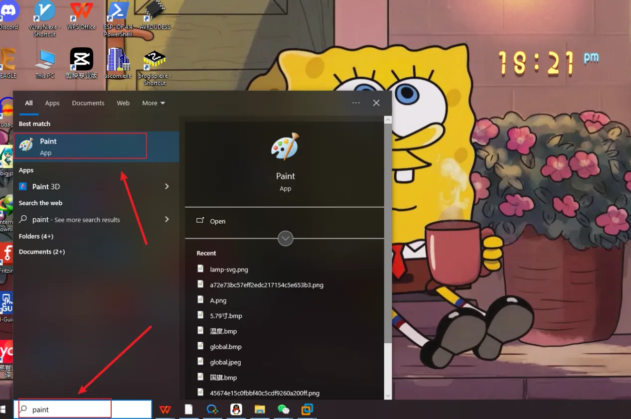

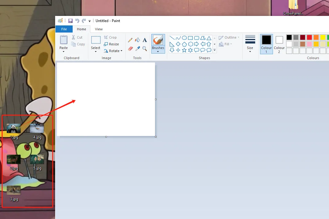

First, open the "paint" tool on the computer.
3

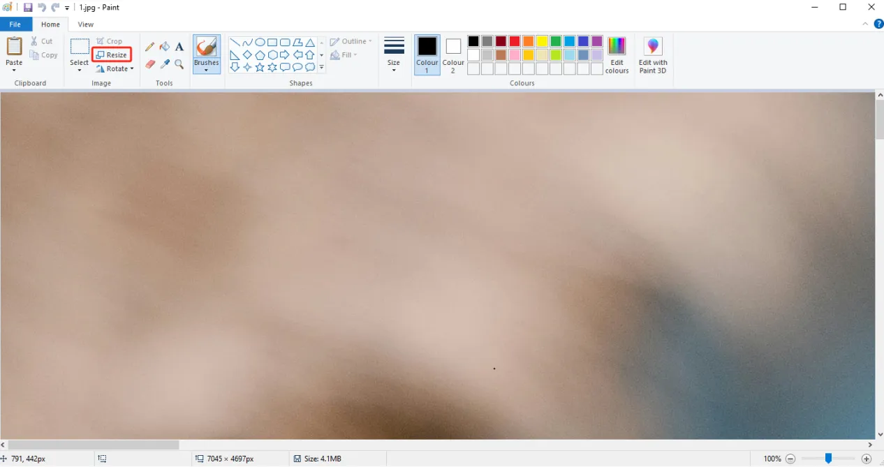

Drag and drop the image into the "paint" tool to readjust the pixels of the image
(Images can be uploaded to the browser and selected according to everyone's preferences)

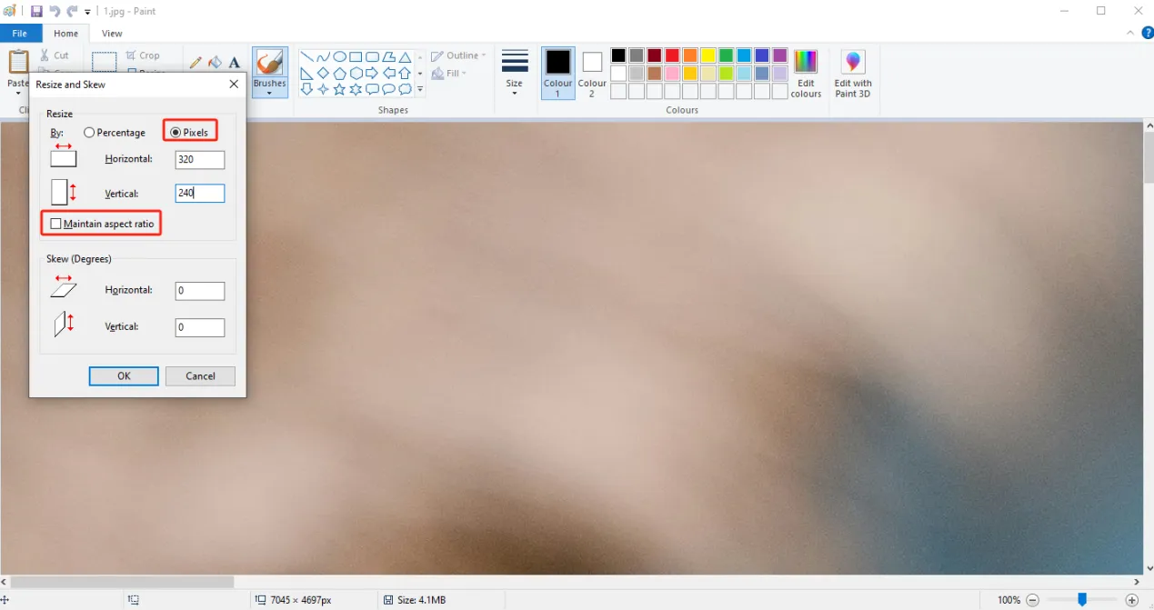

4
5
Adjust the pixel to 2.4-inch screen resolution: 320x240
(If you are using a different size, please set the correct resolution)
Can be referred to:There are resolutions of different sizes as references above. (Second point)

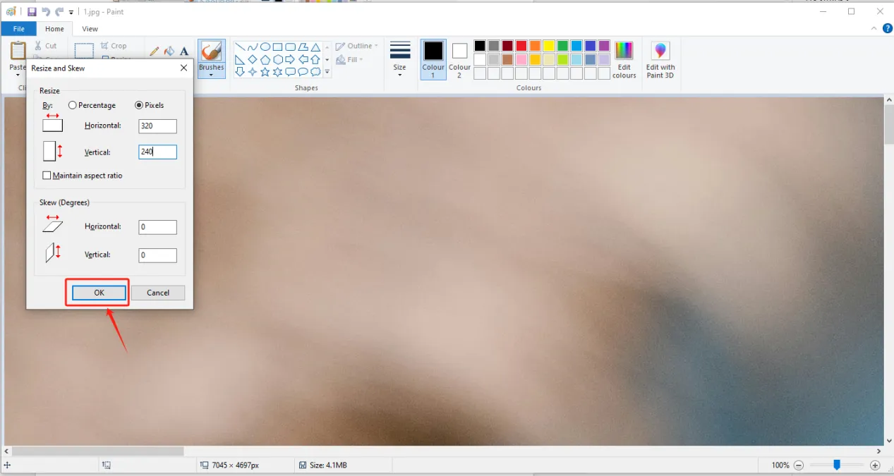

Click confirm
7
Adjust the resolution of the image as shown in the picture

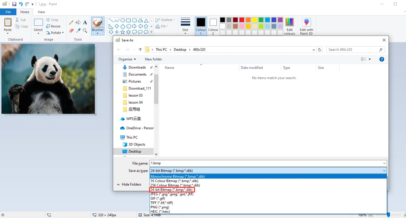

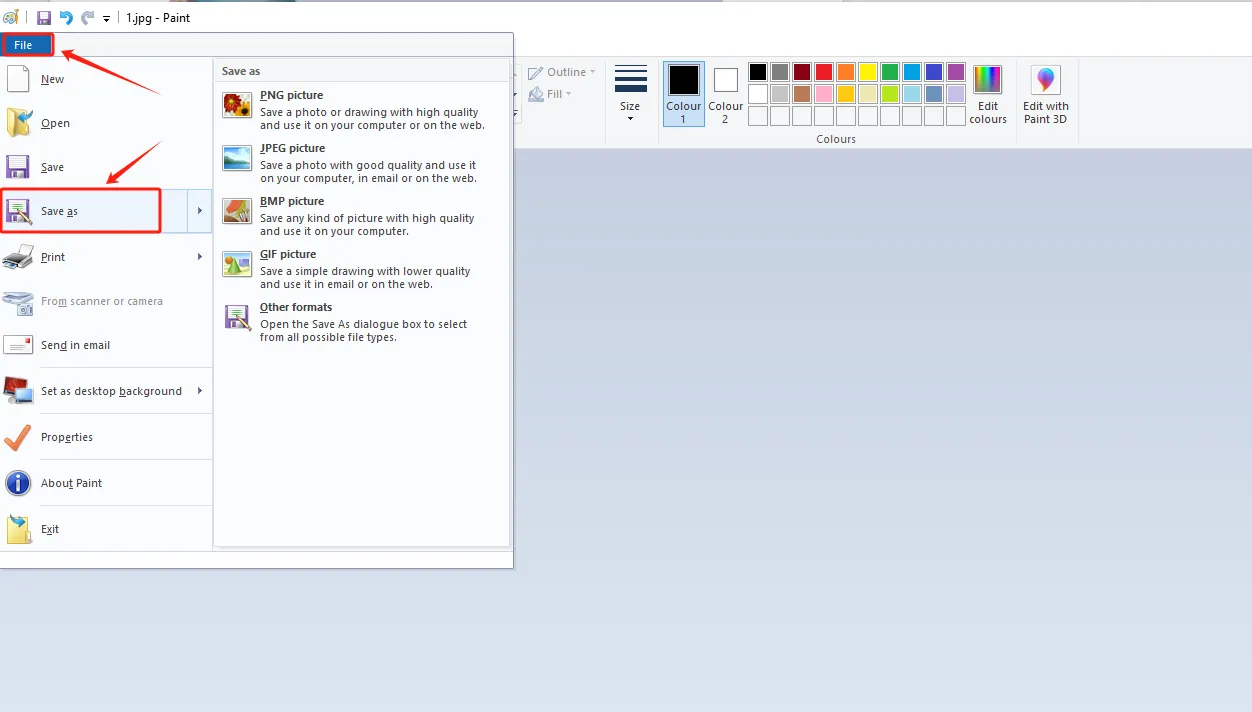

Save in BMP format (must have a 24 bit image depth)
10

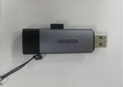

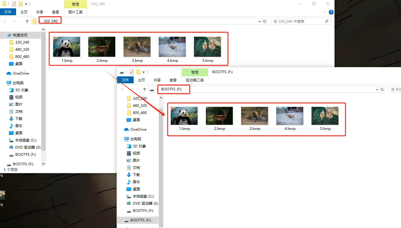

Insert the SD card into the card reader
11

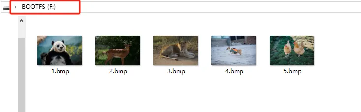

Open the SD drive, copy the modified image to the SD drive and save it
12
Exit the SD card and remove the SD card

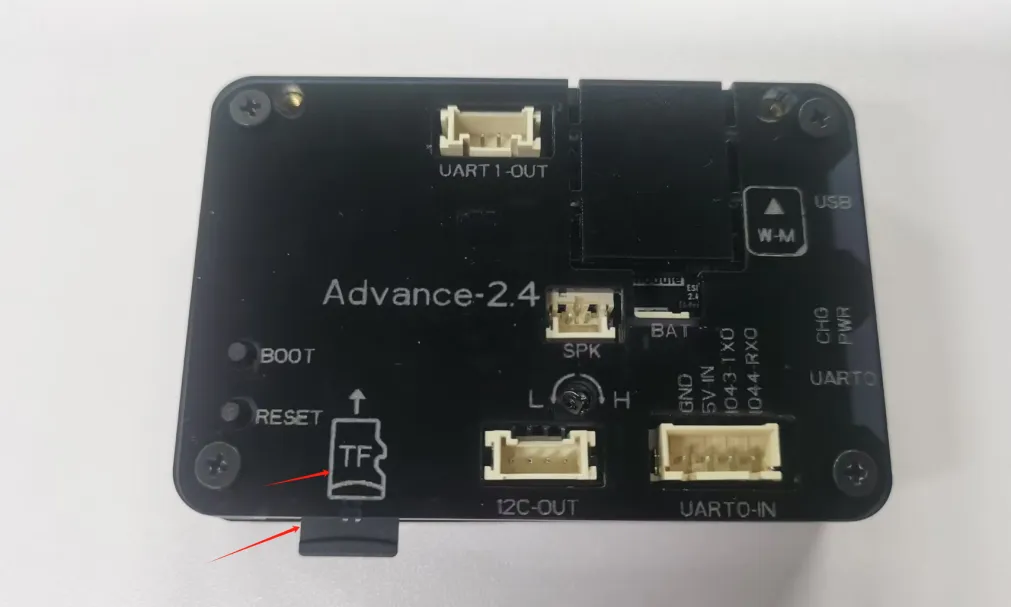

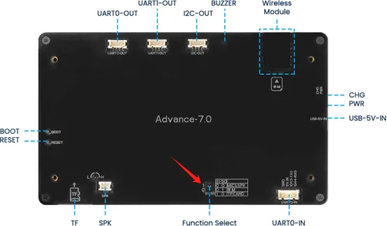

3 Insert the SD card containing this saved image into your CrowPanel ESP32 Advance HMI
13
(2.4 inch, 2.8 inch, 3.5 inch products can be directly inserted for use)

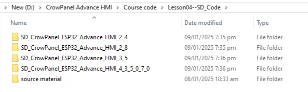

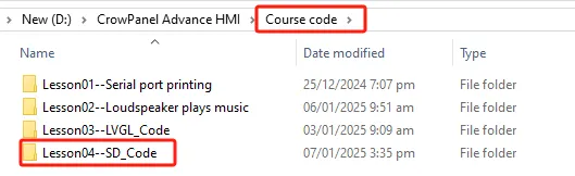

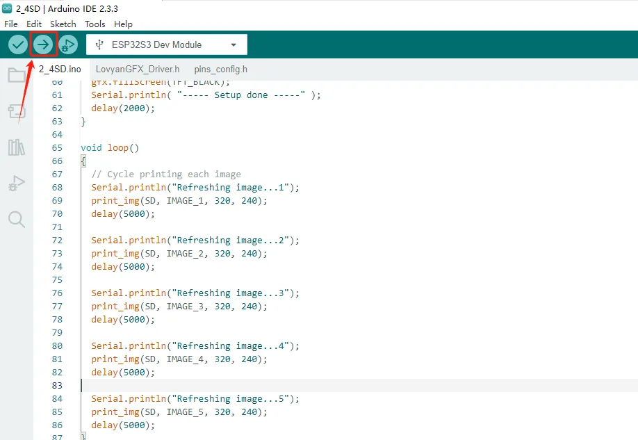

4 Open the code we provide, and you only need to modify the path and name of the image you saved
15
16

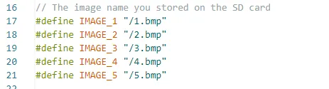

Modify the path of the image you saved
17
Here, my path is the five images in the current path on the SD card
So the path of my image is the current path "/" plus the image name (1. bmp)
18

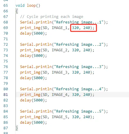

Then display the image in the loop and set the resolution size
(different sizes have different resolutions)
19

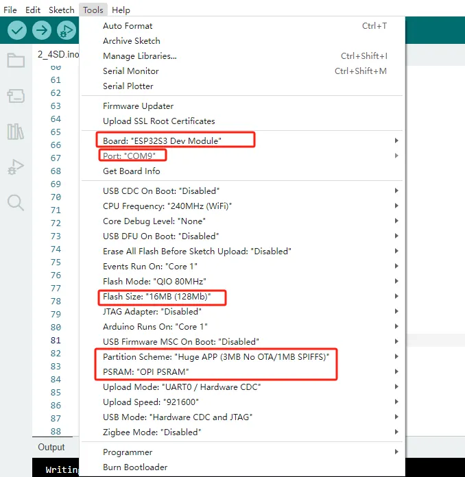

5 Configure the runtime environment and burn code
(Before burning, please replace the relevant library files according to different sizes.
How to replace, details in Lesson 2)

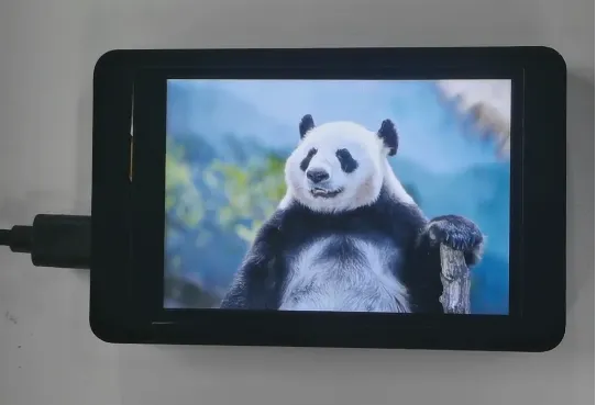

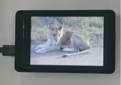

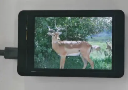

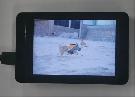

6 Phenomenon display
22
23
24
25
26

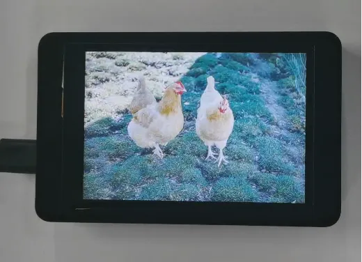

The five photos I saved on the SD card will be displayed in a loop.
