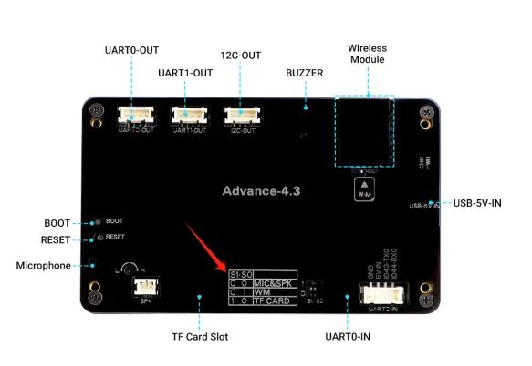

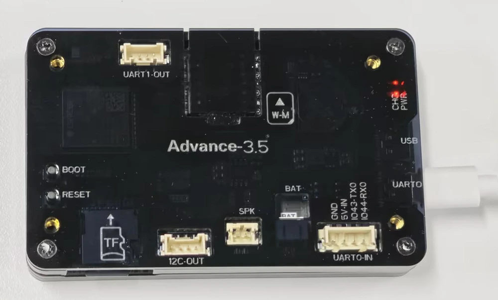

1 Introduce product ports

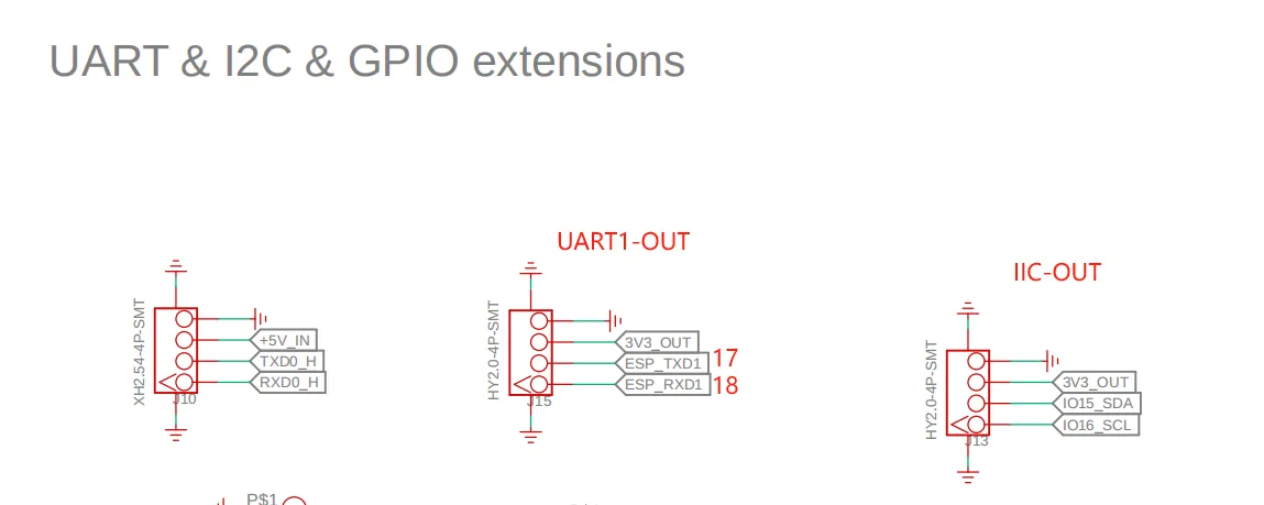

USB interface: used for power supply, serial communication, and automatic programming.
UART0-IN interface: supports power supply, serial communication, and entering manual burning mode by pressing BOOT+RESET; Other functions are consistent with the USB interface.
UART0-OUT interface: used for external power supply and serial communication.
UART1-OUT interface: uses soft serial port and supports configuring IO function.
I2C-OUT interface: connects RTC chip, extended IO chip (for screen backlight, touch screen reset, power amplifier pin control) and wireless module, only supports I2C communication.
This is the layout diagram of the 3.5-inch V1.0 model.

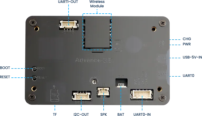

This is the layout diagram of the 3.5-inch V1.2 model.

2 Taking UART1-OUT interface and IIC-OUT as examples
Next, taking the external light bulb connected to the UART1-OUT interface and the temperature and humidity sensor connected to the IIC-OUT interface as an example. The temperature and humidity sensor needs to support IIC communication. The peripherals connected to the IIC interface are all like this.

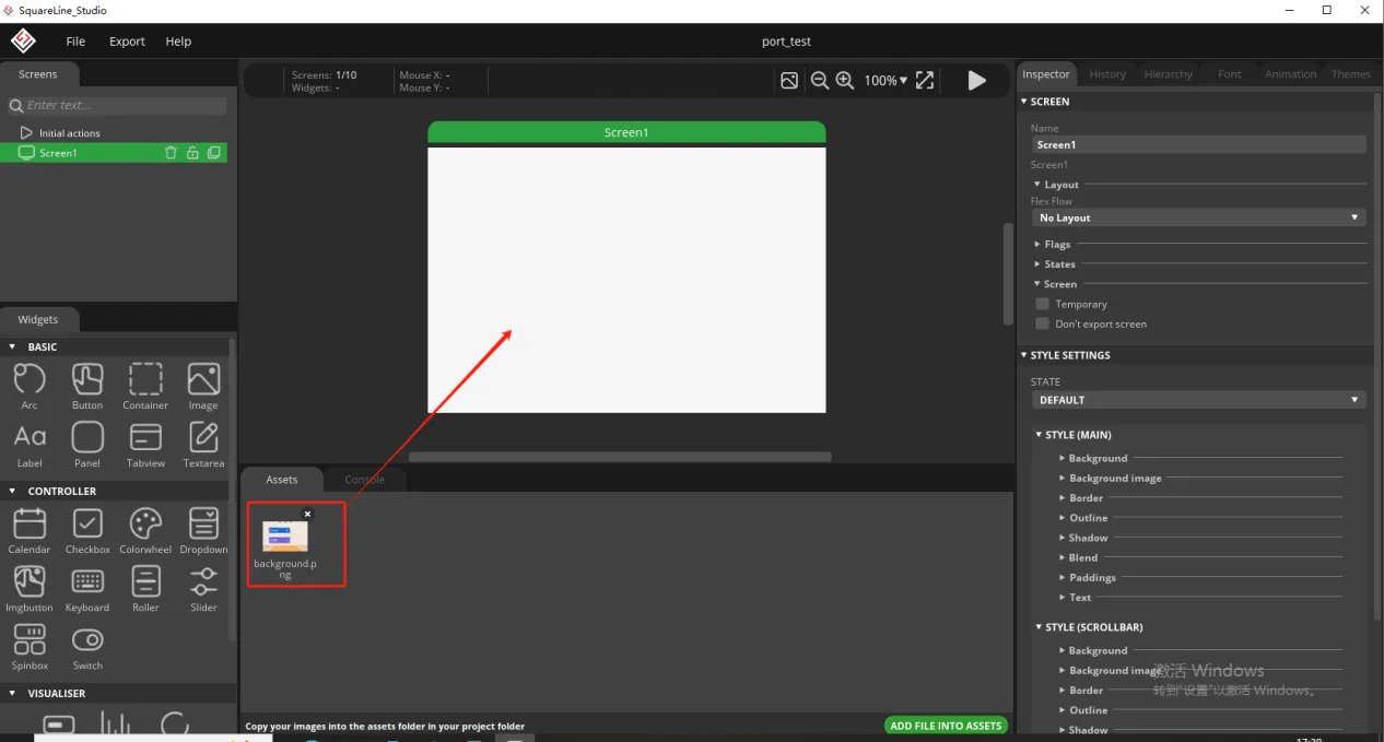

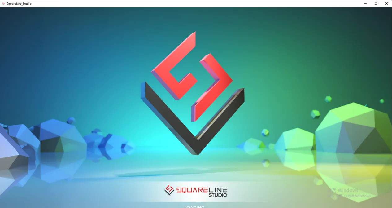

Open SquareLine Studio. If you haven't installed it, you can review the introduction of LVGL in Lesson 3.
1_4

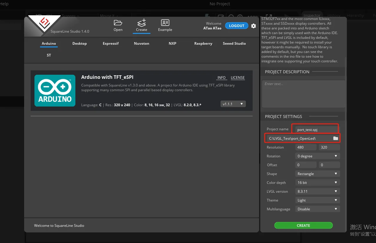

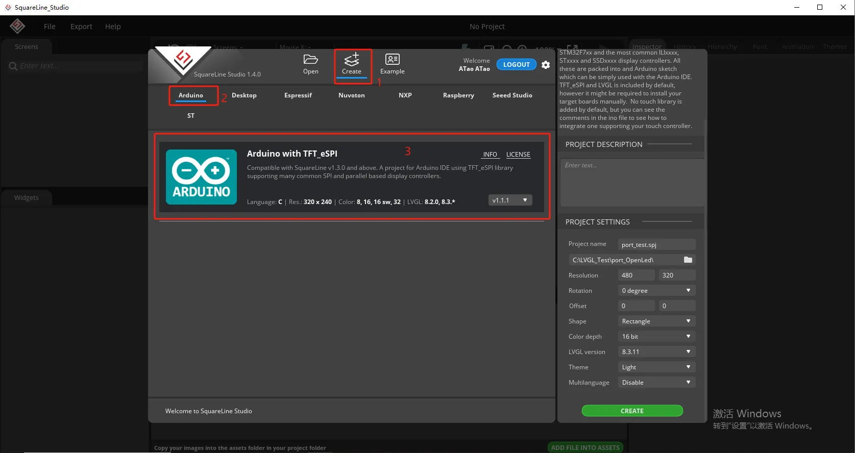

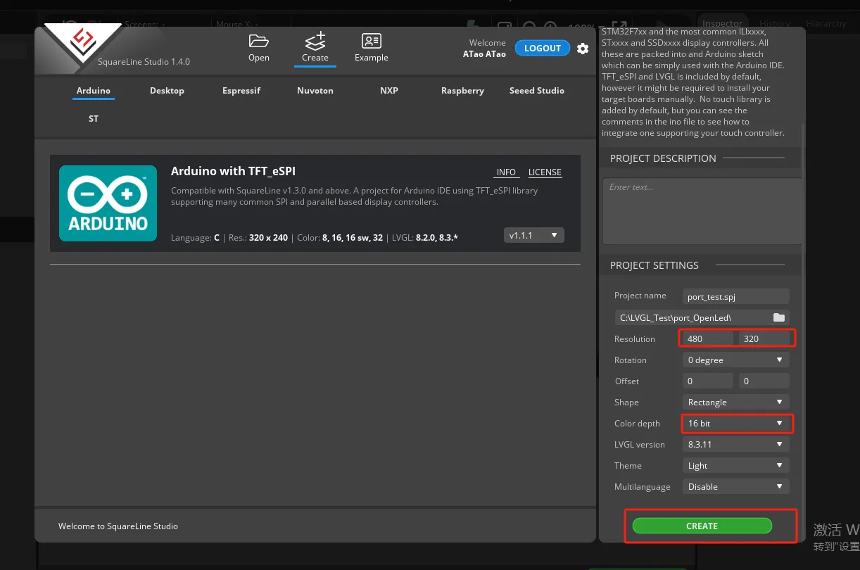

Create Arduino project
1_5
Modify the file name and file storage path according to your needs (customization is sufficient)
1_3
Modify the appropriate resolution based on the different sizes you are using.
Finally, click on 'Create' to proceed.
1_6

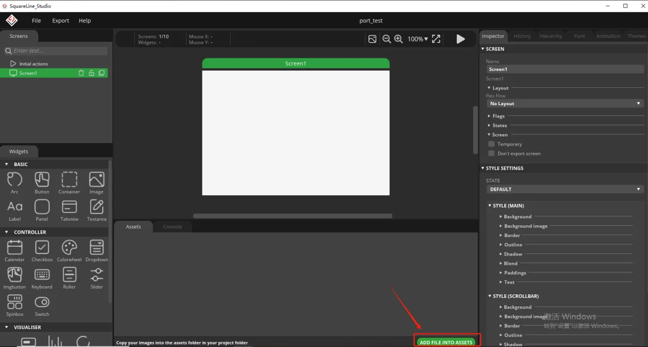

1_7

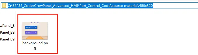

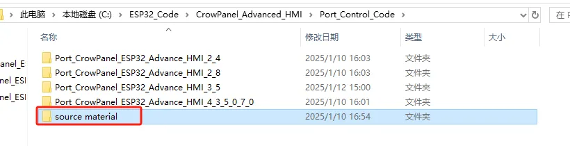

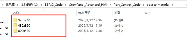

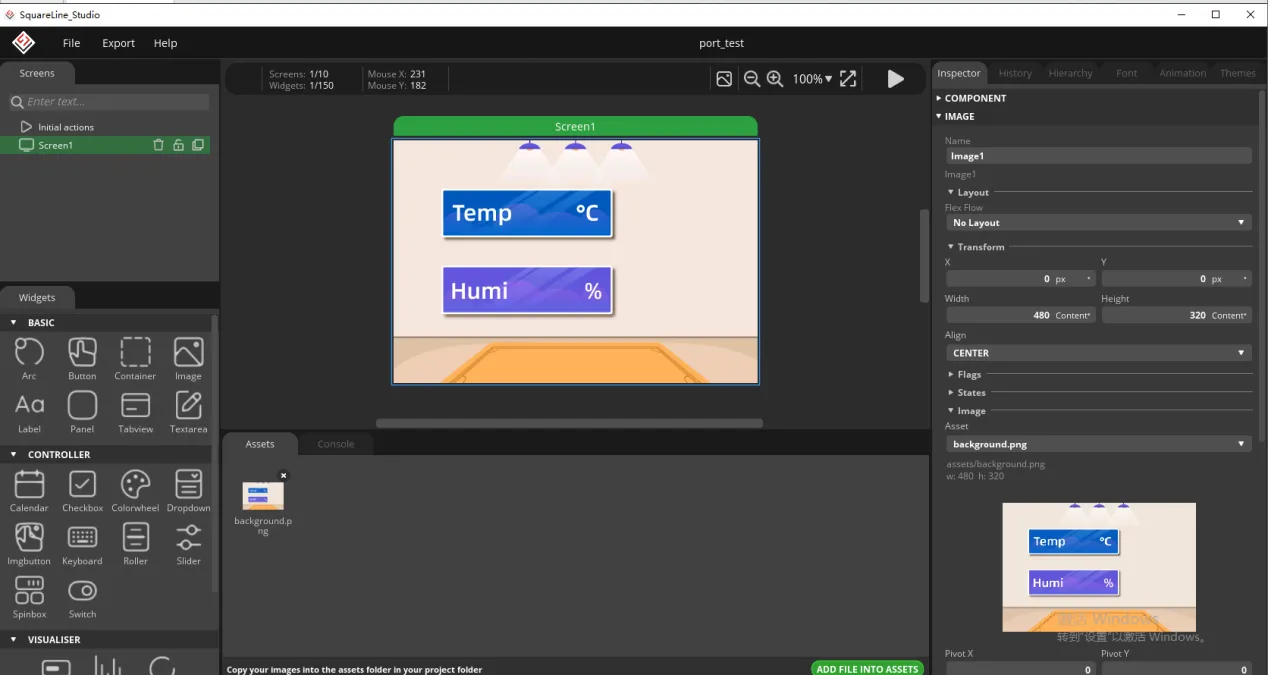

Add the background image we provide based on the resolution required for the size you are using (choose different resolutions for different sizes, refer to the resolution size used for different sizes in Lesson 3)
1_7_1
1_12
1_8
1_9
Add background image to the box.
1_11
1_13

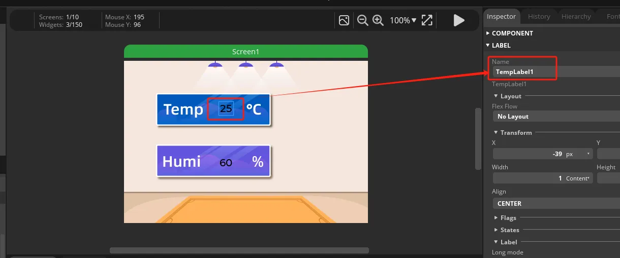

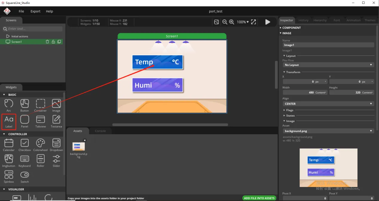

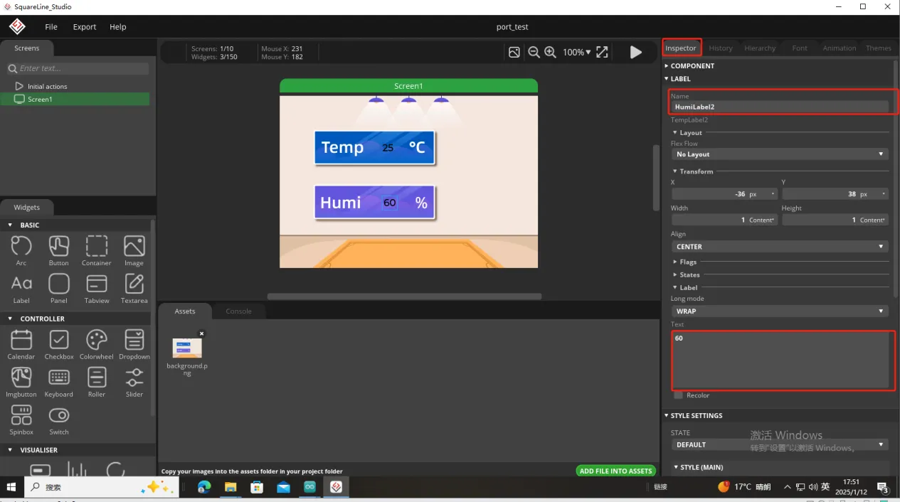

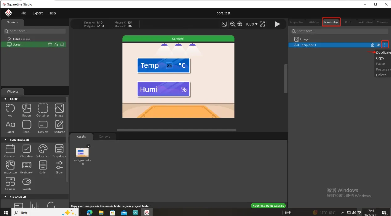

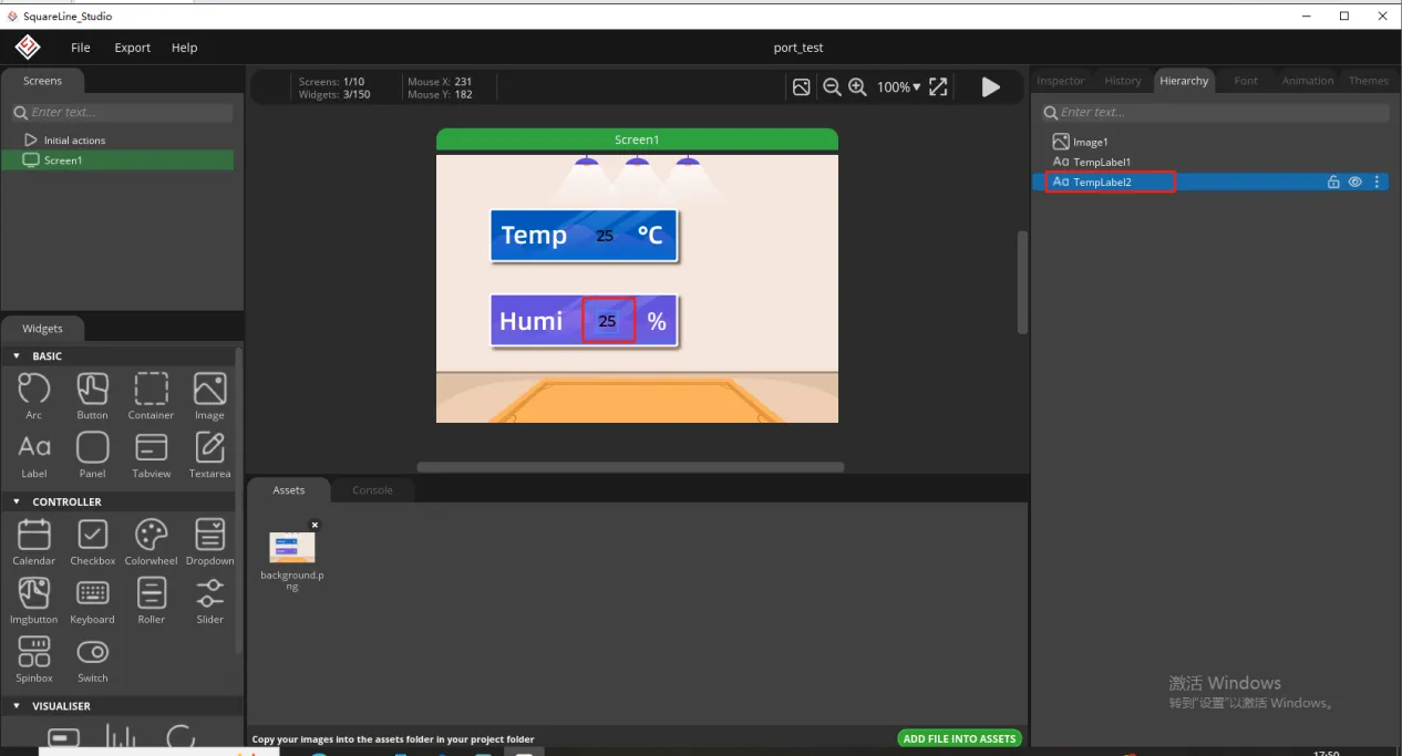

Since we need to display the temperature and humidity values on the screen, we need to add text in the two boxes for temperature and humidity.
1_16

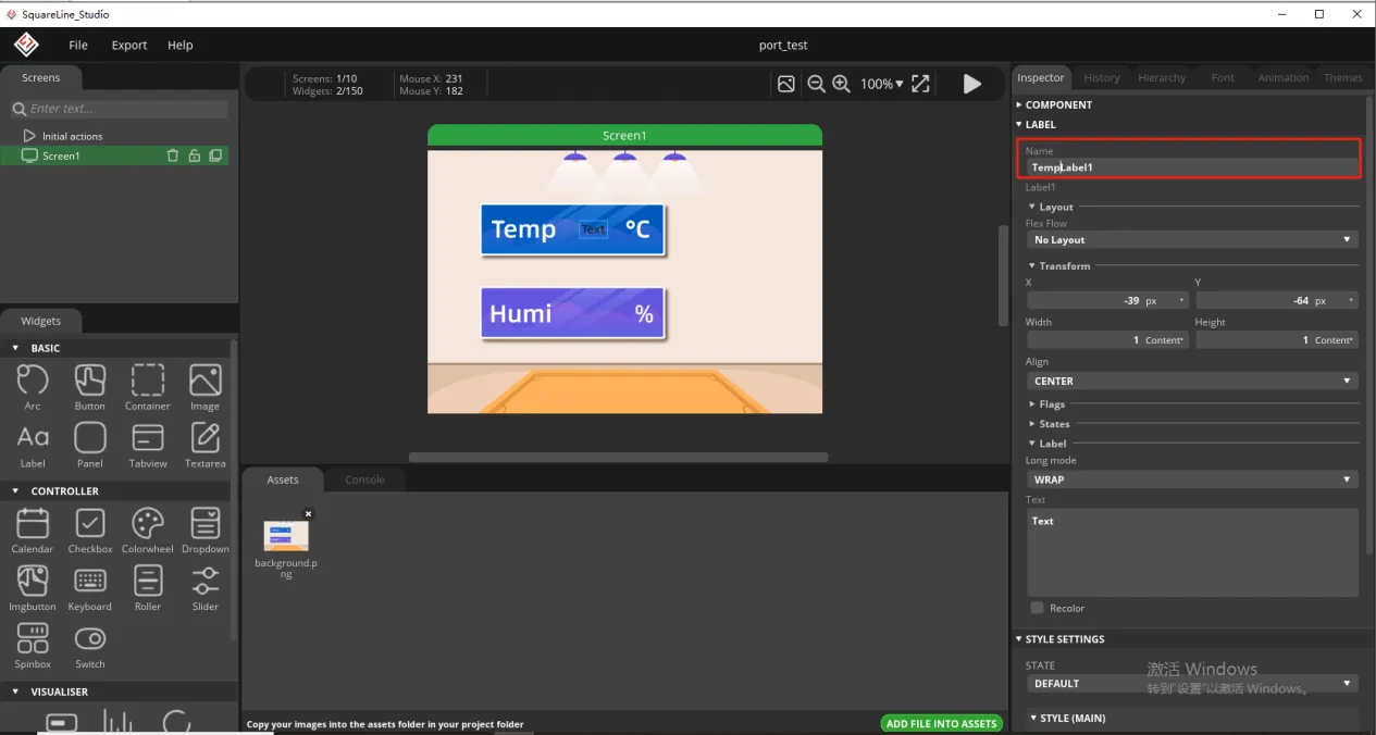

To distinguish between the other text labels that need to be created next, give this label a name to distinguish it.
1_14
And fill in a default temperature value
1_15

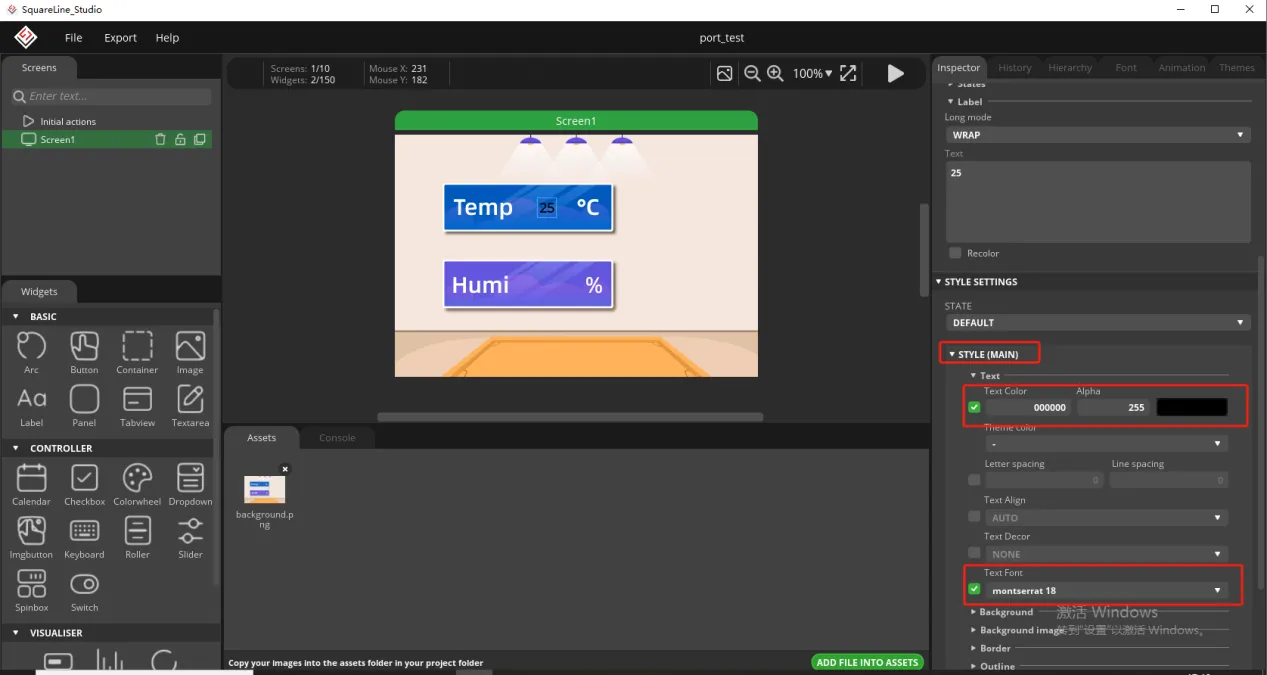

Of course, you can also set the font color and font size here
1_18

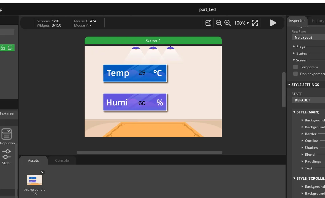

Copy the label just made and display the humidity value
1_20
1_17
Follow the above steps to modify the humidity label
1_19
In this way, the display of temperature and humidity is completed.

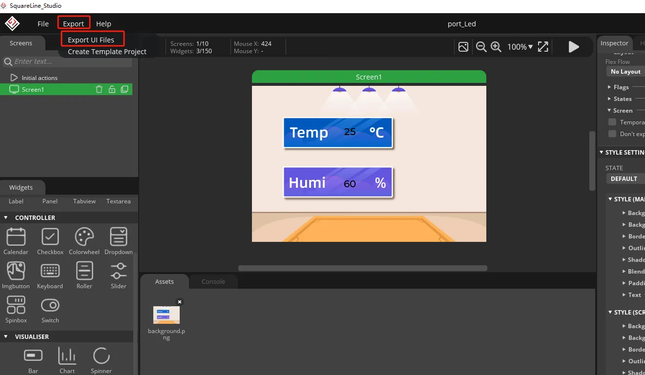

So, the UI interface we need is completed.
1_22

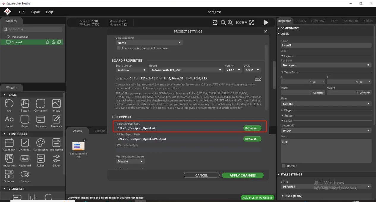

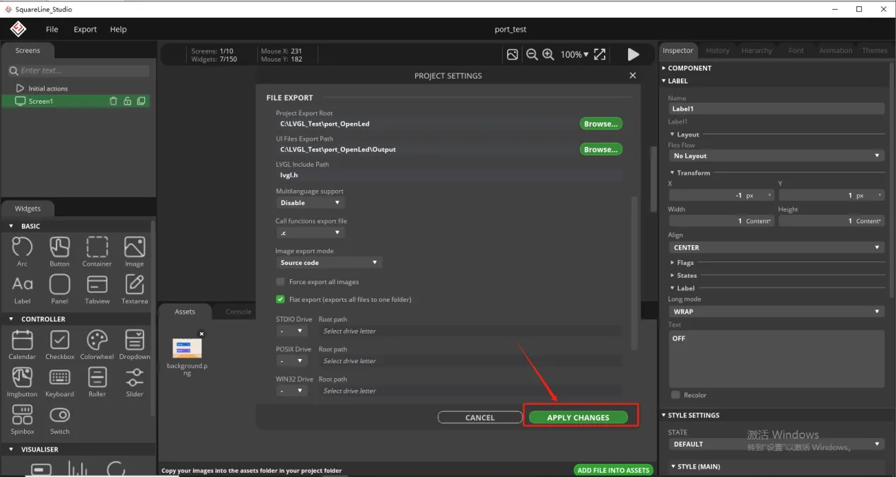

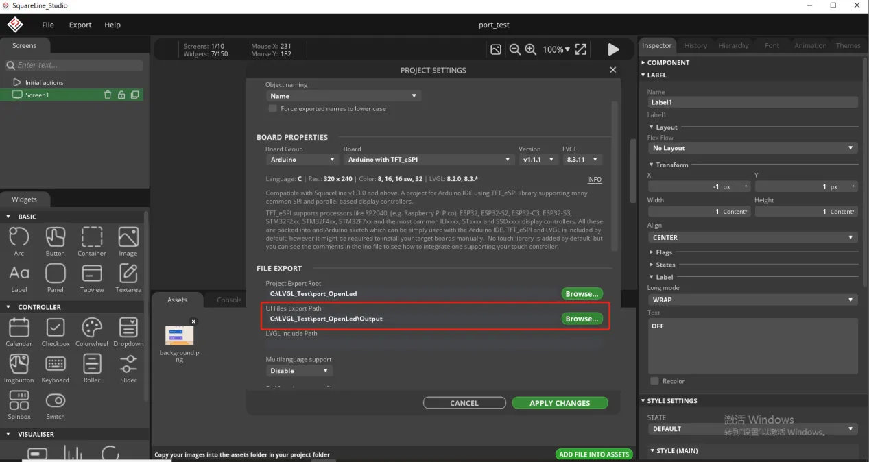

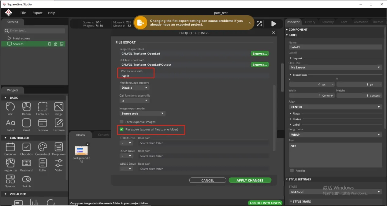

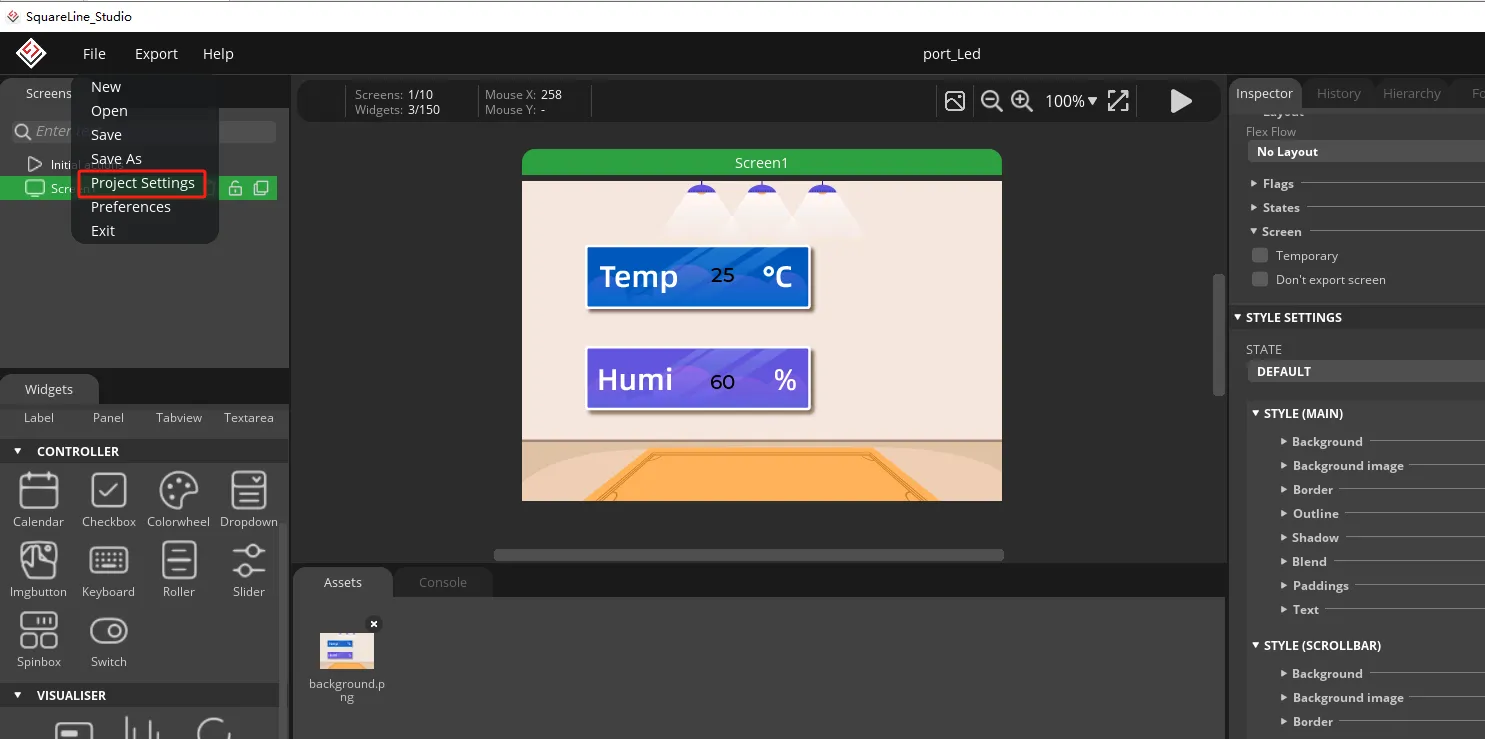

Click on Project Setting
1_24
Set the file export path and customize the path
1_21
But here, you need to create an Output folder in the path above to receive the exported UI files.
1_23
Fill in lvgl. h and select Flat export.
1_26
Finally confirm the settings
1_28

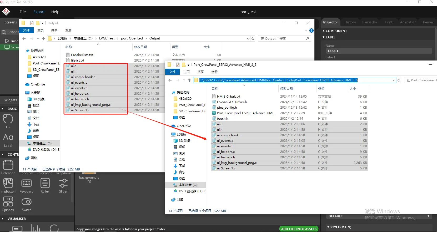

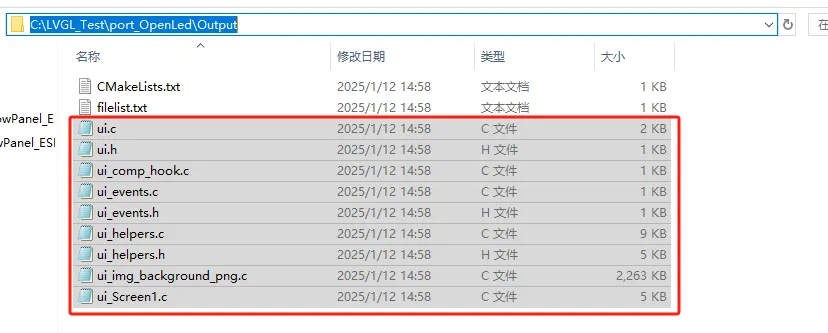

Export the designed UI interface file
1_25
Go to the Output folder you just set up and copy the UI files you generated.
1_27
Paste it into the code file you need to open (here I will introduce the 3.5-size code as an example).
1_29

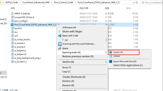

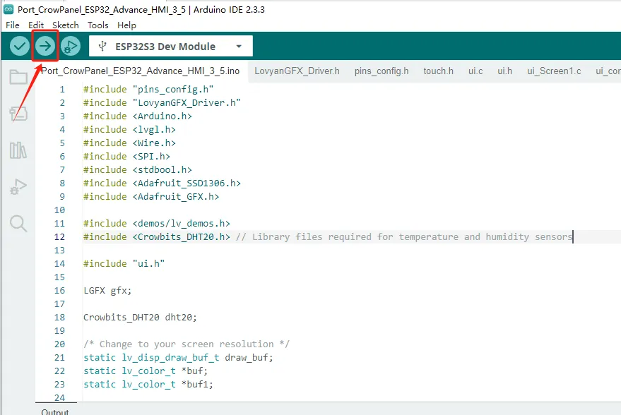

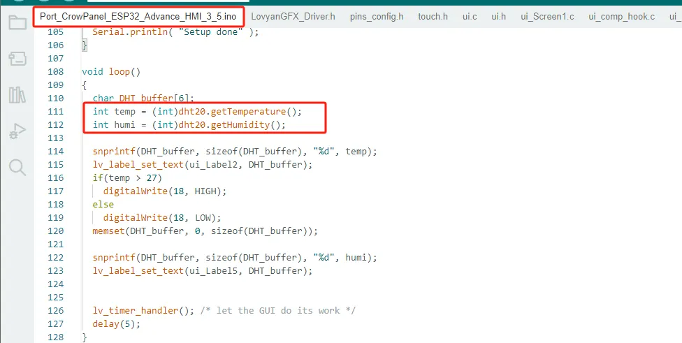

Then use Arduino IDE to open the ino file in the folder
1_30

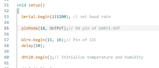

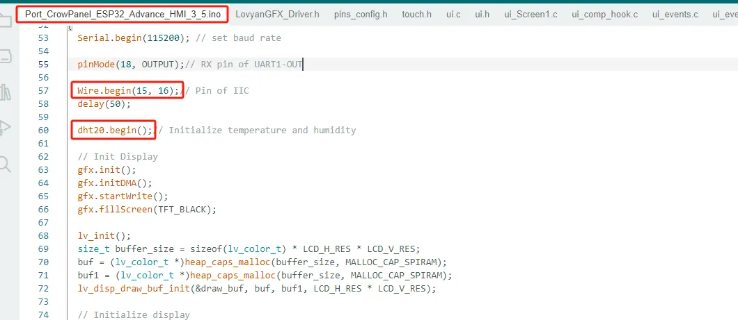

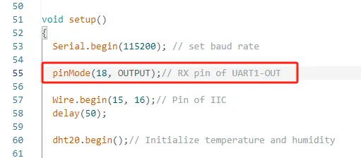

Initialize UART1-OUT pin, IIC pin, and temperature and humidity sensor
1_33

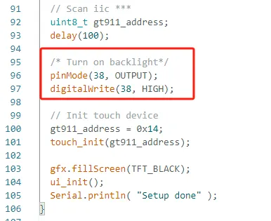

Turn on the screen backlight to enable the screen to display
1_31
Previously, pin 18 was set as the output mode, and the UART1-OUT interface was connected to the light bulb. By controlling pin 18, the light can be controlled.
The brightness and darkness of bubbles.
1_32
Because the temperature and humidity sensor is connected to the IIC interface, it is necessary to initialize pins 15 and 16 of the IIC and initialize the temperature and humidity sensor.
1_34

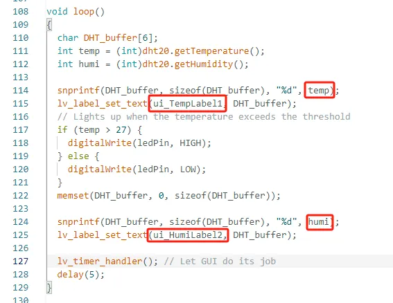

And define two variables to receive data collected by temperature and humidity sensors
1_36
And display the value on the label you previously designed
1_38
1_35
1_37

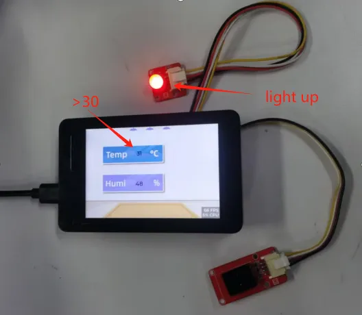

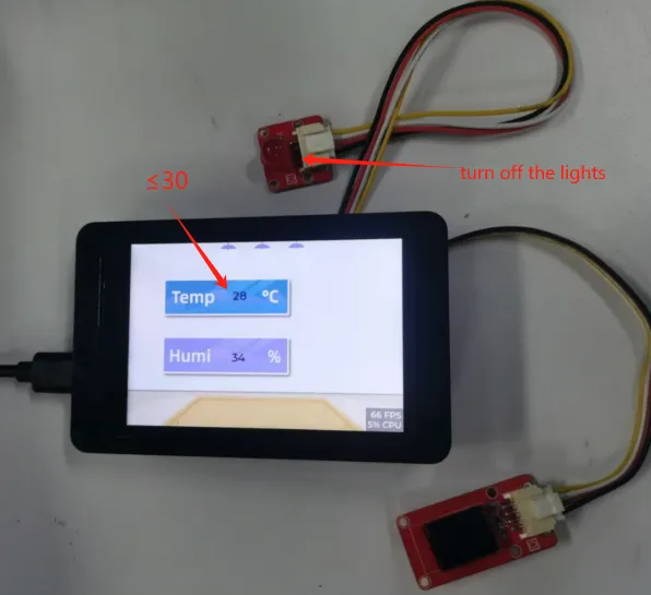

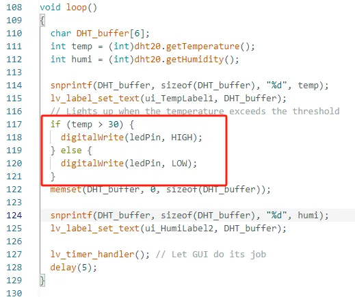

If the temperature value collected by your temperature and humidity sensor exceeds 30 ℃, the light bulb will automatically light up; If the temperature drops below 30 ℃, the light bulb will automatically turn off. (You can modify the temperature threshold yourself, this is only for the convenience of observing the results)
1_39

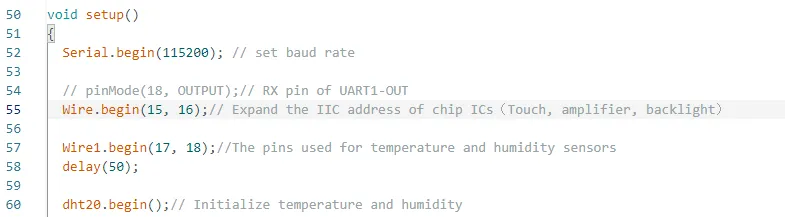

Special Reminder:(The following applies only to 2.8-inch and 2.4-inch products)
The IIC address of the 2.8 and 2.4 touch driver ICs is 0x38, and the IIC address of the DHT20 temperature and humidity sensor is also 0x38. When the DHT20 temperature and humidity sensor is connected to the IIC-OUT interface for use, the two addresses conflict, causing abnormal device usage. The DHT20 temperature and humidity sensor will no longer work, but will ensure the driving of the touch IC.
So in order to make the DHT20 temperature and humidity sensor work, we can connect the DHT20 temperature and humidity sensor to UART1-OUT.
Special note: The UART1-OUT interface allows the use of two or fewer IO interfaces, namely 17 and 18 pins, for your convenience. For example, when connecting a light bulb, 18 pins can be used to receive the initiated control signal. For example, doing digital input/output and analog input/output. There are also some infrared receivers, buzzers, and lights that can be connected. The premise is that you should not use more than 2 IO ports, such as SPI, which requires four IO ports to control and cannot be used.
2.4" 2.8"
1_40
1_41
And when initializing the temperature and humidity sensor, specify the IIC pin used for initializing the temperature and humidity sensor.
1_42

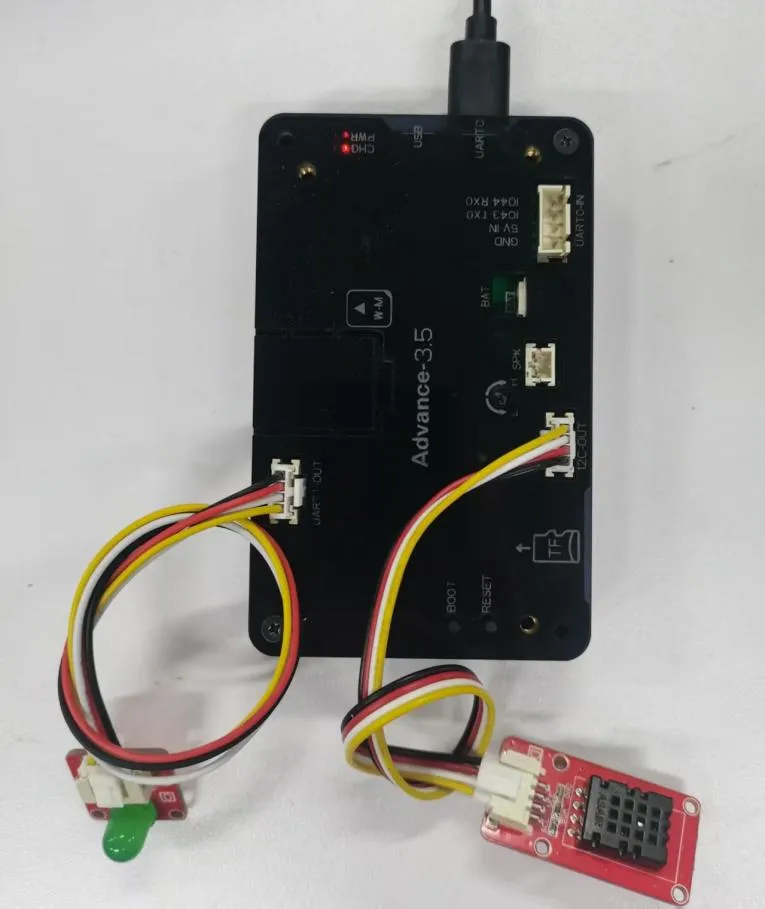

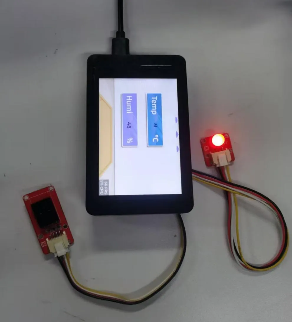

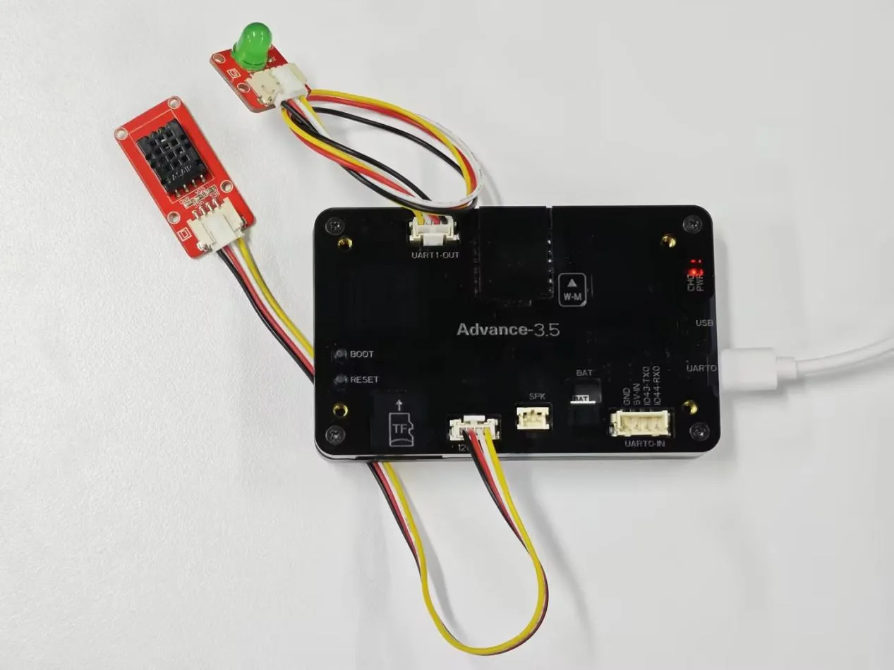

4 Hardware connection
UART1-OUT connection bulb
IIC-OUT connection to DHT20 temperature and humidity sensor
This is the hardware connection diagram for the 3.5-inch V1.0 version.
1_44
This is the hardware connection diagram for the 3.5-inch V1.2 version.
1_44_1

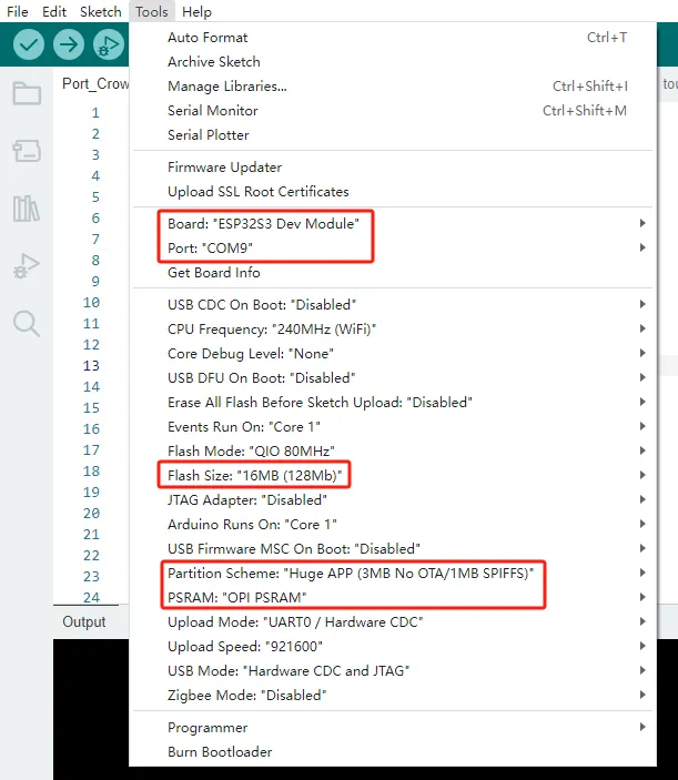

5 Configure the environment, upload code, and view phenomena
Click the link below to download the complete code:
V1.0:
https://github.com/Elecrow-RD/CrowPanel-Advance-3.5-HMI-ESP32-S3-AI-Powered-IPS-Touch-Screen-480x320/tree/master/example/V1.0/Arduino/lesson-05
V1.2、V1.3:
https://github.com/Elecrow-RD/CrowPanel-Advance-3.5-HMI-ESP32-S3-AI-Powered-IPS-Touch-Screen-480x320/tree/master/example/V1.2_and_V1.3/Arduino_Code/lesson-05
(Before uploading the code, please replace the relevant library files. Please refer to Lesson 2 for instructions on how to replace them.)
Configure the operating environment according to the guidance.
1_43

Phenomenon display
1_48
1_45
1_47
