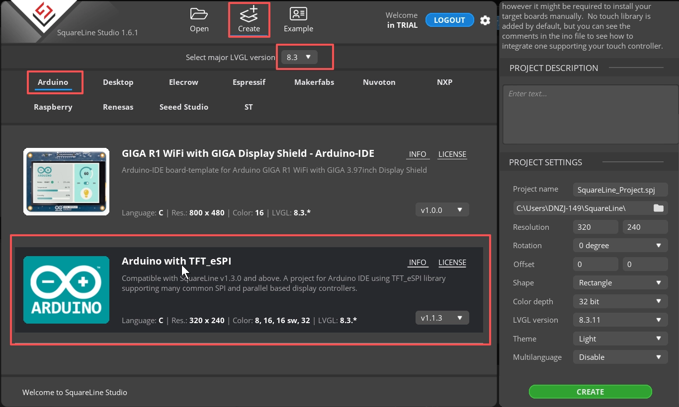

  1. Open the SquareLine Studio and create a project. Select "Arduino"->"Arduino with TFT_eSPI".
    6
    Note:
    When select the Arduino framwork, there's only one option "Arduino with TFT_eSPI". By choosing this, the squareline studio will generate a template code suitable for the TFT_eSPI library. However, squareline studio not only supports the TFT_eSPI library, it supports a variety of libraries to suit different hardware and application needs. For example, Adafruit_GFX library, LovyanGFX etc.

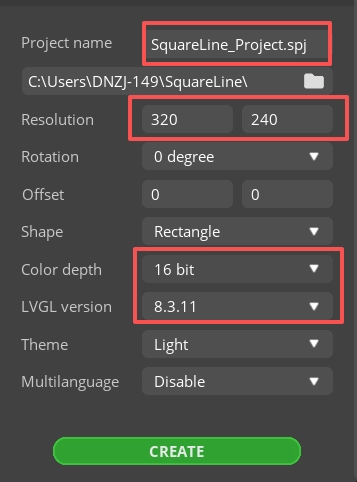

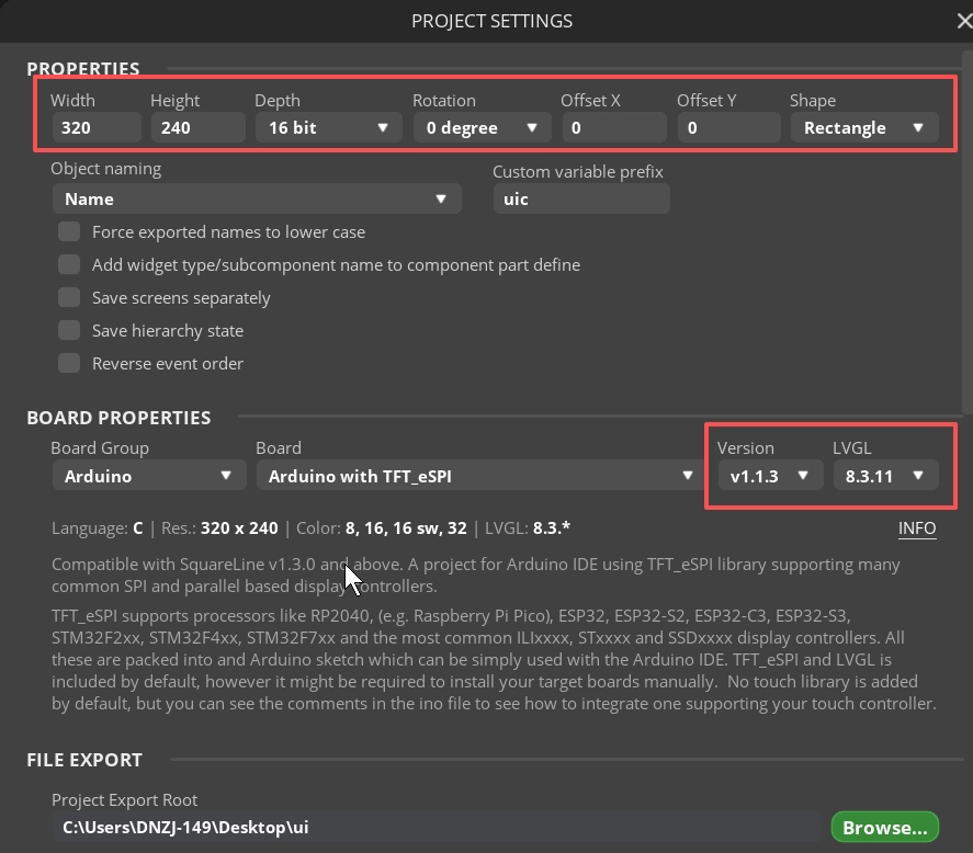

  2. Set the name of the project, set the screen resolution to 320*240, set the color depth to 16bit, and keep other default settings. After setting, click CREATE to create the project.
    7

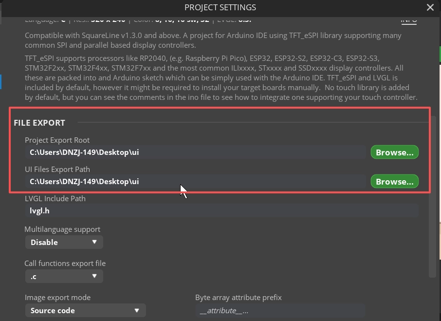

  9. Export UI files.
    SLS-UI-25
    8
    9
Then click "APPLY CHANGES".
SLS-UI-27
SLS-UI-28
SLS-UI-29

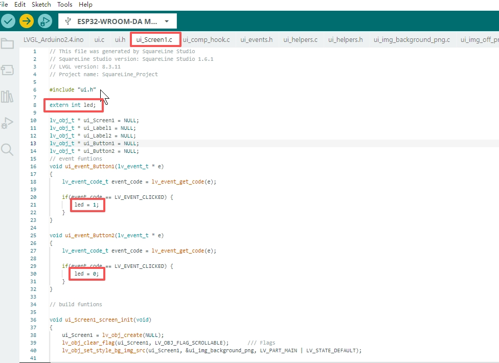

  1. Modify the button event code.
    10
First, define a variable in the ui_Screen1.c file to store the status of the LED. In the main program, the LED light is controlled to turn on and off by judging the status of this variable.
Then replace the function calls inside the Button1 and Button2 functions with the functions for turning the LED on and turning the LED off

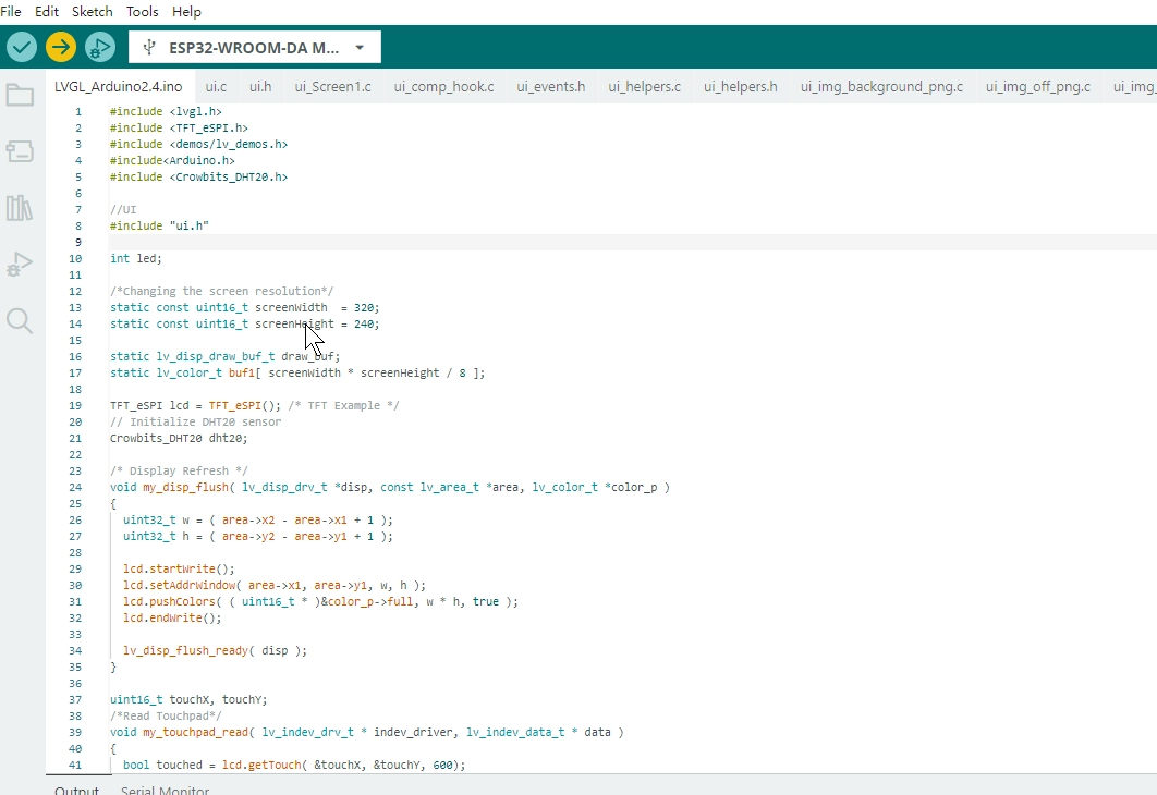

Build the Project with Arduino IDE
Get Started with Arduino IDE
Install Libraries
#include <lvgl.h>
#include <TFT_eSPI.h> //screen driver library
#include <Arduino.h>
#include <Crowbits_DHT20.h> //Temperature and humidity sensor library
//UI
#include "ui.h"
  • #include <Arduino.h>: contains the Arduino core library, providing commonly used functions and data types.
  • #include <lvgl.h> and #include <TFT_eSPI.h>: are libraries for graphical interfaces, used for display control and drawing.
  • "ui.h": is a custom header file that contain UI-related functions or definitions.
  • "Crowbits_DHT20.h": to read data from the DHT20 temperature and humidity sensor.

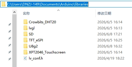

Copy the library you downloaded into this directory/path.

Upload the Code
  1. After completing the installation of the ESP32 board according to "Get Started with Arduino IDE" and the installation of the library according to "Install Libraries", open the program and connect the ESP32 HMI 2.4-inch to the computer via a USB-C cable.
  2. Select Board: click "Tools" -> "Board" -> "esp32" and select "ESP32-WROOM-DA Module"(select ESP32 Dev Module also be good)
    select-board
  3. Select Port
    select-port
  4. Upload the code
    upload-the-code

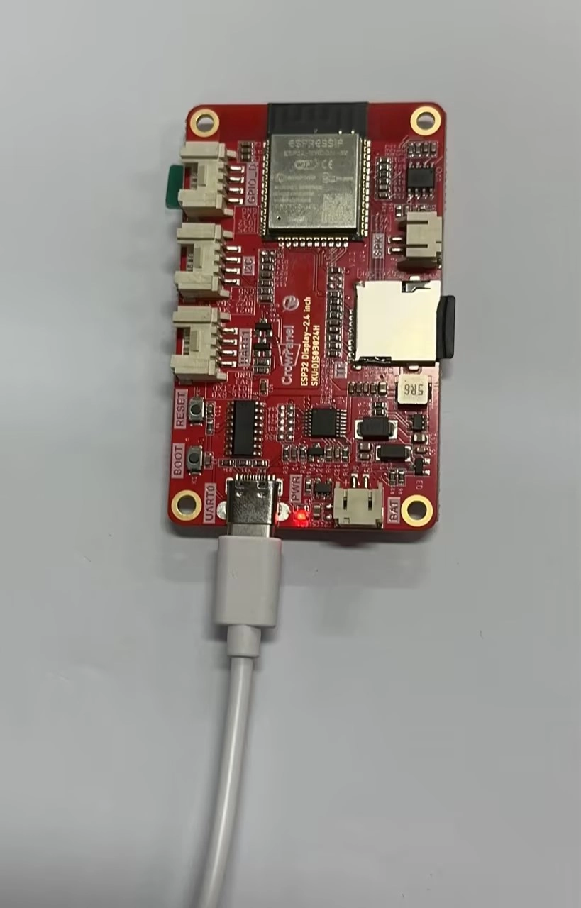

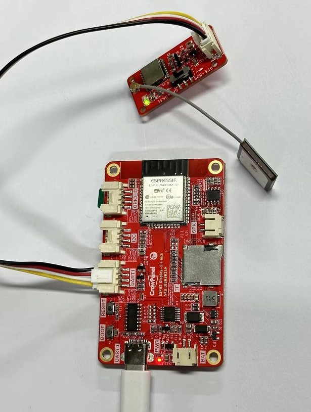

  5. After the program is successfully uploaded, connect the DHT20 sensor to the IIC port and the LED to GPIO_D (IO25), the temperature and humidity values will be displayed on the screen. Click the ON button on the screen and the LED will turn on. Click the OFF button and the LED will turn off.
ESP32-2.4-ARDUINO

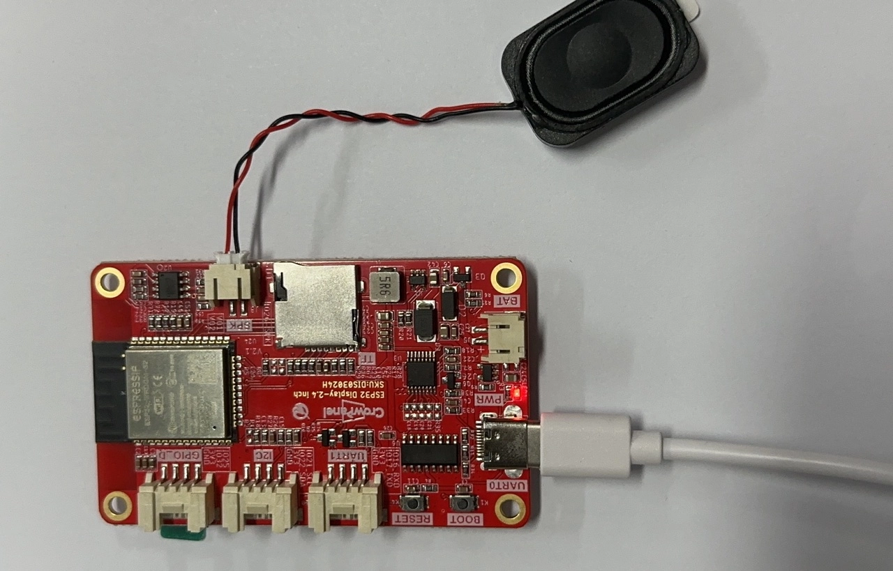

Example3: Speaker
Plug the speaker into SPK port.
3

Example8: Connect Crowtail-GPS module via UART to Get Location
Connect the GPS module to the UART interface. After running the program, you can view the returned GPS data in the serial monitor. It is best to be outdoors for better GPS signal reception.
5
GPS module purchase link:https://www.elecrow.com/crowtailgps-p-1515.html
